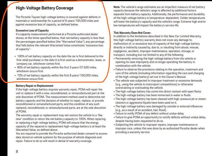

I have a Taycan 4s with battery plus. I have experienced decrease in actual range. I complained to the dealership and they perform what they called " short term measurement " and found the battery health is %79 which is below the warranty in less than 3 years. I told them , I am in title of changing the battery as per the warranty. Then they perform what they call " long term measurement " and found %87 . And they said no need go change the battery. Now my question what is the short & long term measurement and what the criteria for them?
In the warranty, they never mentioned this . What they are stating is if battery health go under %80 in less than 3 years , battery has to be replaced.

From US 2022 Taycan warranty book. (Porsche warranty in your country may be different.)
Porsche Taycan Battery Degradation 1715356834626-b1
https://www.porsche.com/usa/accessoriesandservices/porscheservice/vehicleinformation/warranty/
