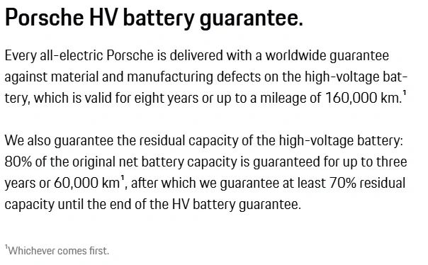

SoH is essentially an estimate of how much of the original baseline capacity remains usable. All VAG cars in the USA promise warranty replacement if usable capacity falls below 70% usable relative to the new baseline capacity. It's an industry standard to have a design objective of >= 80% usable by the end of service life.
