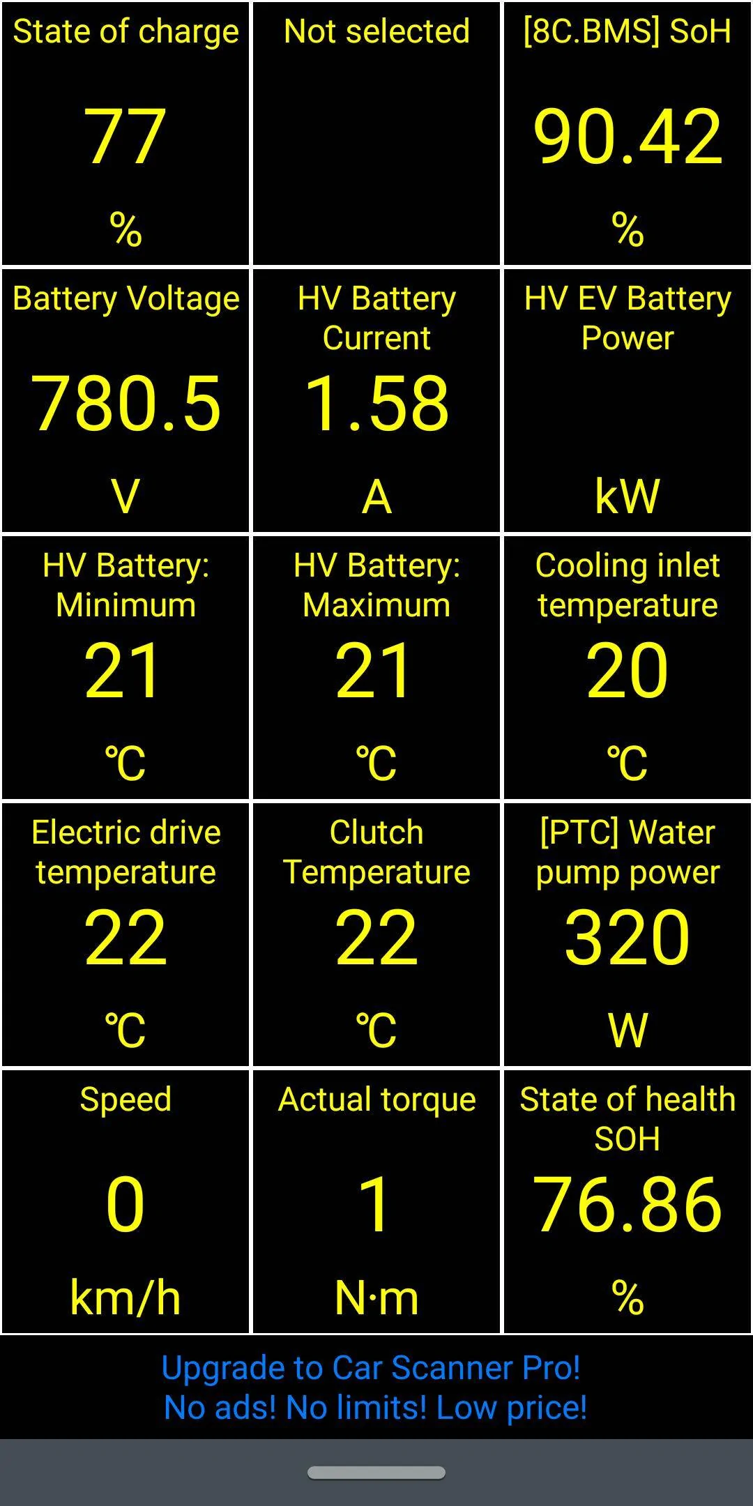

Do you know how "State of Health" is calculated? And what the difference between the two "SoH" values is?

Fair enough. FWIW - there were two different SoH values in the screenshot you posted - uppermost right and lowermost right.

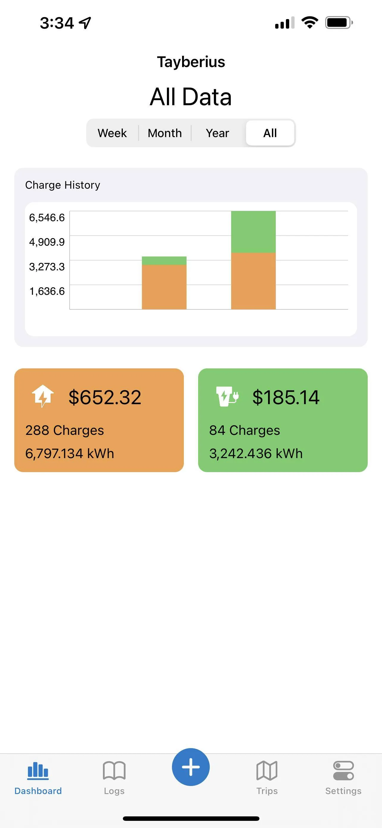

On the topic of battery degradation and DC fast charging, I'm wondering to what extent everyone here avoids DC fast charging to minimize battery degradation. I have a PMCC installed in the garage, but we also have an EA station with multiple 150kW stalls less than a mile from the house. Since we get 3 years of free 30 min. charges, I've gotten in the habit of using the EA station once or twice a week. In the time it takes me to walk to the Starbucks down the street and back, I've taken the car from 40% to 85% for free, but if this is coming at the expense of increased degradation to the battery I'll rely more on charging at home at night. FWIW - I have "battery friendly" fast charging enabled. How worried should I be about DC fast-charging if I'm only charging to 85%?
I'll let you know if I end up having actual degradation or not. I've done a fair amount of DC fast charging.
Porsche Taycan Battery Degradation IMG_0528

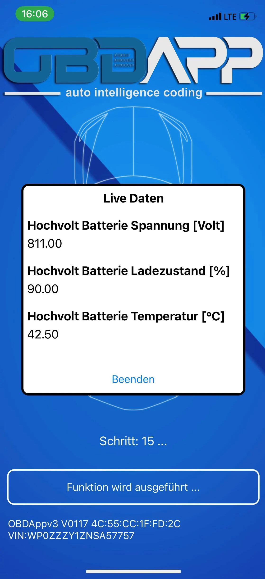

Is this an app you've created? Seems like you've promoted it in several threads now.
