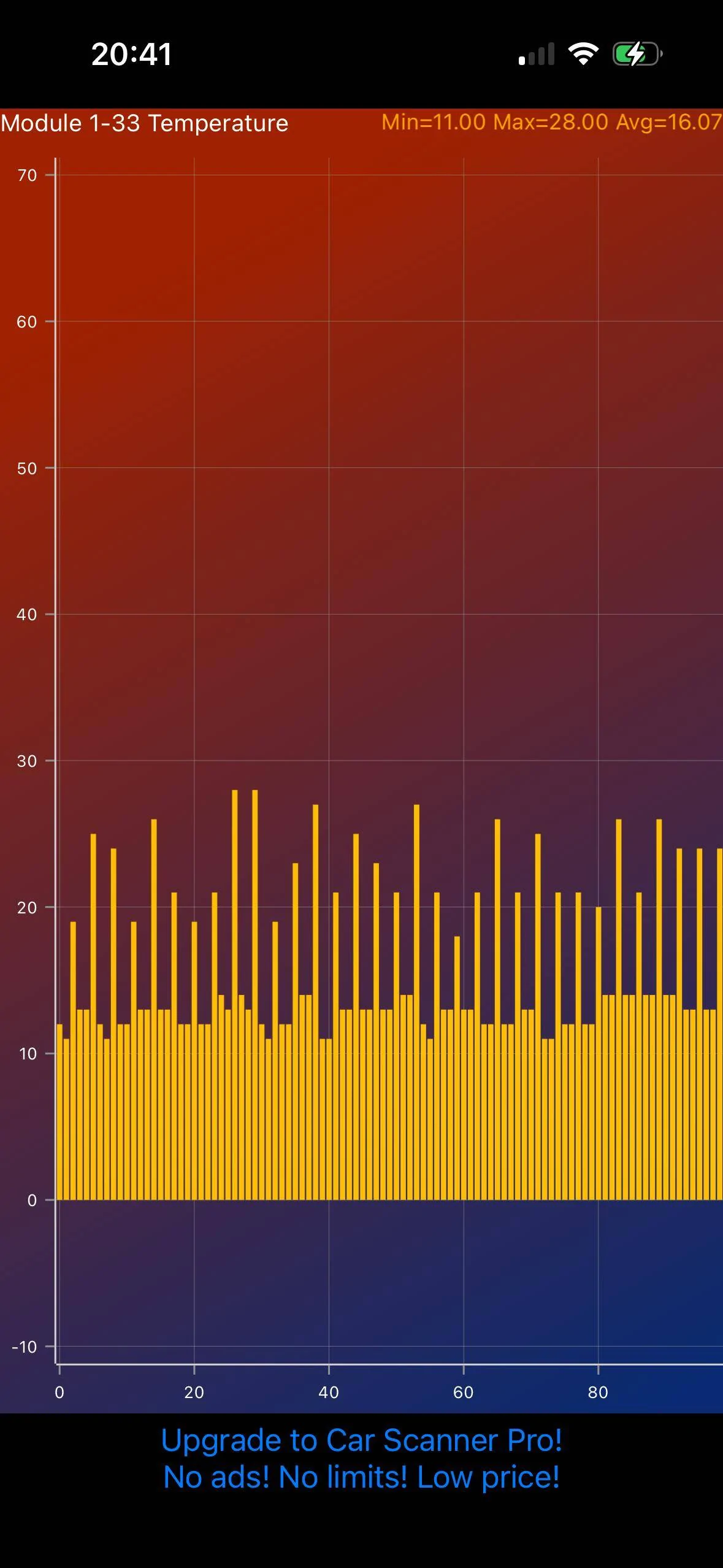

I noticed a steady degradation of my SoH even though I am taking good care of the battery. 86% after 37k km/2.5 years. Only AC charging and to 70-80 percent and I live in Norway. So cold climate. What I noticed from Car Scanner is that the temperature of every third battery module is significantly hotter than the others during charging. Anyone else see the same tendency? My theory is that no matter how well I treat the battery, it is the BMS/battery itself who is treating 1/3 of the battery pack badly. Which is degrading those cells and causing the decline of SoH. I read some comments that it is a knows issue that some of the battery pouches, the way they are stacked, means some are not in direct contact with the thermal plate which has the cooling. Not sure. Anyone have any similar observation?

First question - your profile says you're driving an Etron not a Taycan - correct? Just want to be sure we're comparing apples to apples (can't recall but am I to assume Etron's have an identical battery or is the chem different?).
But holy cow, yes your cell temps seem pretty wild albeit as you note very systematic. I have not seen this type of response at all to date - I've been tracking Soh in a separate thread for last 2+ years and many have shared cell maps but none that look like this.
May well be a BMS issue but the temp differentials seem very high to me - TBH, the only other folk with anything close to such dramatic cell temp-SoC variance usually ended up with battery replacements but not being much help here - perhaps punt a copy of this post to the Baseline Soh thread to tap into many forum experts there.
For ref you are plotting WAY off the other Cold climate cars and in fact that Soh puts your car in the Hot climate zone degradation trend (I'll add you to the graph after this post).
https://www.taycanforum.com/forum/t...ery-soh-performance.12815/page-42#post-286904

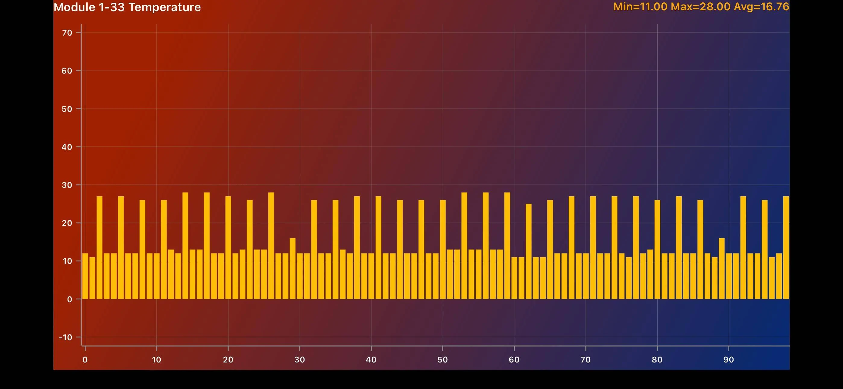

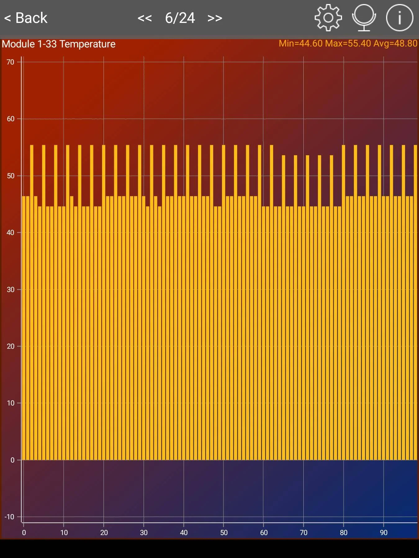

Totally normal. There are 3 temperature sensors in each battery module. That's why you see every third one much higher. Based on my observation I think the third one in each group is the one that's closest to the bottom of the module where the heat transfer takes place. This is my car while charging. (Farenheit temps)

I have not got a screenshot whilst charging, but I have observed the exact same behaviour in my 2020 Turbo
Porsche Taycan Uneven battery cell temperature when charging 1707380997737
The Screenshot above is when the car had done a short trip prior to charging at L2 charger. Outside temperature was below minus 5 C at the time. I wanted to see the battery temperature before plugging in.
I have looked at the temperature a number of times, but I have no screenshot of them. So this seems to be a common pattern.

I see I was a bit quick there, indeed there are 3 lines per module. Thanks for sharing! I checked after work today, and that 3rd sensor is instantly hotter than the rest, even straight after turning on the car. Perhaps that sensor is on a circuit board or close to a lead out of the battery module that gets hotter due to the current. In another viewer in Car Scanner there is a battery min and max temp reading. I noticed that the high sensor reading is not the same as the max temp reading, it’s much lower. Would be nice to know where the sensors are placed.
Oh well, then I guess the battery simply is not strong enough to handle the high loads of the Turbo / RS Etron.
