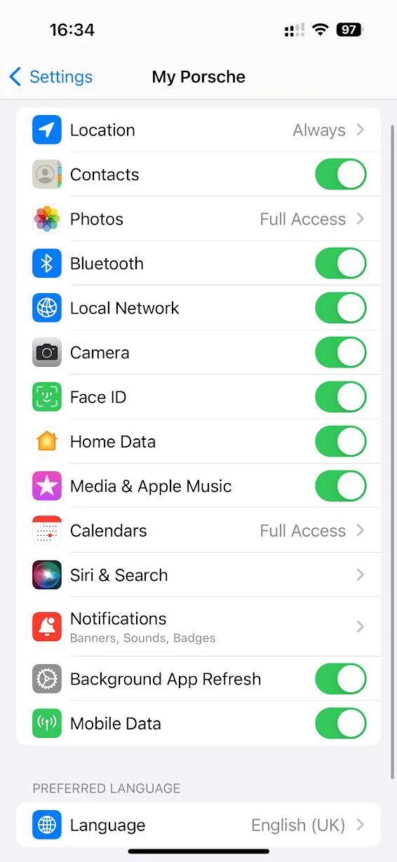

Have/Could you check the bluetooth authorization and other settings are comparable with the iPhone"s the remote parking was working on?

I tried above using another spare phone that had been factory reset; it was older and not running 17.4, but still did not work. Interesting side note for anyone interested, I tried to use an iPad but the app only offers the lock/heating/horn option - not the remote park when running on this device.
Interestingly when playing around last night, I noticed the Taycan does try to do something. It made noises as if it was waking up and some of the dash elements lit up - and then nothing happens. So I feel like its communicating, but something fails during the process.
On the Cayenne, nothing lights up - but I do here something click on the car somewhere.
This would lend me to believe that the bluetooth communication itself isn't the fault.
I did try using the Xcode console to see if anything was obvious - but other than scanning for devices and finding the car etc - couldn't really determine much. There was an error, unexpected response 23 - but the payloads aren't visible so couldn't really determine much.
The Taycan firmware has been updated to latest; but the Cayenne hasn't changed - but the phone has updated to 17.4 and the latest My Porsche App and I believe the culprit lies there - but, this is software, so this could all be a red herring.
I might tap a friend with someone with a phone from Sam & Son to see if any better luck with Android.
I don't know if its relevant, I'm on Verizon - what are others on that are seeing the failure vs the owner that has the app working (I am tempted to do a network reset to see if that does anything; but I don't believe this impacts bluetooth).
