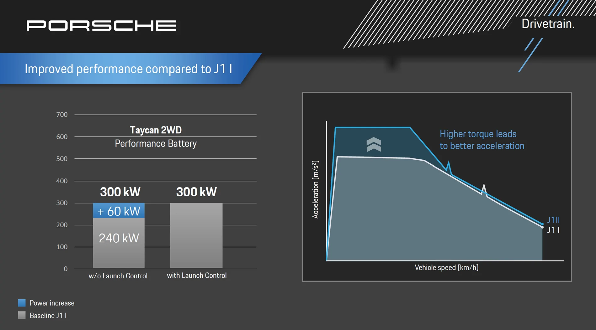

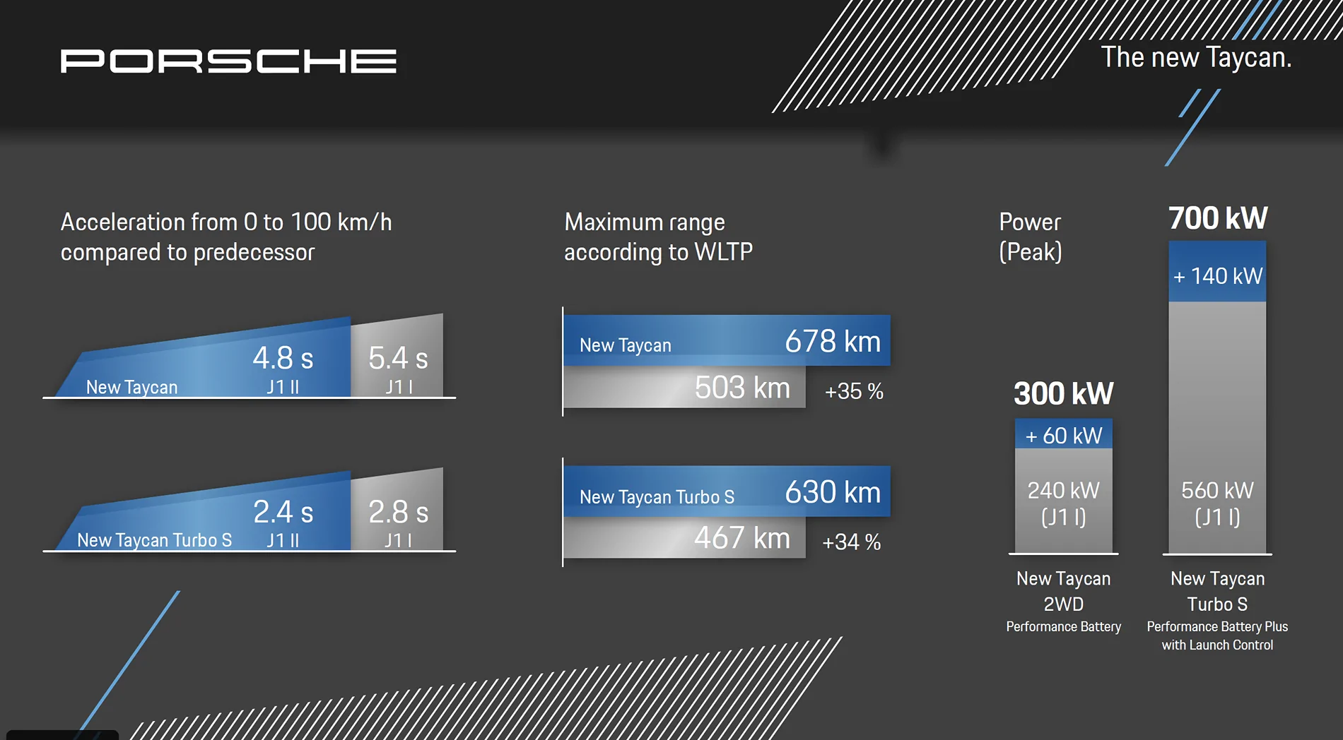

2025+ (J1.2) is a much improved car overall but in a RWD form it has less performance if that makes any sense.
It does not, the 0-100km/h is the same and the lower speed performance is better.
It has significantly higher torque output. The J1.1 PB+ in launch control has the theoretical max power at 120 km/h, and then after the shift the power output drops again.
The facelift has a better area "under the curve". And then if the performance is not enough with our upgrade it's mental.

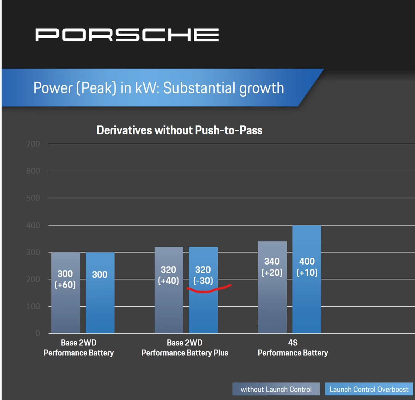

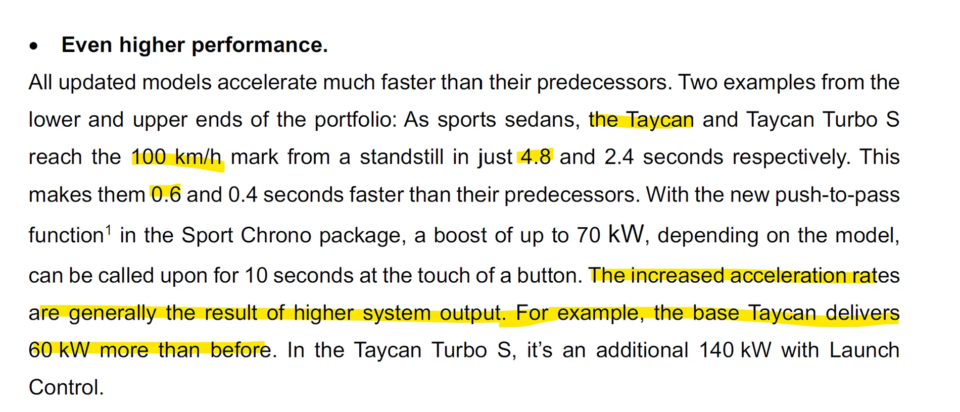

@prj
2024 for example has an Air Quality system replacing the Ionzier with a view of air quality management, that even my 2023 does not have, so that is the kind of incremental stuff that I am referring to.
2025 Base performance reference was made by me due to -30 kW in PB+ with LC, but otherwise, it is better in other areas per this press kit info, which shows that 0 to 100 km/h is actually faster.
Yes it is, that's why I am saying the theoretical kW is irrelevant because on the pre-facelift it's in a very narrow range, and the facelift actually has a much better area under the curve, and is faster.
