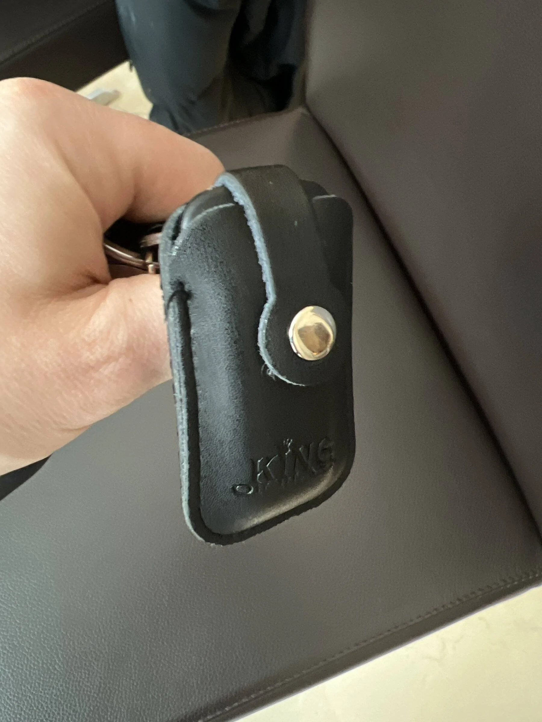

More importantly, anyone found a good solution for carrying the alarm fob? I've been trying to find a little pouch to attach to my house keys, but all of the things on amazon that look like they'd do the trick turn out to be enormous. Not sure how long the fob will survive just rattling around in my trouser pocket.
https://www.amazon.co.uk/Flash-Port...usb+flash+drive+portable+travel,aps,71&sr=8-2
Had the same problem. This one doesn’t look amazing, but fits perfectly.

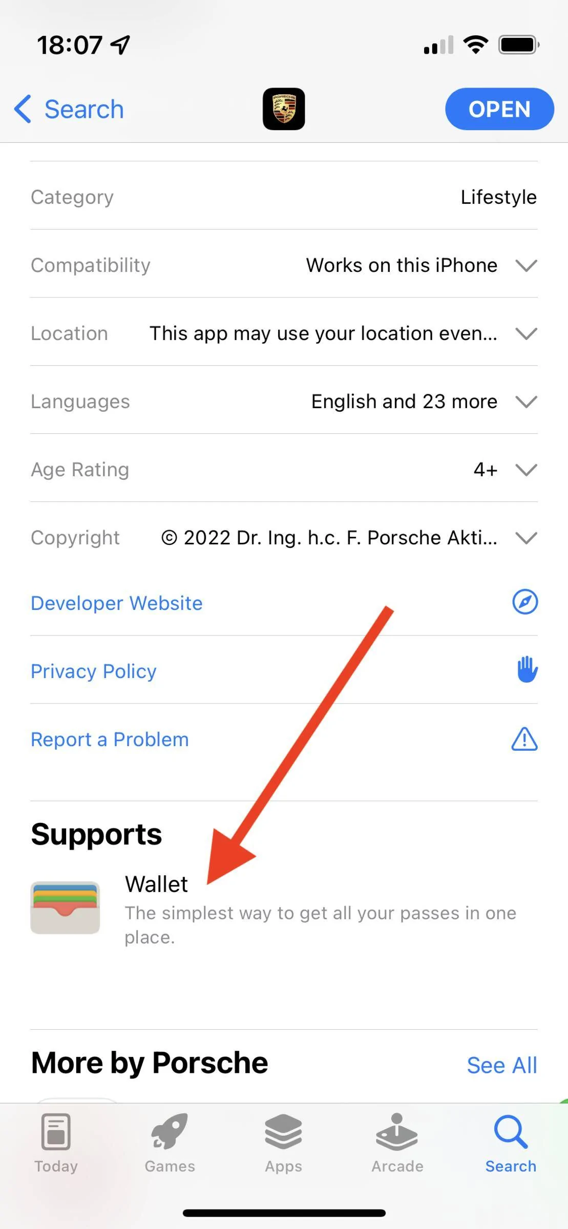

The latest version "My Porsche" for iOS app is marked as supporting Wallet – the consumer interface into the PassKit set of APIs and technologies.
That's not there for no reason – but I dug through the latest binary looking for any strings relating to Car Key or PassKit and could find nothing. Apple are usually fussy about things like this – they wouldn't mark the app as using "passes" if it wasn't for some (eventual) purpose.
The CarKey supporting BMW app has the same "Supports Wallet" marking on its app store entry.

The latest version of iSO My Porsche app is marked as supporting Wallet – the consumer interface into the PassKit set of APIs and technologies.
We should watch this space.
