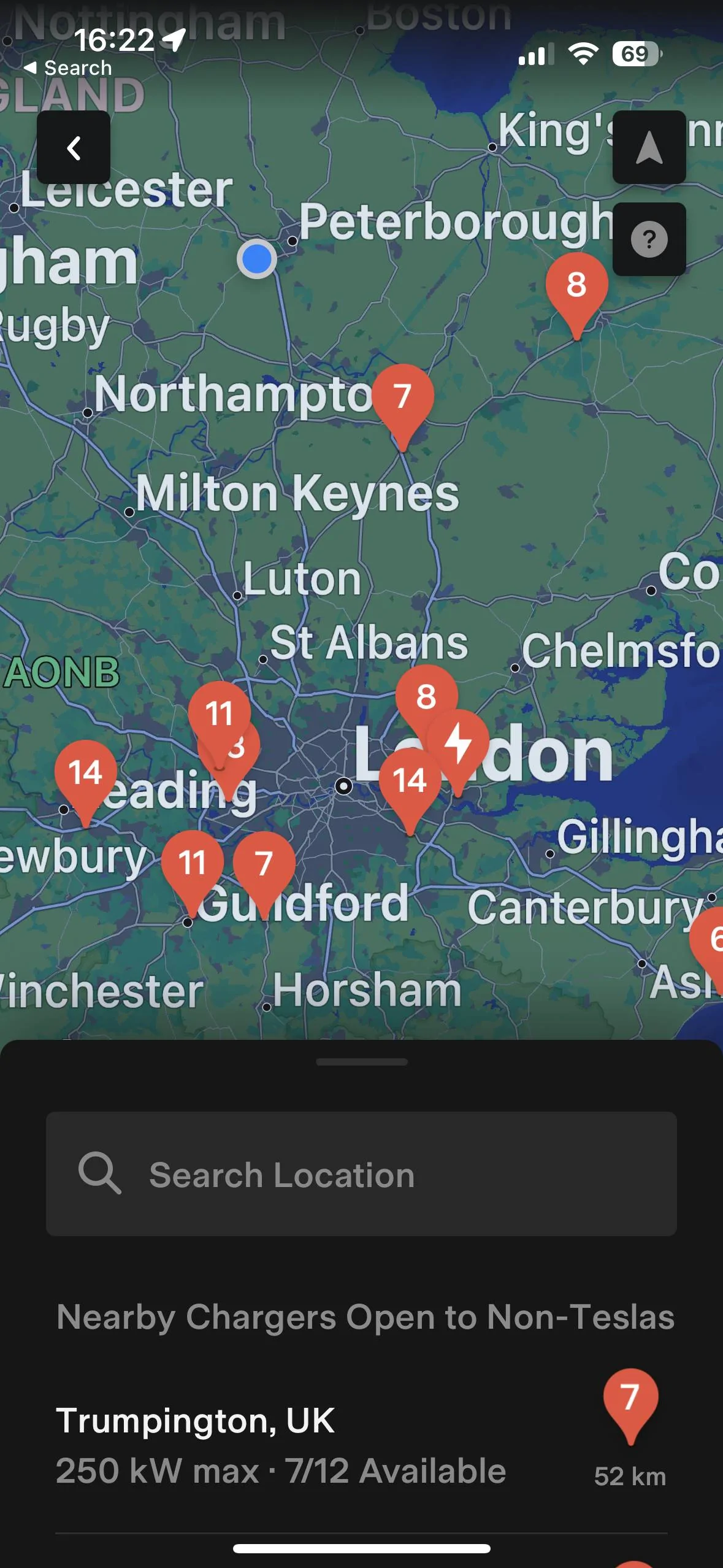

Hi, Ive yet to use the Tesla chargers but I do have the app, registered and loaded a credit card. Once in, you can get a map view to show the 'open chargers'.
Porsche Taycan using tesla supercharging stations IMG_1D516BC268B5-1

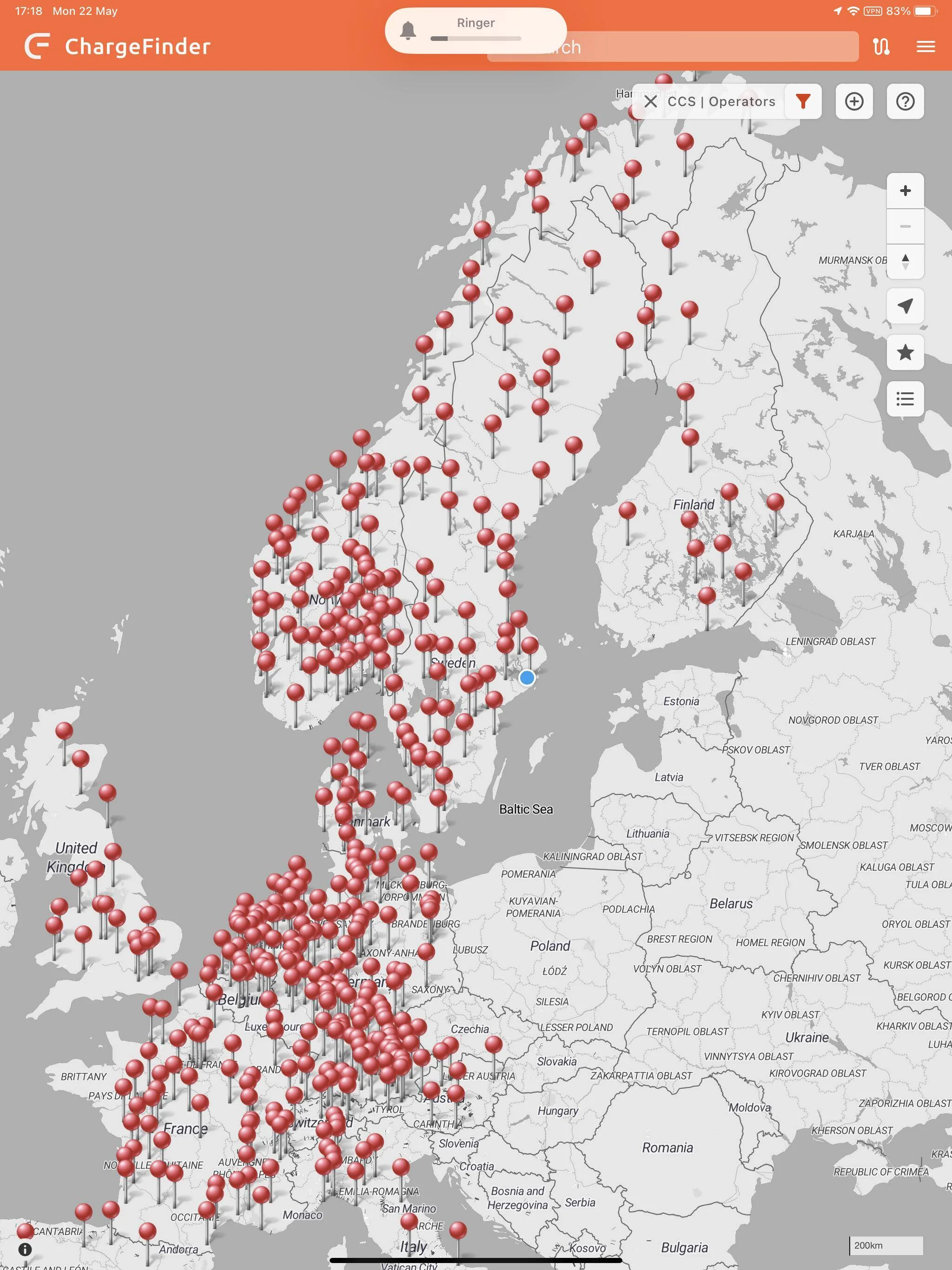

I think Tesla do a great job here in Europe. The following is a map showing the SuC that are open for all. There are of course some that still not have been opened to all. So you can compare that picture with the lousy Ionity roll out that is owned by several EV manufacturers!
Porsche Taycan using tesla supercharging stations IMG_1534
Plus Ionity have something like 4 to 8 chargers per station , while Tesla show up with 16 to 40!! I can drive from the Spanish French border up to Nordkap on only Tesla open for all chargers. NO WAY with Ionity is that possible.
