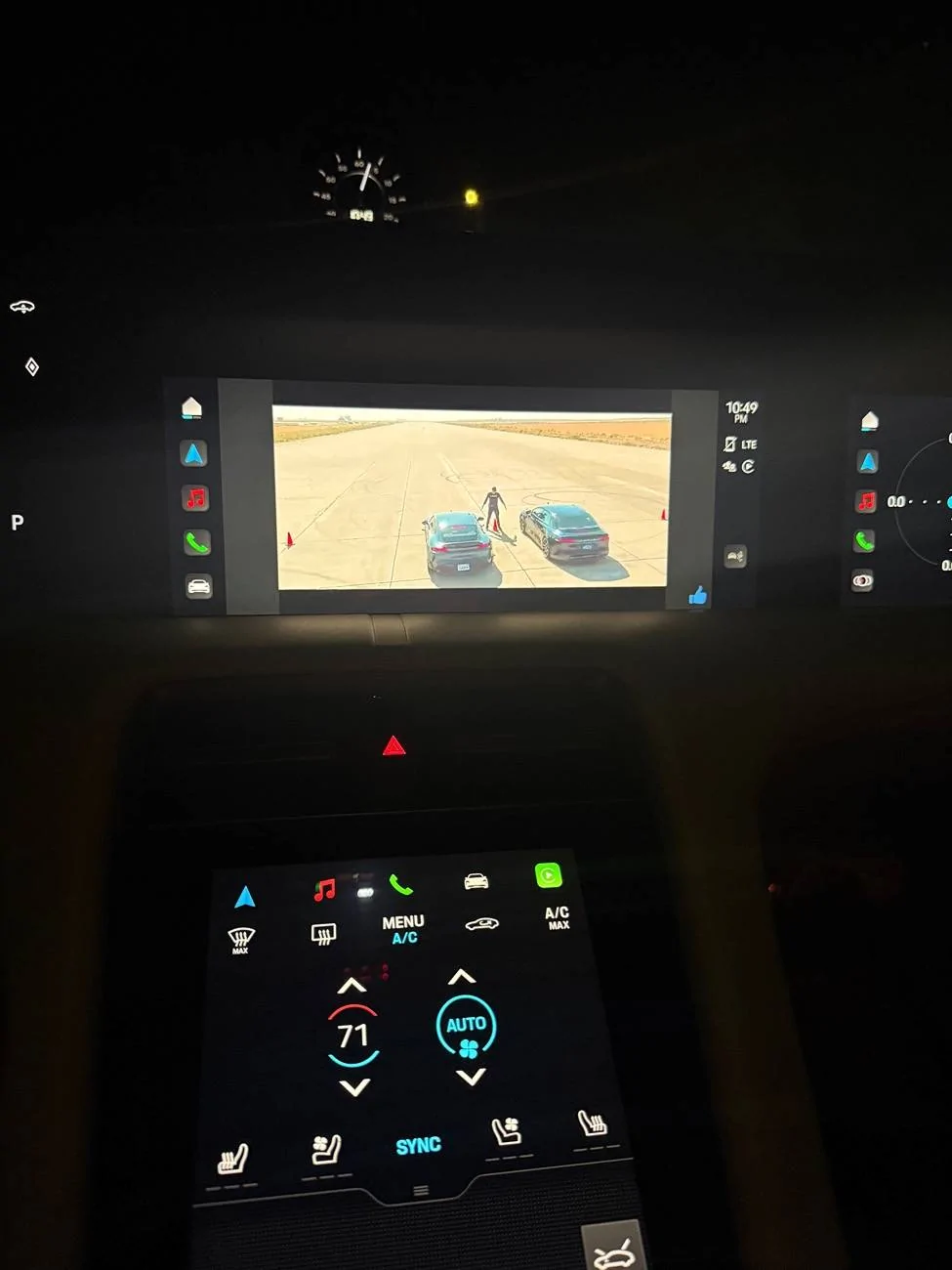

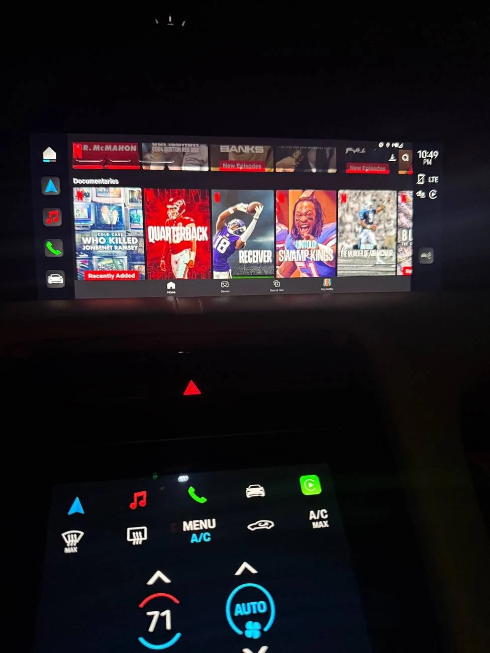

I have the one Castro AI box ultra and it works great for video. I have to use my phone as a hotspot for internet access. I bought a prepaid SIM card with data and I never got the device to read it so I just use my phone. It basically uses your Apple car play function(when you press the green apply CarPlay button it pops up) it is really plug and play. I haven’t really used it for music just sitting and watching Netflix and you tube. It works while driving(not that anyone should do that)
Porsche Taycan Watch Netflix or Youtube on your Taycan while Charging IMG_1193
Porsche Taycan Watch Netflix or Youtube on your Taycan while Charging IMG_1194

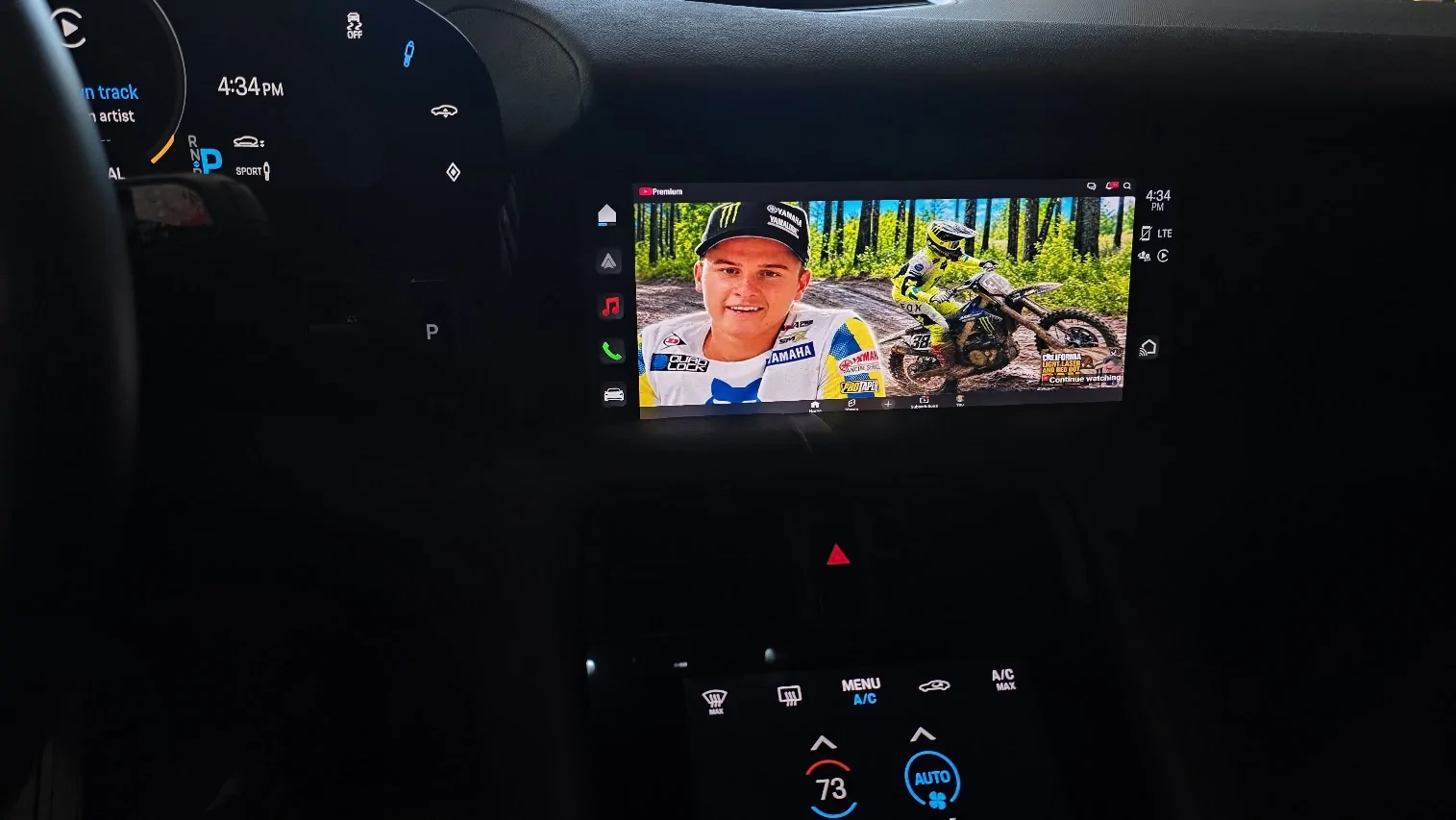

I can confirm that my wired Ottocast does work!
Porsche Taycan Watch Netflix or Youtube on your Taycan while Charging otto
