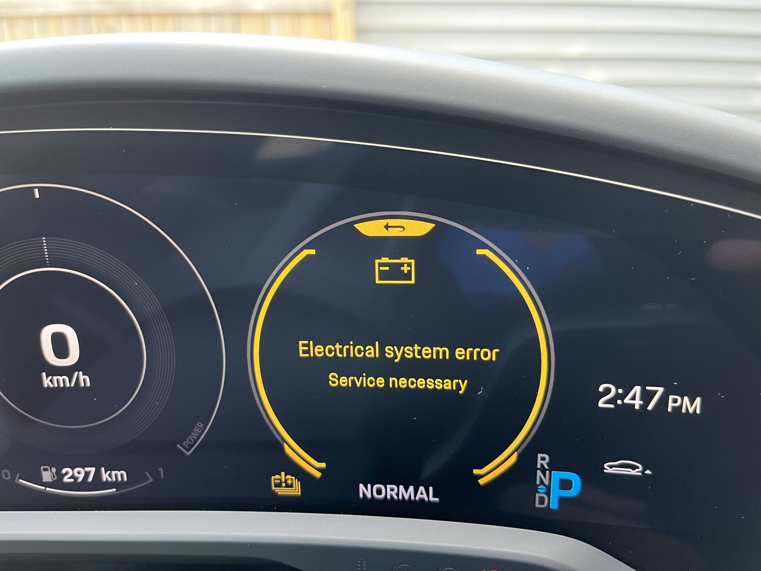

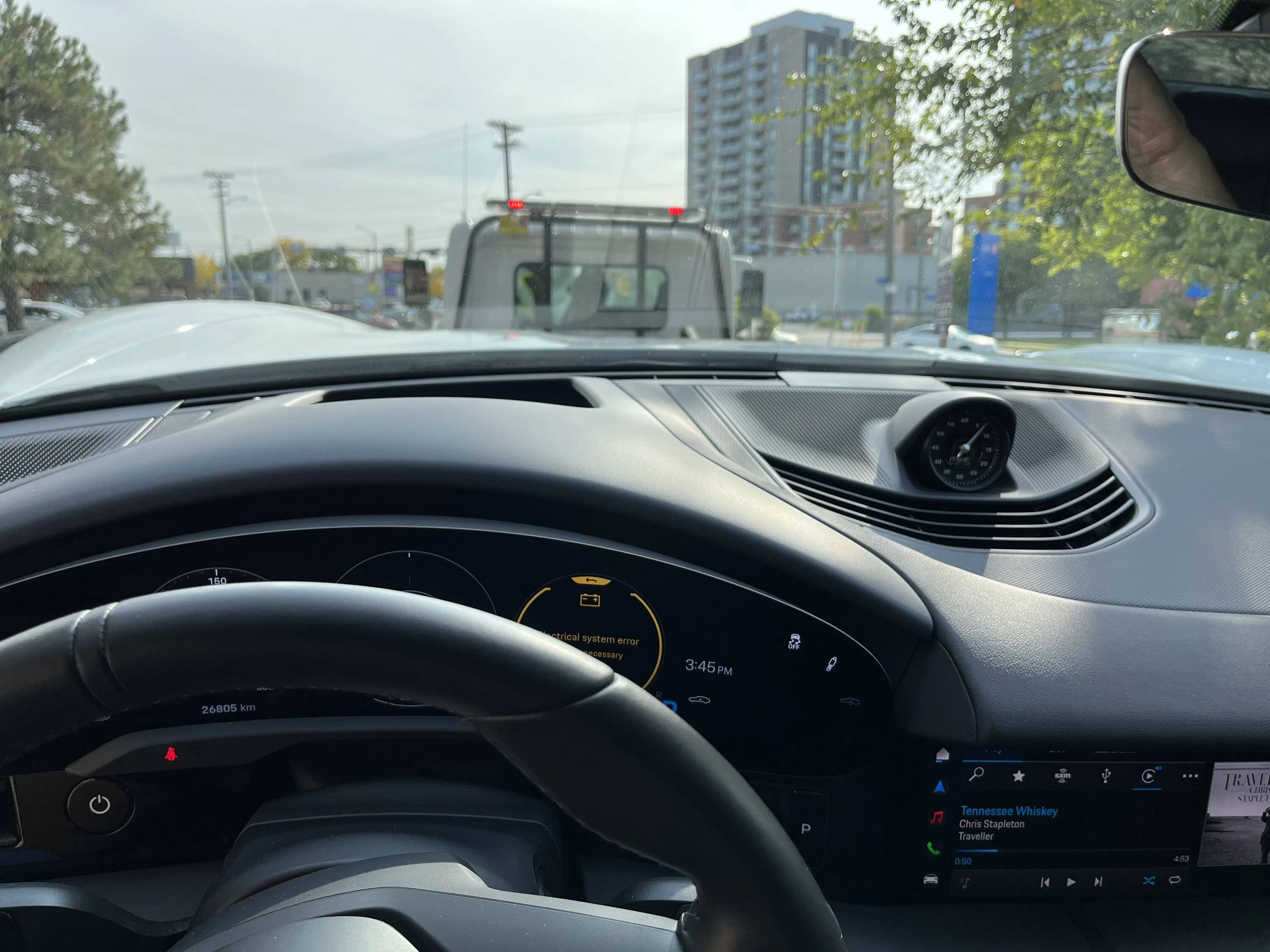

My story goes as follows:
Drove to work in the morning at 45% charge and plugged it in to charge (level 2, 50A). I got in after work expecting it to be at 80%, only to see it had stopped at 73%. Weird. I disconnected the charger and tried to start it - and got the yellow “electrical system error” “service necessary “. I could only shift into neutral. All other electrical systems seemed operational. I checked the electrical panel and the breaker had been tripped. I reset the breaker, left the car locked for 20 minutes, and tried to restart. No dice.
Called Porsche roadside assistance who sent a tow truck - said it would take 90 minutes. After 45, the flatbed arrived, and I helped load the car onto the flatbed. It was sent to the dealership. I ubered home. A tech immediately looked at it. 3 days went by with no update.
today I called for an update - a prms ticked was apparently requested by the dealership.
incidentally, I have had to have the car towed before for another electrical issue. Bricked. On-board charger was replaced. Took 3 weeks.
I have a base Macan loaner, which I am grateful for, but unexcited by.
