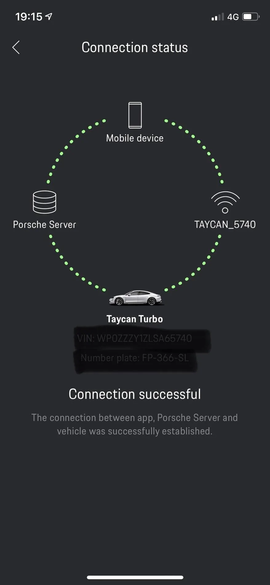

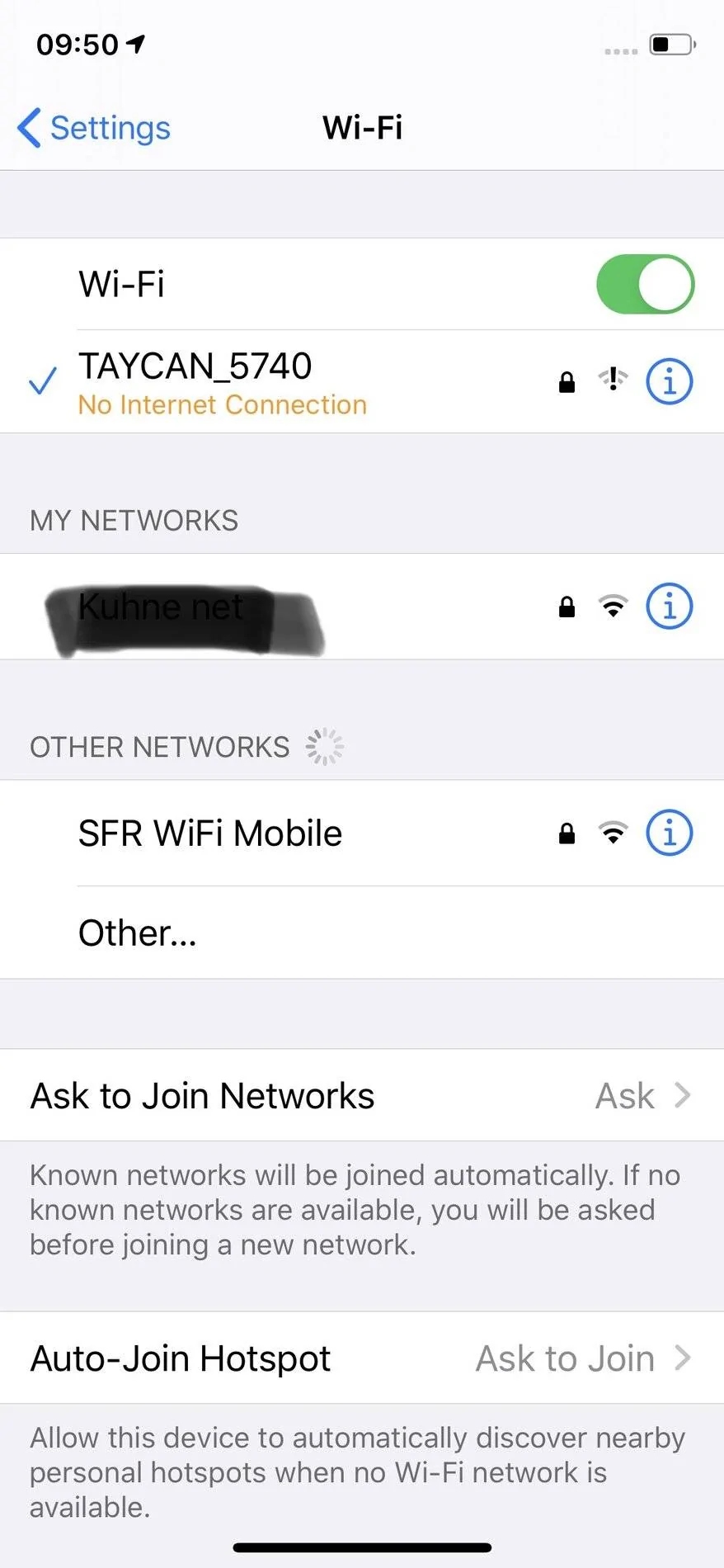

I have some new update on this working at least here in France. I have an iPhone X and it works sometimes and fails a few times.
I have now changed my WiFi in the car. I have allowed it to be a Hotspot but NOT have Internet Access. This way my phone connects to the internet via 4G and also to the hotspot. Now my calendar syncs with the car and I can easily navigate to any entry that has the address in the entry. Just the way I wanted this to be. Now my phone also connects to the Porsche Servers via 4G as well as to the Taycan via WiFi, and all the connections are green, see picture below.
Porsche Taycan What is the PCM HotSpot for anyway? 58F91256-3572-45F9-9D5C-F082165789B5
Now I can use AppleCarplay for navigation etc if I want while still having all the calendar sync available.
And please remember I do not have the internet package for the hotspot.
AppleCarplay needs to be connected to the car via the USB connection, but my hope and guess is that this WiFi connection will be used in a future upgrade of the PCM? I may be dreaming but hey ho!
This is the way it looks on the phone when it is connected to the Hotspot as well as the 4G network

Go into the WiFi settings and make sure the Internet Access is NOT ticked and try to see if that helps! That is the way I got it working. I guess the Hotspot does not do any router function at that stage.
Nice! That is the first time I have seen a complete "green circle"!
Still not working for us here in the States though... At least not for me!

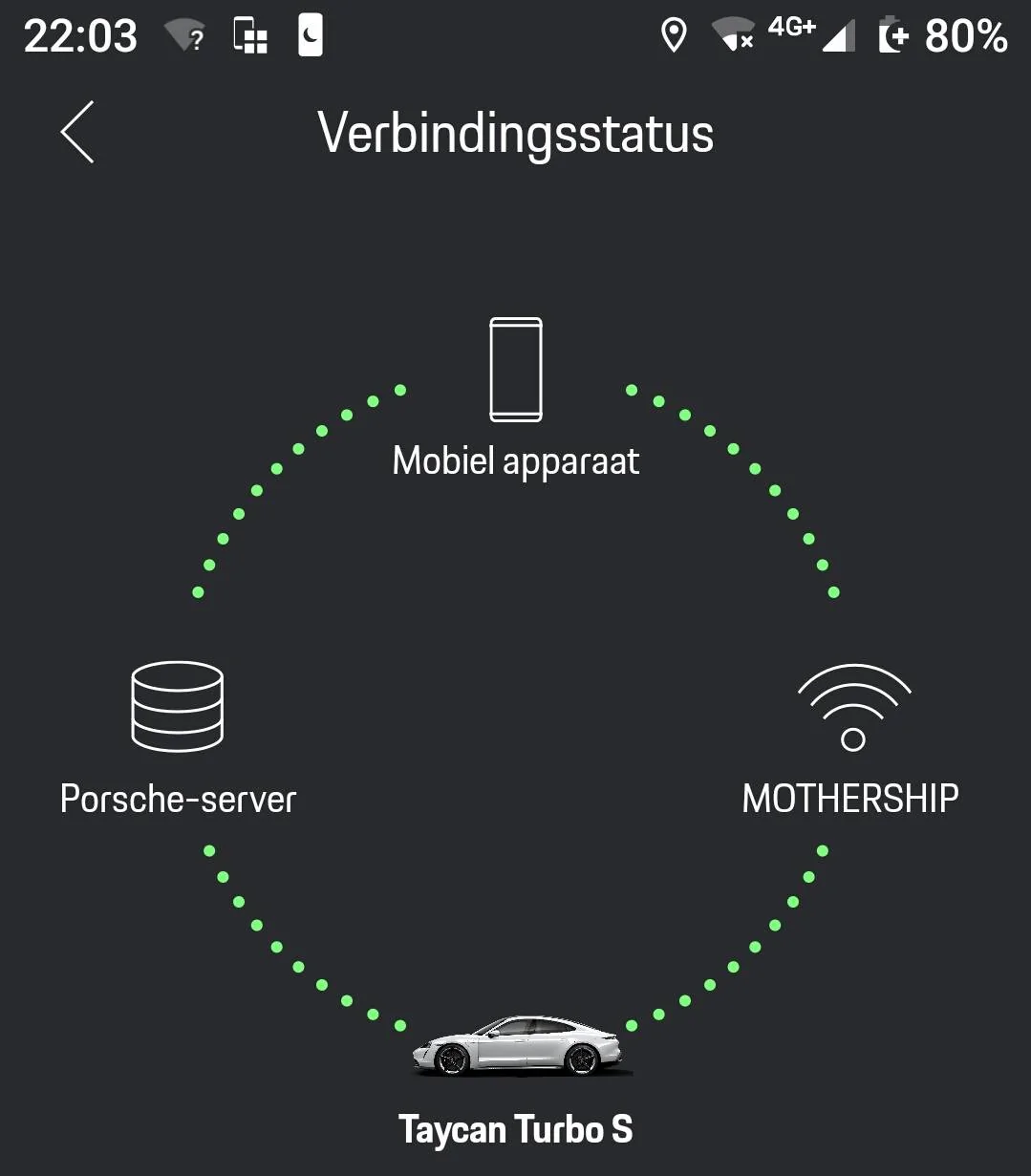

It should look like this.
4G still available.
Porsche Taycan What is the PCM HotSpot for anyway? 2020-08-31_20.21.54
Note the semi WiFi status, data transfer only.
