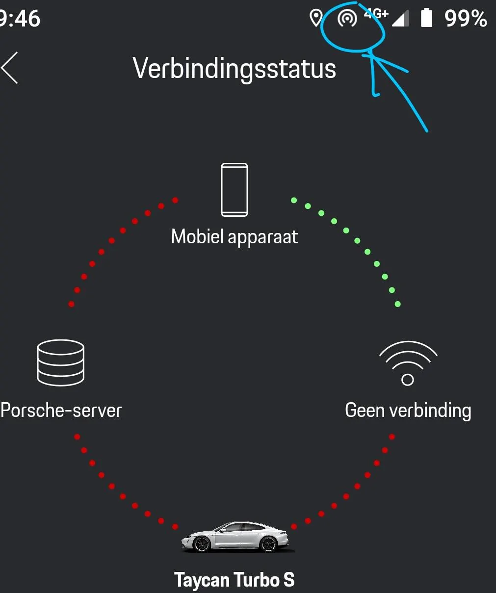

You can't connect to a home WiFi, it's the WiFi spot of the car.
It says "geen verbinding" which means "no connection" but in reality it's sleeping and doesn't show the name of the hotspot (which is "mothership" btw).
Still, there is a connection.
Ah, how did I miss the "Keine Verbindung"! Funny, green lines around the WiFi symbol but reports no connection.
As far as I understand, the WiFi shown on the phone is the WiFi the phone is connected, not the WiFi hotspot in the car, unless you are at the car and have your phone connected to the car WiFi hotspot. Correct?

I'm still referring to this pic (solid green line) as I can read out the car and send profiles to it although the car doesn't have connection with the Porsche server, like I said earlier.
Porsche Taycan What is the PCM HotSpot for anyway? 2020-08-31_19.48.23
It works.
It works.
According to your diagram, it looks like your phone only has a connection to the HotSpot and not the PCM (car)
I certainly can't send profiles (or anything else - like nav locations) to the PCM if I am connected to the HotSpot). In fact, I can't do ANYTHING when connected to the HotSpot. Its simply a dead end...
