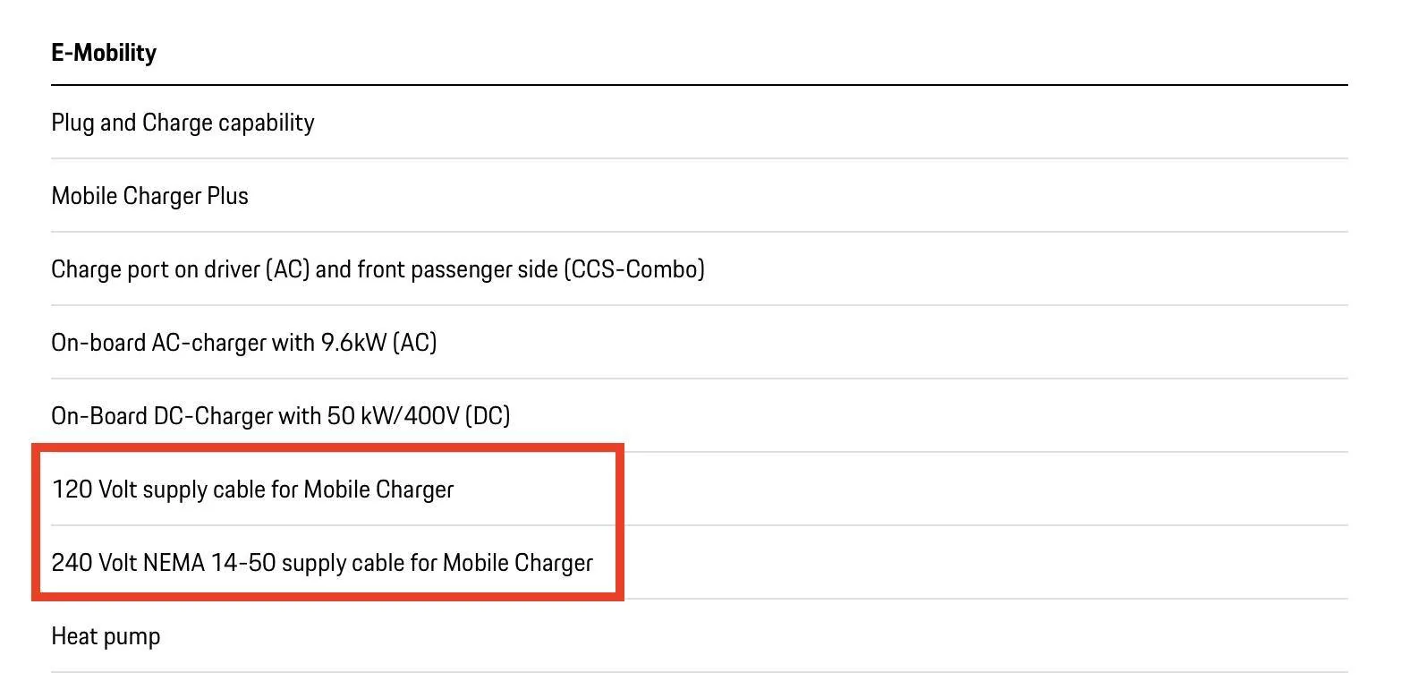

as long as you order the NEMA 14-50 supply cable with your vehicle/pmc+ that will be no problem - and everything will "just work" - NEMA 14-50 is the default choice for PMC+/PMCC in North America if you do not specify otherwise - check with your dealer/order to confirm you are receiving a NEMA 14-50 supply cable with your PMC+ - see picture below from Porsche Taycan website - "standard equipment"
Porsche Taycan What level are you?  Post your garage charging plans or what you've done Screen Shot 2021-09-29 at 7.57.50 AM
Taycan Standard Equipment PDF Attached - NOTE: NEMA 14-50 supply cable is listed in the "eMobility" section…

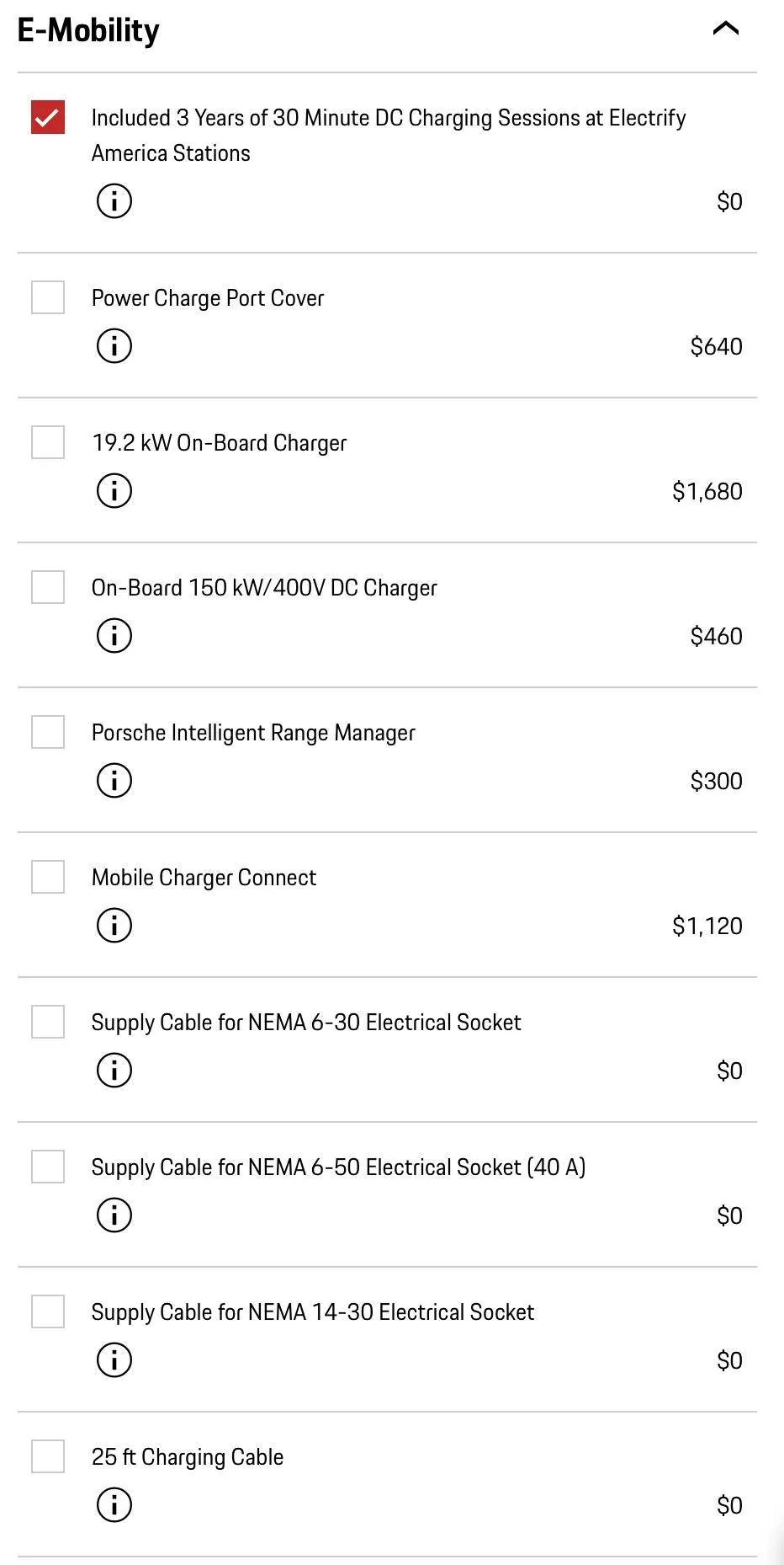

the following alternate PMC+/PMCC supply cables are available for $0 at order lock time w/Dealer -
note these are most expensive when ordered later via VW/Audi/Porsche parts - they are in fact so expensive that I recommend just buying a whole alternate EV charger (EVSE) - these parts and chargers are shared across the VW/Audi/Porsche products and are in fact nearly identical (eTron owners receive something very very very similar to the PMC+ with an Audi Logo - but they can share supply cables with the PMC+/PMCC).
  • NEMA 6-30
  • NEMA 14-30
  • NEMA 6-50
NEMA 6-30 & 14-30 are 30 amp plugs for North America and will result in a raw charge rate of 5.76 kW (vs. 9.6 kW for 6-50/14-50 - i.e. slower charging than 14-50/6-50) - usage of these plugs requires a 30 amp breaker dedicated circuit installed by your electrician -the two plugs are functionally identical for EV charging it purely a matter of preference or pre-existing condition/install as to which one to choose.
Why use 30 amp plug?
  • Cost may be cheaper.
  • It may be all your home/electrical-panel can handle with out major upgrades
  • pre-existing unused plug in the garage so this approach could be low cost and low effort.
NEMA 6-50 is functionally identical to NEMA 14-50 for EV charging (both yield 9.6 kW raw charge rate) - NEMA 14-50 plugs have a 4th connector for the electrical neutral which is used by RV's for their power hook ups - the Neutral is unused by North American EVSE's (PMC+/PMCC/others) - so the choice between plugs is purely personal or pre-exisitng condition/install. NEMA 14-50 is the preferred supply cable because you are more likely to encounter a 14-50 while away from home - for purely home use 6-50 or 14-50 makes _NO_ difference - adapters to convert 6-50 to 14-50 or 14-50 to 6-50 are safe, effective and simple and easily ordered from Amazon for less than $50 - so if you have a 6-50/14-50 and the additional converter from Amazon your PMC+/PMCC could easily be compatible with either a 6-50 or 14-50 plug at home or while traveling.

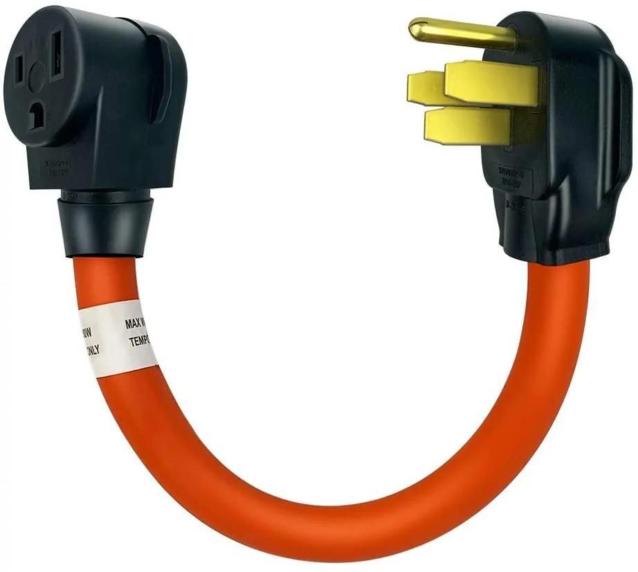

if you plan to travel with your Taycan and want to be able to use both a NEMA 14-50 plug or NEMA 6-50 plug - here are example adapters from Amazon that are safe, effective, simple and cheap…for purely home use these adapters are UNECESSARY - the only reason to carry one of these is if you want to increase your charging options for when you are away from home
Scenario: You own a PMC+/PMCC w/NEMA 14-50 Supply Cable
You arrive at a hotel with a NEMA 14-50 plug accessible in the parking lot
Adapter Required: NONE - you already own/use a NEMA 14-50 supply cable.
You arrive at a hotel with a NEMA 6-50 plug accessible in the parking lot
Adapter Required: NEMA 6-50P to NEMA 14-50R - $42 from amazon
https://www.amazon.com/Adapter-Weld...s=6-50+to+14-50+adapter&qid=1632928583&sr=8-5
It is safe? YEs because NEMA 6-50 and 14-50 are both 50 amp plugs - this is a safe and simple adapter requiring no changes to the charge rate of the PMC+/PMCC. In the picture below the NEMA 6-50 "end" is the one with the exposed 3 prongs - the NEMA 14-50R "female" end is where you'll plug in your PMC+/PMCC

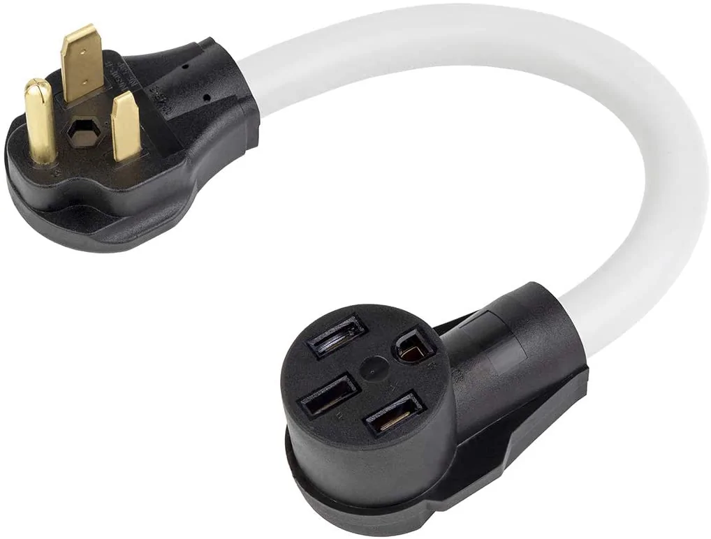

Scenario: You own a PMC+/PMCC with NEMA 6-50 supply cable
Adapter Required: NEMA 14-50P to NEMA 6-50R - $23.89 from Amazon
https://www.amazon.com/Welder-Adapt...s=6-50+to+14-50+adapter&qid=1632928583&sr=8-8
It is safe? YEs because NEMA 6-50 and 14-50 are both 50 amp plugs - this is a safe and simple adapter requiring no changes to the charge rate of the PMC+/PMCC. In the picture below the NEMA 6-50 "end" is the female "end" - the NEMA 14-50P "male" end is where you'll plug into the hotel parking lot plug - your PMC+/PMCC w/6-50 supply cable will plug into the NEMA 6-50R female "end".

Summary: NEMA 14-50 is standard/default and a great choice. However if you get a NEMA 6-50 plug/supply cable don't sweat it - an adatper/converter from 6-50 to 14-50 is easy, safe, and not a lot of money - and having one anyways is useful so that you can use either plug type while away from home.
NEMA 6-50 for home install "might" be the preferred option because it's a 3 wire install rather than a 4 wire install - depending on length/complexity of the install this may save some money since the electrician will not have to pull an additional 4th high amp capacity wire (copper is wicked expensive right now) for the unused 4th connector electrical neutral connection.
NEMA 14-50 is the default "best" choice in North America because it's the most common 240V/50 amp plug you are likely to run into the wild, but that only matters if you plan to use a PMC+/PMCC when away from home - for home use there is no real advantage or disadvantage to either plug type because your PMC+/PMCC will match what ever you tell your electrician to install.
As demonstrated above however a safe, effective, simple converter between 6-50/14-50 is less than $50 from Amazon so if you get the "wrong" plug or supply cable - there is a simple solution - and the solution is as useful as part of your "road warrior" EV I want to charge anywhere kit…
