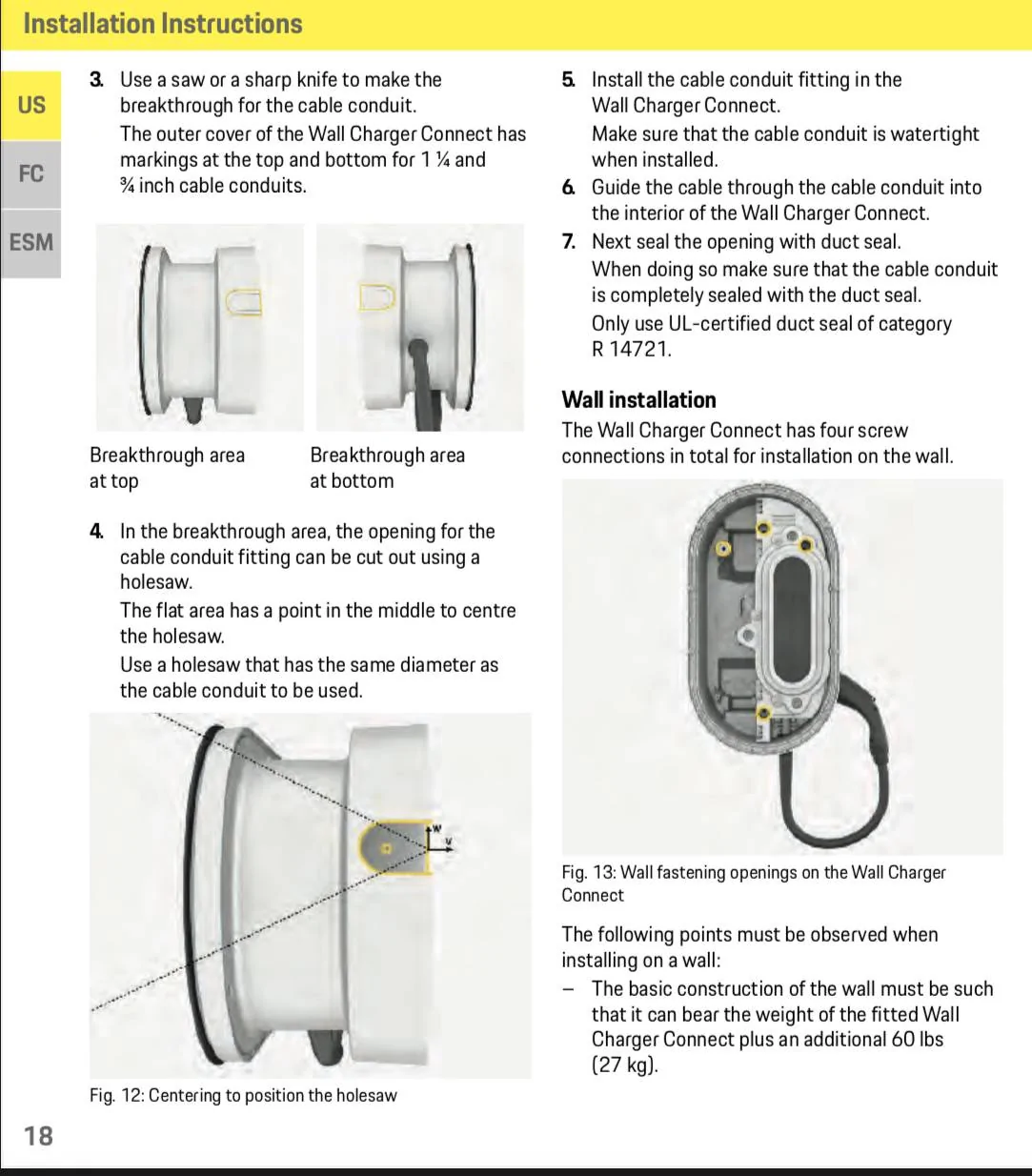

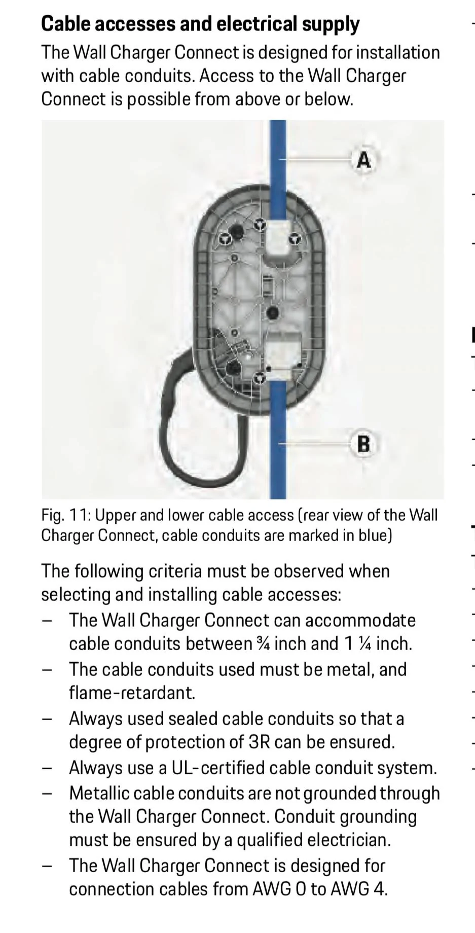

Promise I will follow up with real pics when I get to it, but in the meantime, here are the closest illustrations from the manual. Seems like the supply is fed in either from top or bottom of the case, and then connected internally to the main unit.
How did the install go? Can you share final pictures?

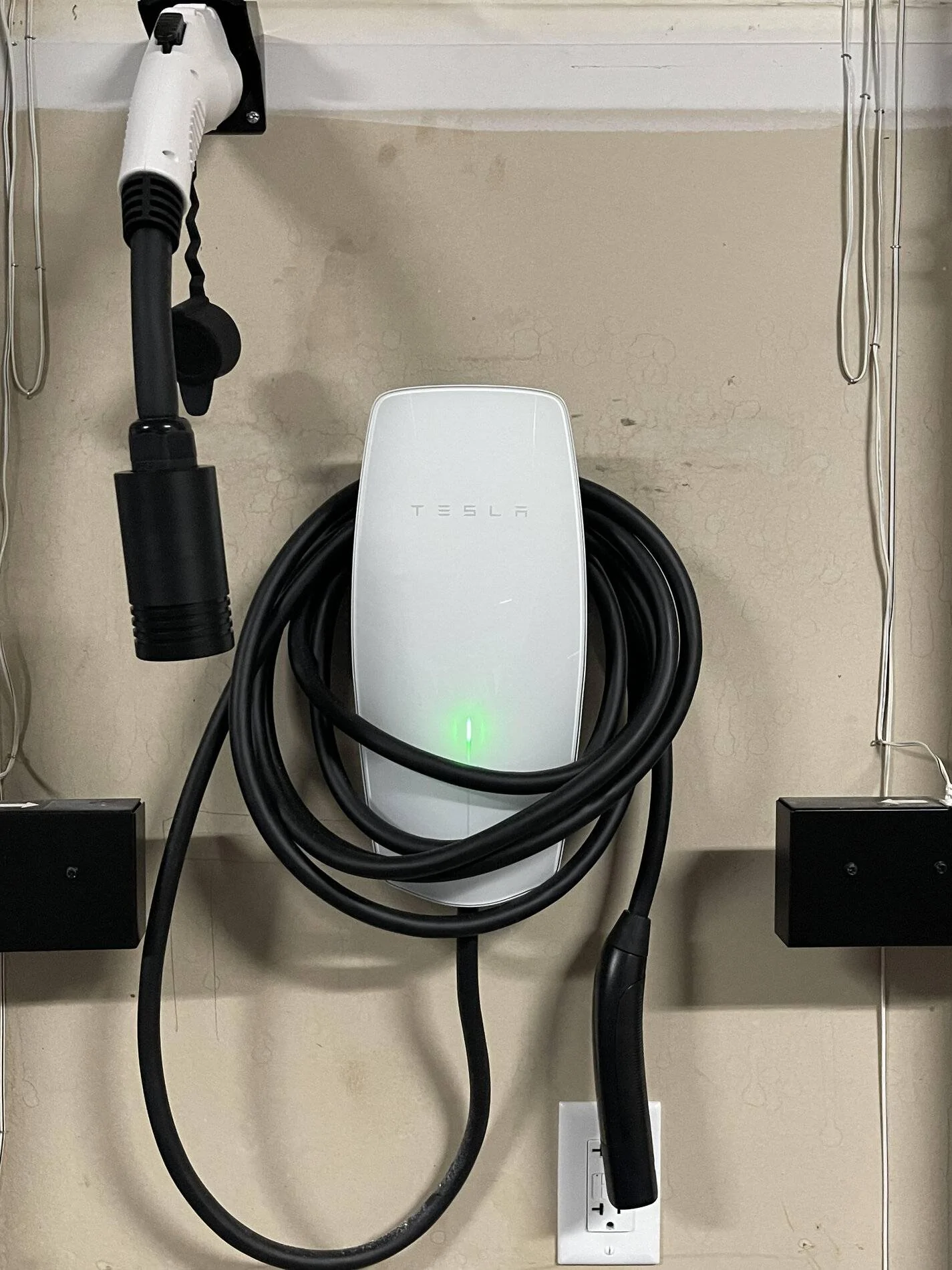

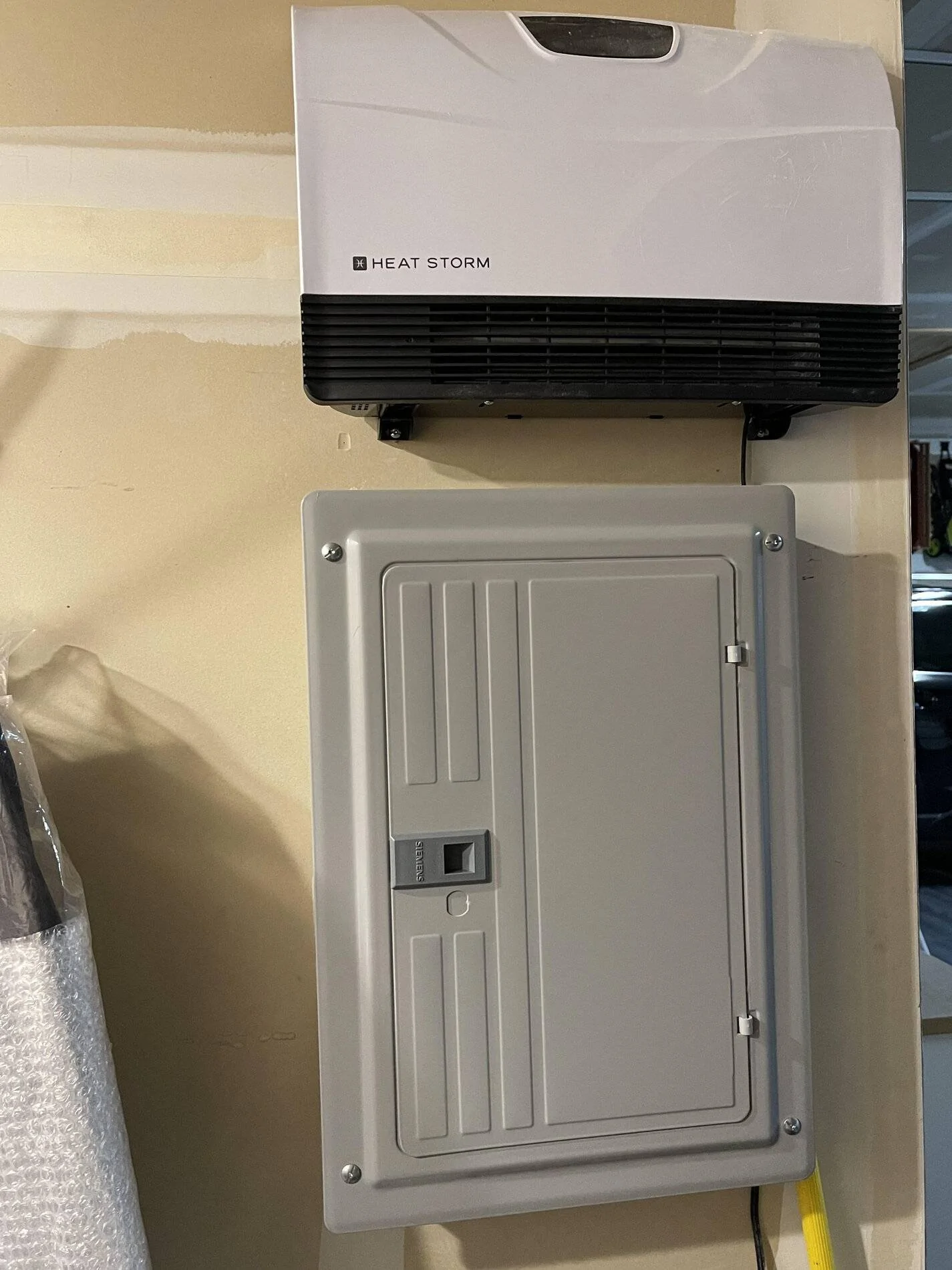

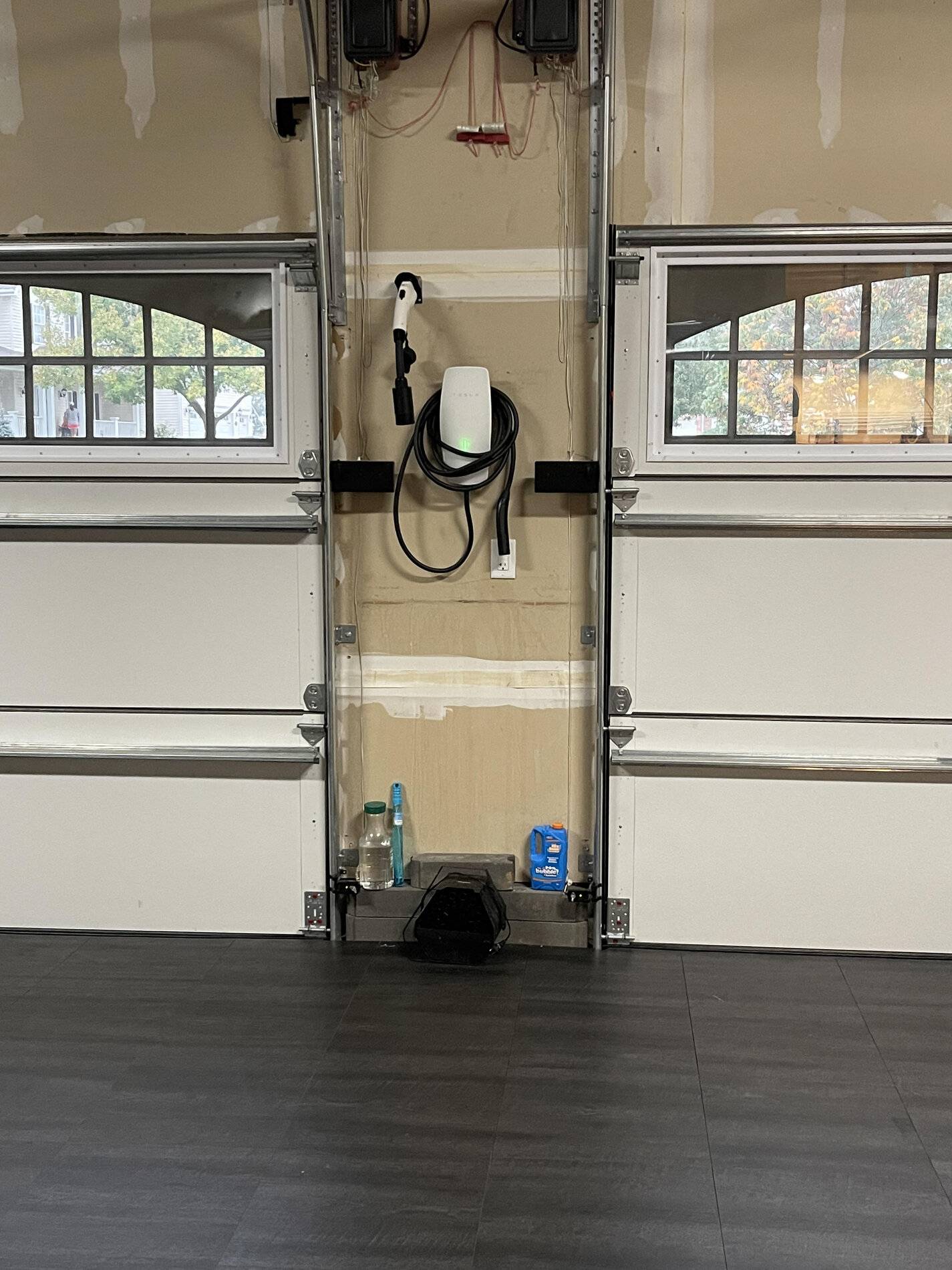

Sure thing. Haven't painted the walls in the garage yet, as you can see. Did throw down flooring and get the whole thing organized while waiting for my order to progress. Need to get around to mudding, sanding and painting as the weather cools. :). I ended up throwing the sub-panel in an alcove I have in the garage with my work bench and tools and stuff, so it worked out well. I have enough extra in the panel to throw an additional charger, or heating/cooling if I end up wanting it in the garage. Trying to plan ahead in the build out.

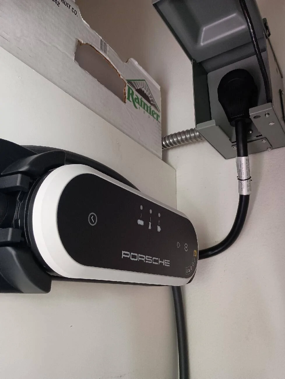

I will be "level 5" on your scale. So far I have pulled 3 AWG #6's and one #8 ground into an RV 14-50 outlet box. Using the PMC+ @ 50% until I get the replacement recalled 14-50 cord.
I need to upgrade the outlet to a Hubbell #9450A and probably need to change the box at that point.

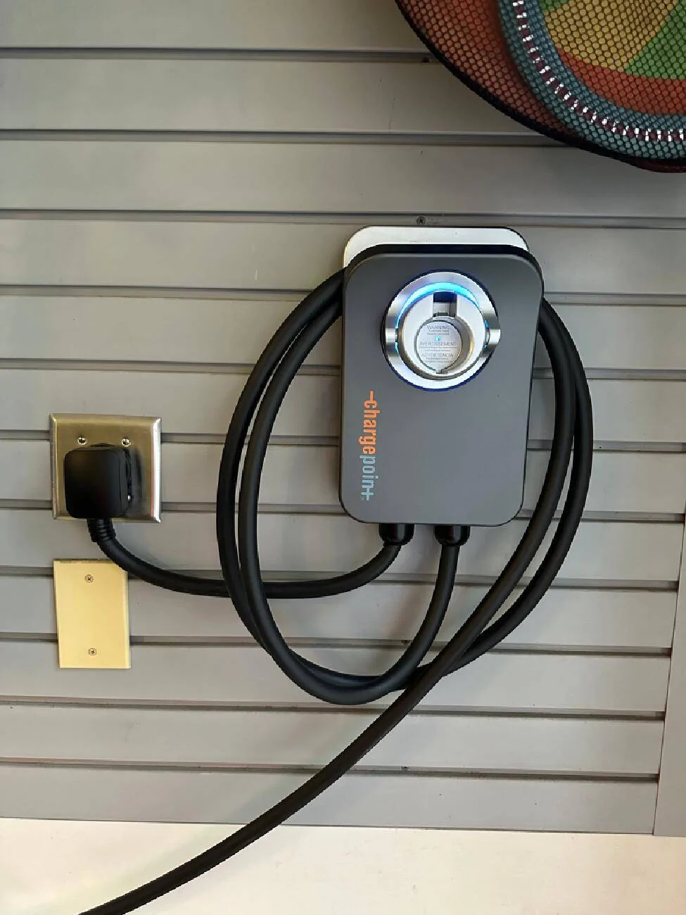

Purchased the CharePoint EVSE and have the house wired with a NEMA 14-50 outlet in the garage. Charged my Tesla with it for 10 years. Now the Taycan. I’ve rotated the plug 90 degrees from this picture so the supply cord isn’t kinked as much.
