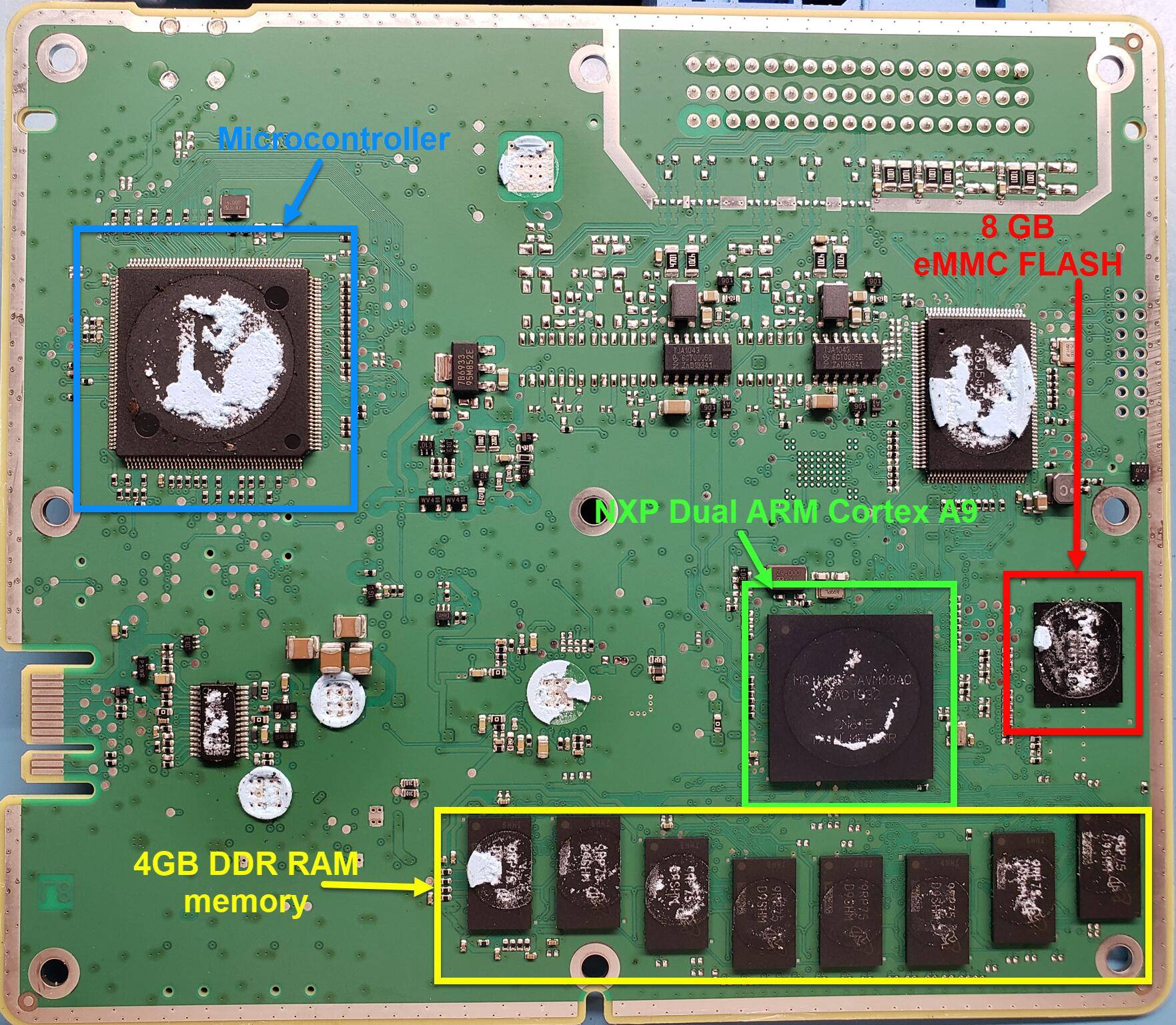

Had Porsche gone down the 100% in-house path from the drawing board then their implementation would have been much simpler / smoother / controllable but as they didn't they've ended up with a bugger's muddle and hence OTA is never going to be a Porsche success story unless they rip it up and start again (I expect it's only a matter of time).
You are not wrong. IMO their mistake was to not start with OTA as a hard requirement across the whole car. I did some learning of Porsche electronics while waiting 20 months for my Taycan (got used parts off ebay to play with, even built myself a small cockpit). Gotta tell you, I think they were planning on a fairly extensive OTA as there is a fairly powerful, dedicated ECU in the Taycan to handle OTA's - it has an dual core ARM Cortex-A9 application processor with external DRAM and FLASH memory (think smartphone electronics, but automotive grade), as well as a separate automotive microcontroller onboard with a whole bunch of physical connections to different onboard modules. I don't know exactly what happened there, but I don't think they are using it much, almost at all. Maybe they missed the schedule and cannot make it up anymore, maybe it was too hard - beyond the scope of their expertise, maybe they screwed up the hardware design somewhere and in legacy automotive fashion are waiting until next generation platform to fix it? Who knows. Sad that they didn't make it work.
PS> Here is what the OTA module looks like inside, for those who like these kind of details (excuse the thermal paste mess, I only took a whole board picture before I cleaned it off).
