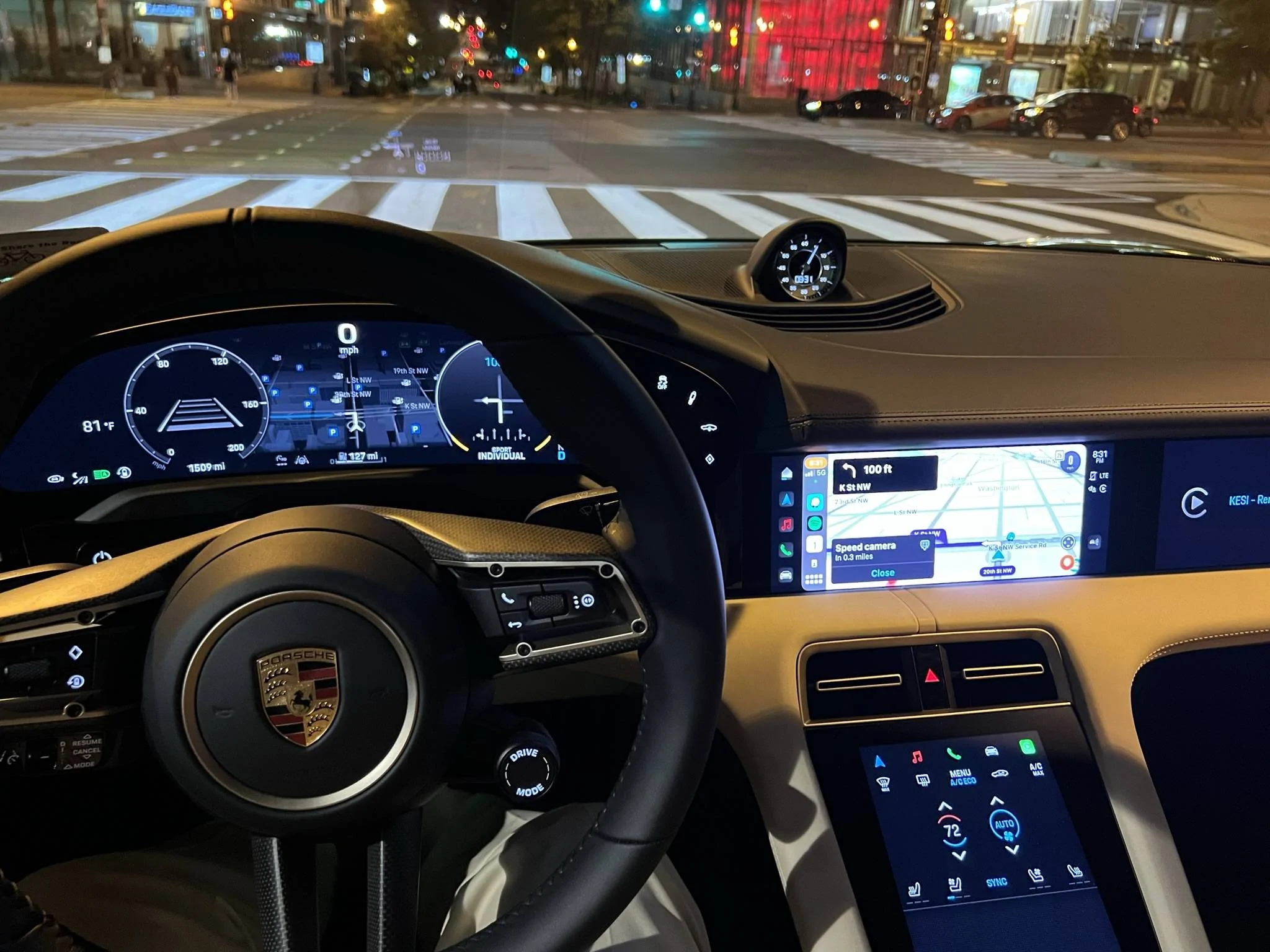

Haha. You don’t use one and I always use two at once!
https://www.taycanforum.com/forum/threads/why-i-dumped-carplay.13069/post-195161
It’s not the “route” itself that is a problem: that’s easy enough to look up before travel. Rather, it’s the variables. Around me, there can be long delays due to accidents, events, protests (like, for just one example, January 6, which can be debated by most from a distance but which affected me and my family very personally). The police also move around and hide or set up temp cameras. Radar and laser detectors just do not work for those situations. So, for my particular circumstances, I feel that I need instant, up to date information regarding subjects that can materially impact my travel. I can’t give up native navigation due to battery warming and I like how it displays info on display screen and heads up, but I also want the real time update via Waze, which has widespread usage in the Northeast. Ideal would be for native to take in data from Waze and integrate it into the native system.
