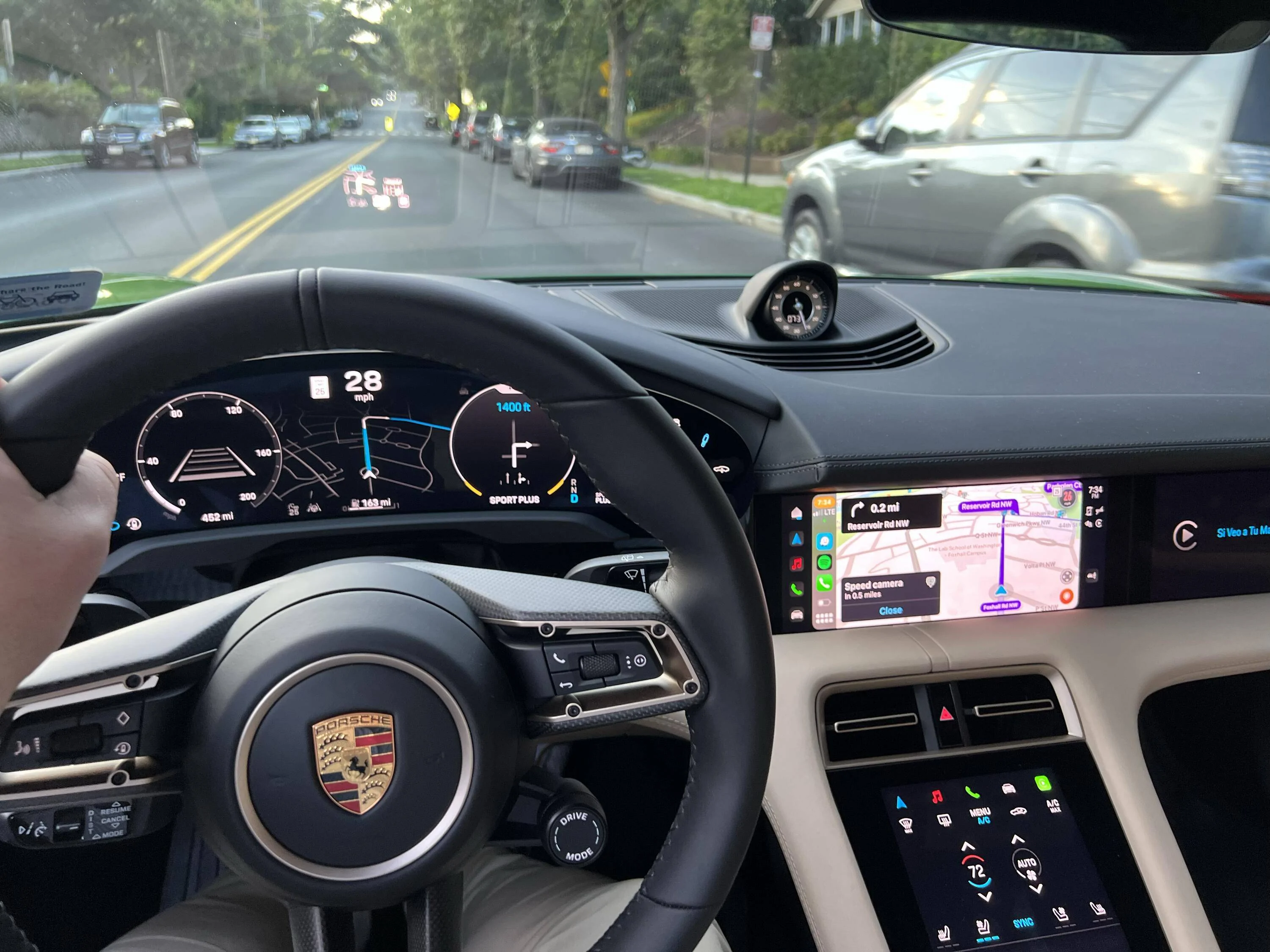

True. But I am also able to get both systems actively routing at the same time. It can be picky at times, and I know that some here cannot seem to make it work, but as you will see in my pictures, I seem to be able to do so.
Porsche Taycan Why I Dumped Carplay tempImage8F5G4o
On a side note, I find this picture amusing because it shows the difference between GPS speed, which I assume is more accurate and Porsche indicated speed, which I assume is conservative. Here, the speed limit is 25 mph, GPS says I am going 26 mph (as shown by Waze) and Porsche says I am going 28 mph. The conservatism seems to increase with speed, so you may think you are speeding a bit at higher speeds but actually may not be.

It's worth mentioning that when a phone is using CarPlay, it's being fed its location lat/lng from the car's GPS receiver – its not using the phone's built-in one.
This is why – for example – CarPlay navigation apps continue to work inside tunnels – as the car's navigation system will start to estimate location from the turns of the road wheels and steering wheel inputs – at least for a few minutes.
Obviously – as you have shown – the dashboard speed is calculated from wheel rotations and not calculated from GPS location changes.
I am unsure if the wheel speed is fed into the CarPlay data feed, but looks like that app you are using – either way – uses changes in location per second to estimate speed.
