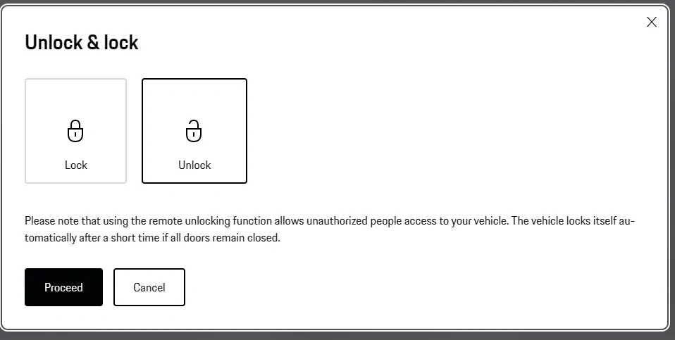

Nope--same issue. I get the status box (your first image) but canot get the Unlock & lock box....clearly not available on MY 202--which, again, was my original question- I'd like ot better understand why this hasn't been/could not be updated via one of the many software updates.

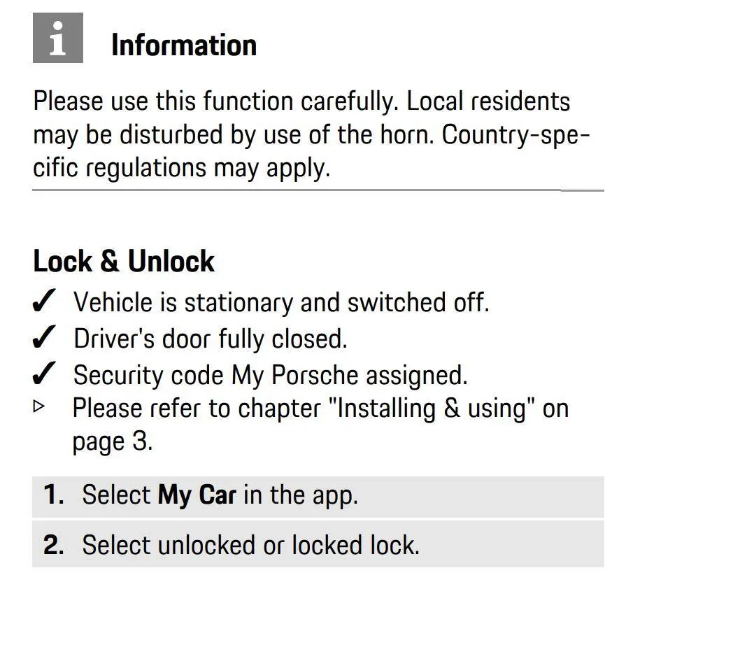

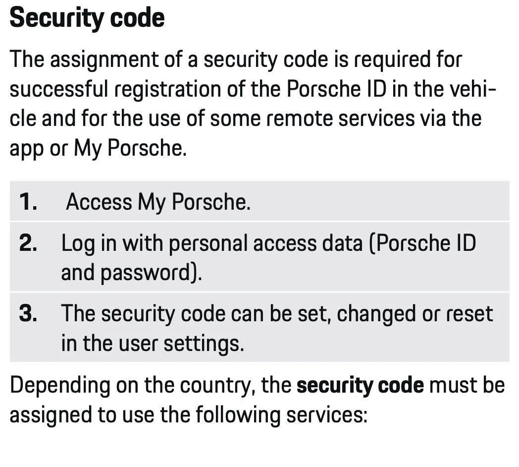

I read in the Porsche Connect manual that lock/unlock feature from the app requires a security to be set. It a matter of fact the app prompts for the PIN code when tapping the unlock button.
Just wondering if the feature is disabled in the app if no security code is set.
I have never seen that before How did you to the place where you set the Security. I am a pretty thorough reader, particularly when setting up my cars, but have not seen that. Wonder if this is a non-US thing?
It's in there... might be a Europe thing though...

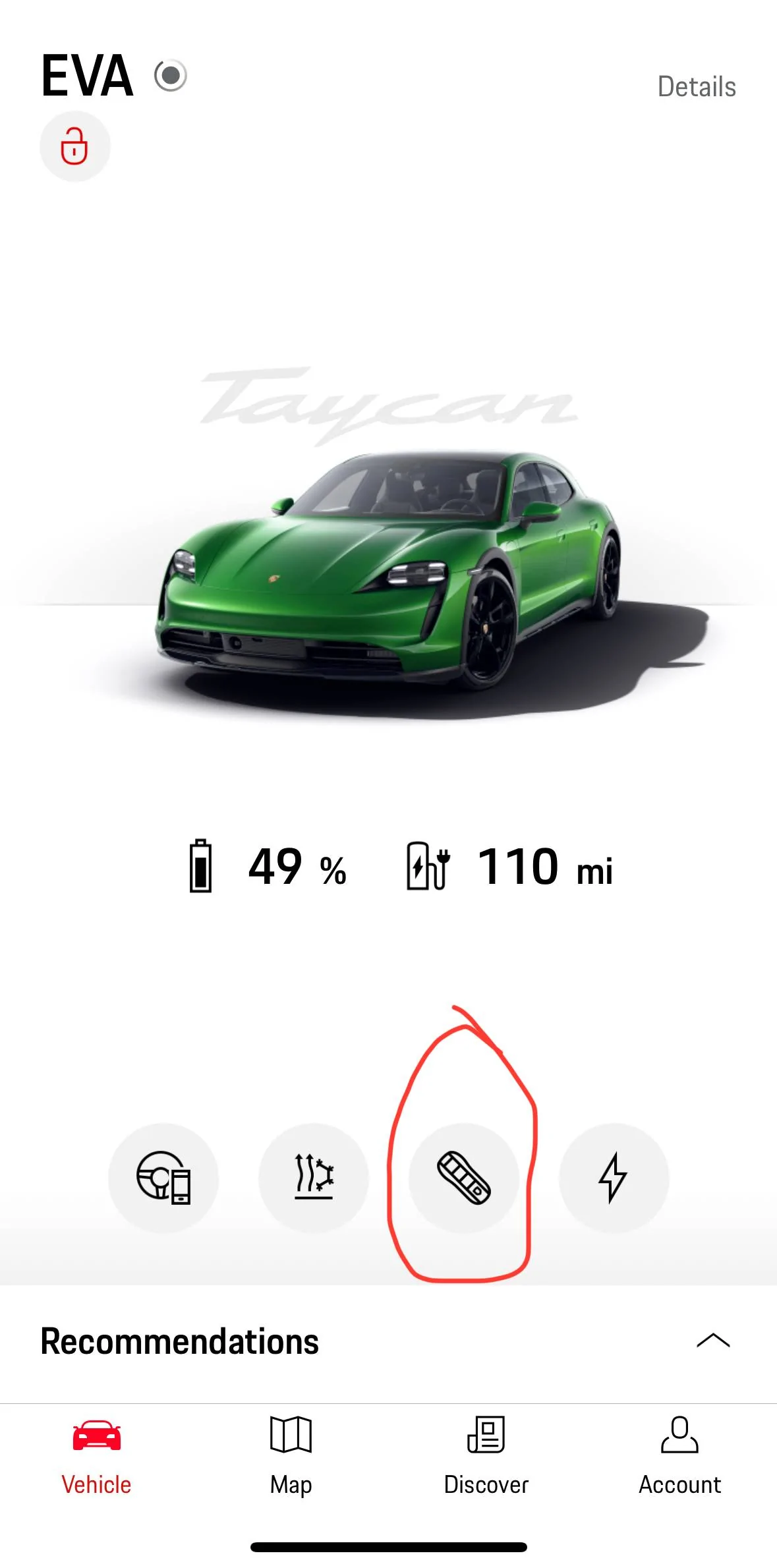

I added a photo to my original post. I also added one here showing where the button should be located.
[/QUOTE
what year is you Taycan I also have a 2020 with no lock and unlock option on the app
