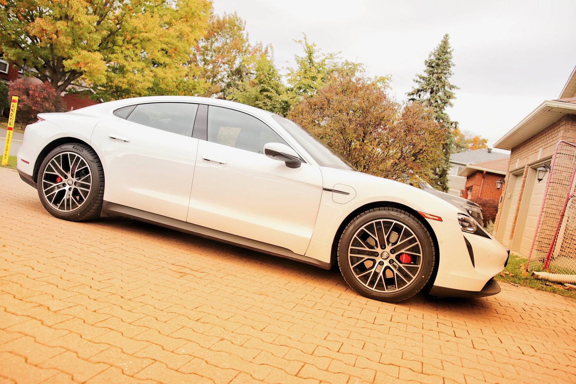

I'm in a snowy part of Ontario, and recently took delivery of my 2021 Taycan 4S. Winter tires in this part of the world are an absolute must. My dealer quoted around $8k for their 19" winter wheel and tire package, which I declined, and after some debate over Nokian vs. Pirelli (I've always been a Nokian guy - IMO they're the best winter tires), I elected to swap my all-seasons the car came with (20") for Pirelli winters. The reason I did this is that the Pirellis were apparently designed specifically for the Taycan. I've always swapped my own tires (on rims), but alas not on my Taycan... The dealer was nice enough to have the tires swapped in time for my delivery appointment.
Porsche Taycan Winter Tire Advice IMG_4148

If the tyres are marked "NF0" – like the Pirelli PZero Winter's – then yes they are a Taycan specific tyre.

Where did you buy the Pirelli's from and how much? I got quoted 8k for winter wheels and tires from the dealership too and not sure if I could get it cheaper somewhere else
