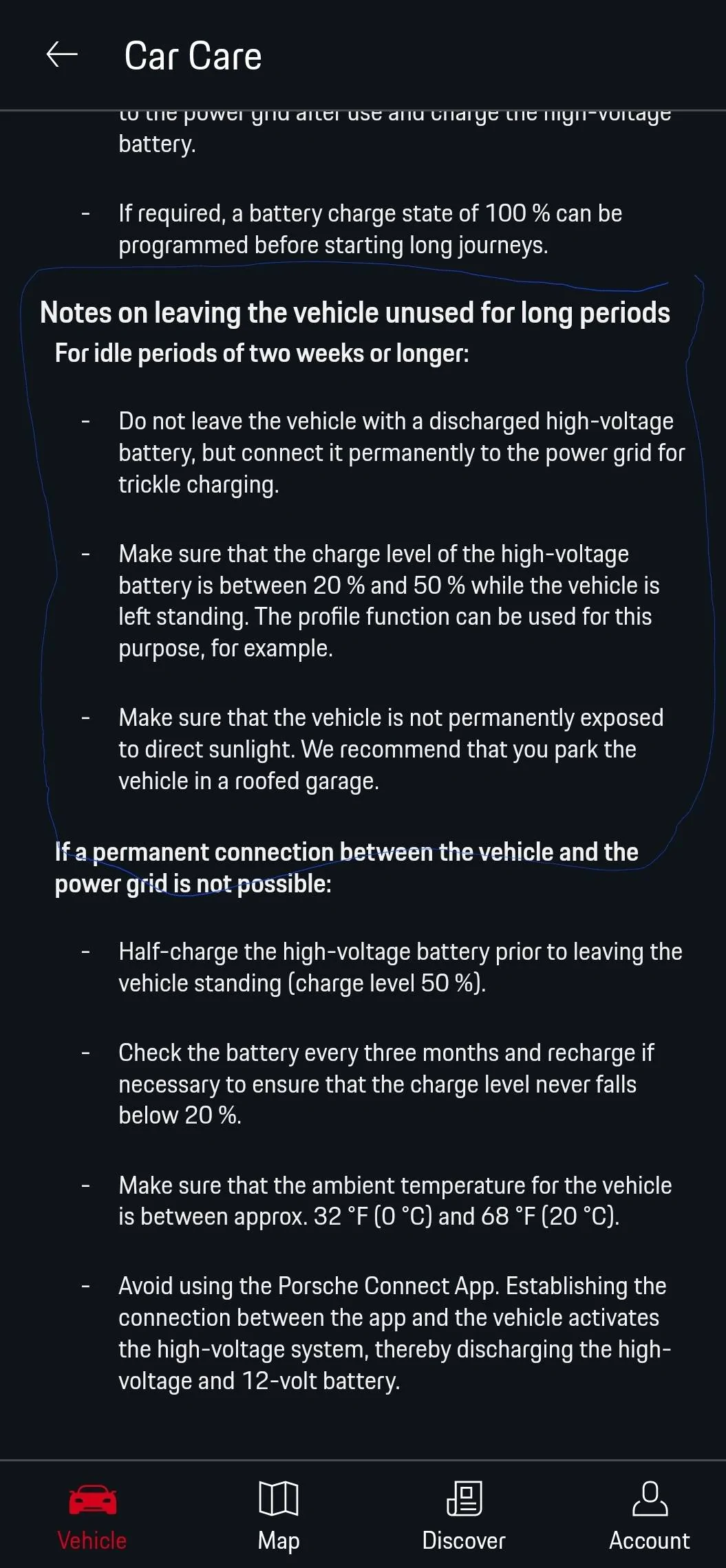

Hi fellow Canadians!
With winter approaching (and full on in other parts), I wanted to ask if anyone has experience storing their Taycan for the winter? Any tips or suggestions; i.e. should i keep it plugged in, should i drive every couple weeks on a sunny dry day, etc?
This will be my first winter with my Taycan and thus far I've covered it and occasionally check the battery status on the app.
Thank you all in advance for the help!

Porsche Taycan Storing for Winter Screenshot_20221204_113508_My Porsche
I follow this for the battery. Chock the tires, over inflate. Leave it in park and then go into the vehicle settings to disengage the parking brake.
this is in addition to cleaning out the car, cleaning the car, etc.

Just so I understand, the recommendation is to leave the car plugged in but with the profile set to between 20-50% charge so it keeps the battery topped off up to that level. Is that correct?

Yes, if you're using Porsche's PMCC, turn the charging current down to the lowest setting too.

There are a few threads on here. But it seems the last big software update made the HV battery able to keep the 12v battery charged up. However, it will only do that for a certain number of cycles between the the car being unlocked (or used maybe?). Anyway if you can remember to go sit in it from time to time to restart the 12v charge function from the HV battery, do that. Or put a trickle charger onto the 12v battery as well.
