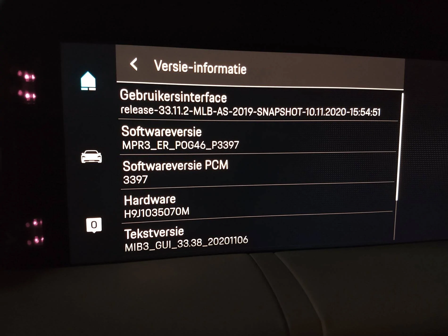

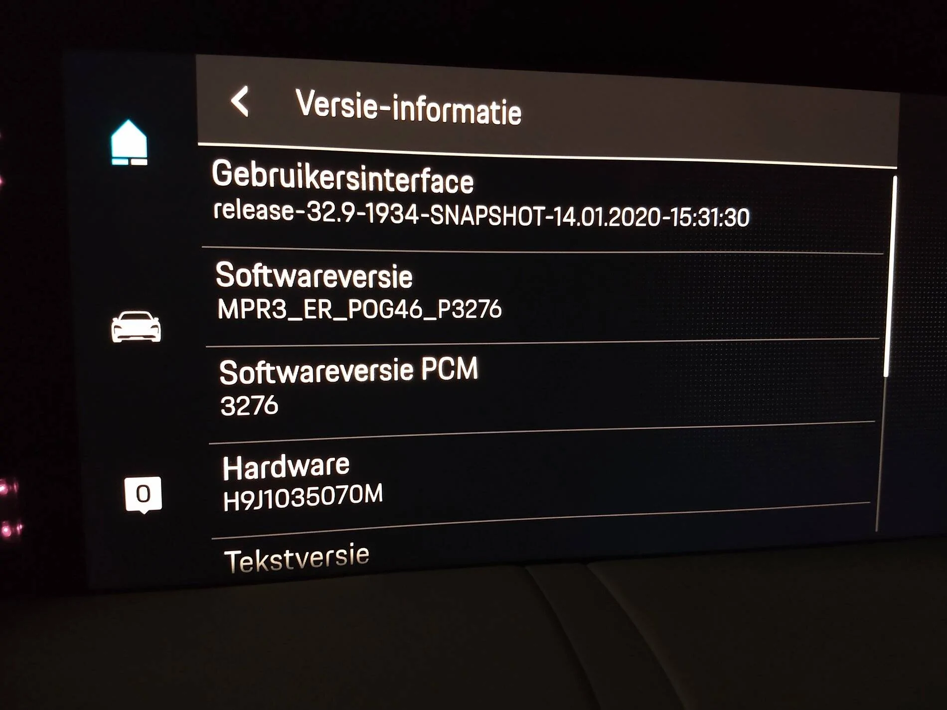

WMA5 and WMA7 (charger) done.
My car is a MY20.
So far I noticed the extra function Smartlift and the keyless entry/lock works much better.
OTA-module works again!
Got the PUGP too (Porsche Update Goodie Package).
My dealer is really the best!
Once I switched the car on I also got 8 updates OTA (over the air) for the entertainment system and some other stuff.
So far so good.
I'll dig into this to find out the changes and extras.

Can you share screenshot of the PCM version?

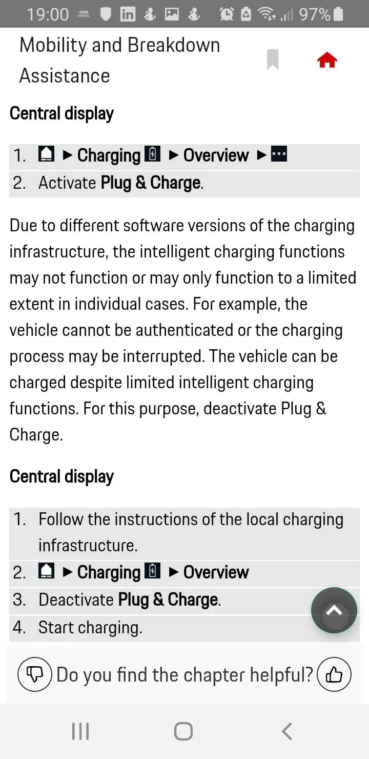

Do you see the plug&charge option in the Charging settings (you have to check under the three dots '...')?

Just been updated as well. All seem fine. How do you activate plug n charge? I’ve got PMCC and looking to stop entering the pin. My charger is public so pin enabled.

With this enabled and your car authorised to the charger you can enable the PIN (and set a guest one). PMCC will recognise the handshake (see my earlier post but you will need to activate PLC to the car) and not prompt for a PIN. A PIN is required if you want to access the settings etc on PMCC. Other than that it is straightforward to configure as you want.
