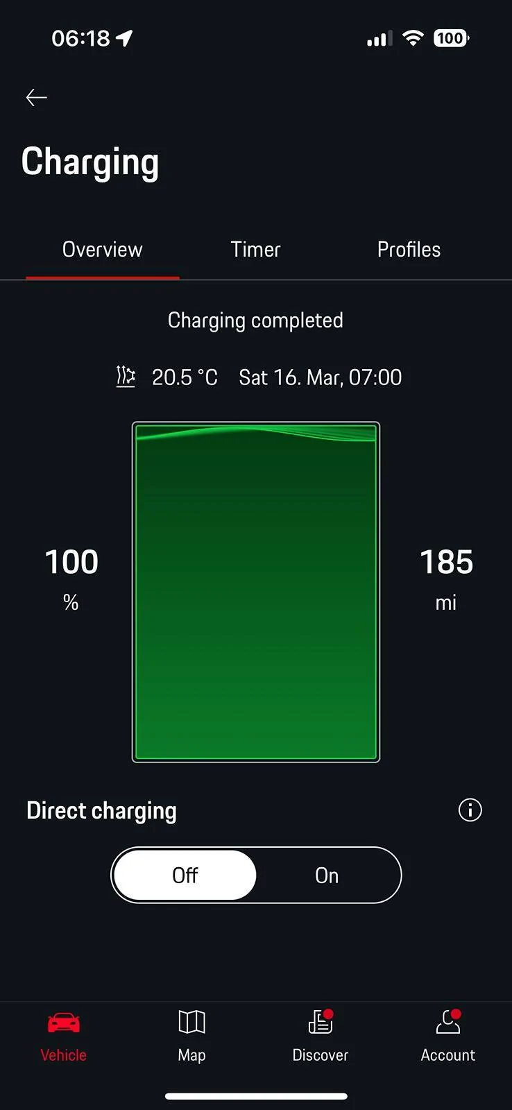

I used to have a Taycan Turbo and would get 240 miles at 100% and 200 miles at 85%. (Slight variation with temperature)
I moved to a Taycan ST Turbo S and I’m lucky to get 203 miles at 100% and 160 at 85%
Is anyone else getting better with a Turbo S ?

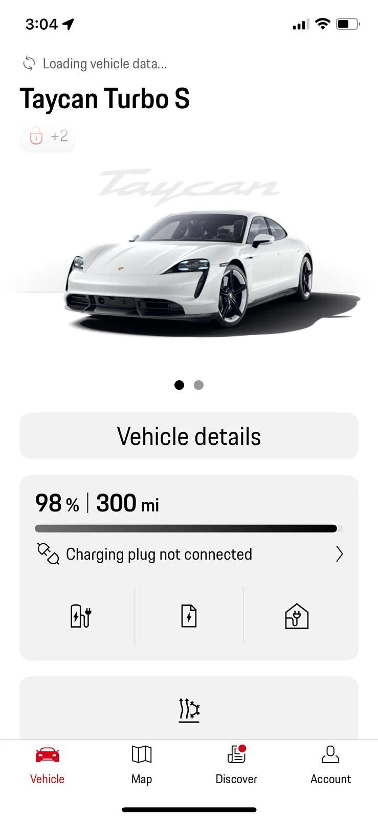

I get over 300 miles (range setting) estimated on my 3-1/2 year old 40K mile Turbo S. As mentioned, this does need to be viewed in the proper context. The temperature affects the range estimates significantly, and the 300+ mile estimate needs to be at almost 70 deg F or higher ambient. Also it depends on your driving style. I do not use the brakes much at all - my Panamera GT went 100K miles on the original pads and rotors. I also have two replaced cells (out of 33) and I 'rebalance' my cells every few months (not sure if this contributes to the high mileage estimate or not). I can verify this estimate is accurate in my day-to-day driving, put will probably be less if I take a long trip at high speed (70mph+).

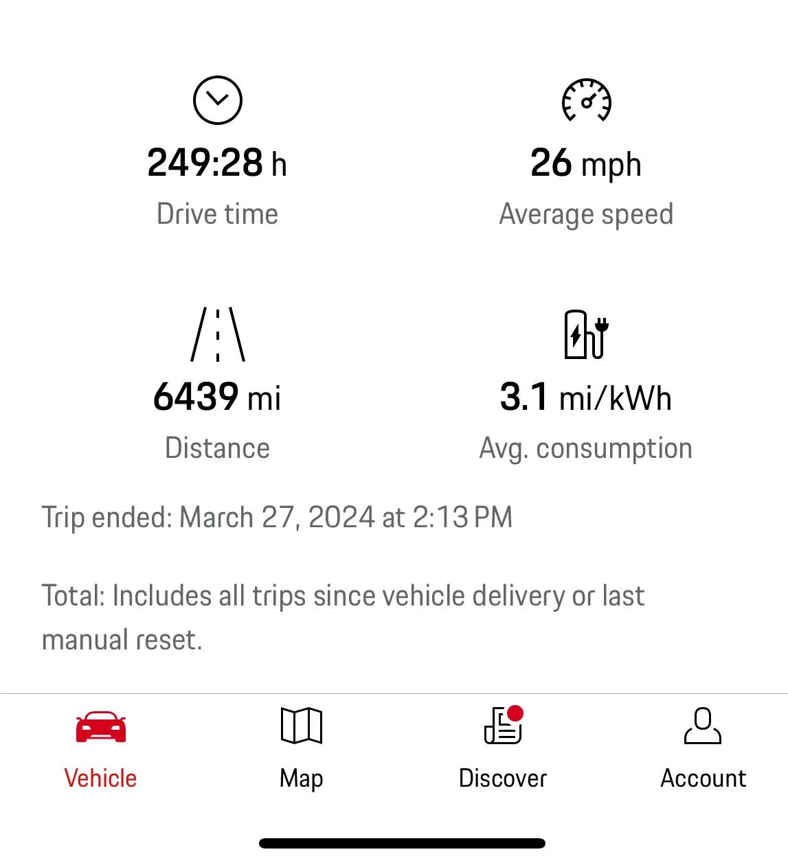

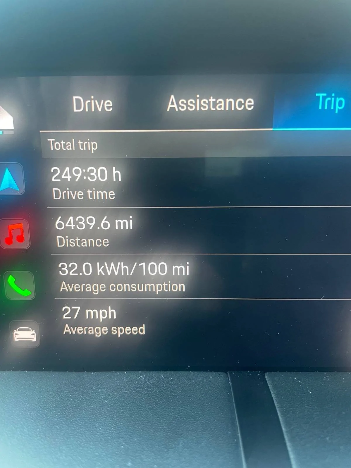

Both car readout and app agree with 3.1mi/kWh. Here are the readouts:
Porsche Taycan 100% Range on Taycan ST Turbo S IMG_5531
Porsche Taycan 100% Range on Taycan ST Turbo S IMG_5532
Ok, that is helpful to see where your numbers are coming from. Unfortunately those numbers are not accurate on any Taycan as far as I can tell. My car shows the same 3.1mi/kWh number on those screens.
If you look at the individual trip numbers (since time, or since charging)you will see much lower numbers. Probably in the neighborhood of 2.3mi/kWh. If every trip is 2.3-2.7 the average cannot be 3.1.
Not sure how Porsche gets this mixed up. But discrepancies like this cause some owners to think they’re doing great and some to think that they have a problem.
The EPA range number of 78-80mpgE translated to approximately 2.3mi/kWh.
