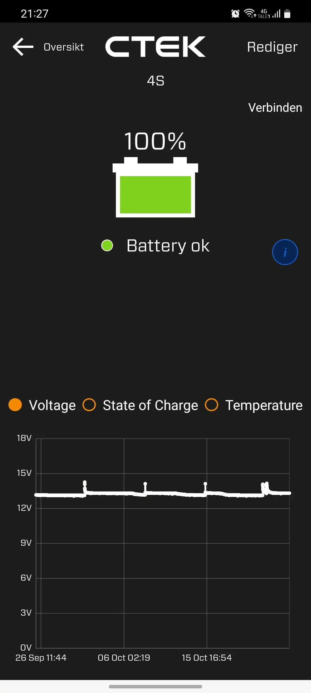

So I had a revelation during last night @800v
Does your battery monitor keep the data even if it is powered off?
After that sudden realization, this morning, I installed the ctek battery sense into my current car.
After I gather data for a day, I'm going to pull the fuse, wait an hour and reconnect.
I suspect all data will be lost which means the device will be useless to test the taycan during "extended holidays" because once the 12V battery goes offline, I'll loose all history that led to the battery death.
Back to the drawing board. $50 down the drain. Bummer.
