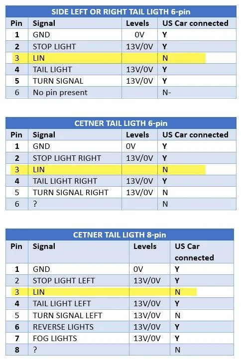

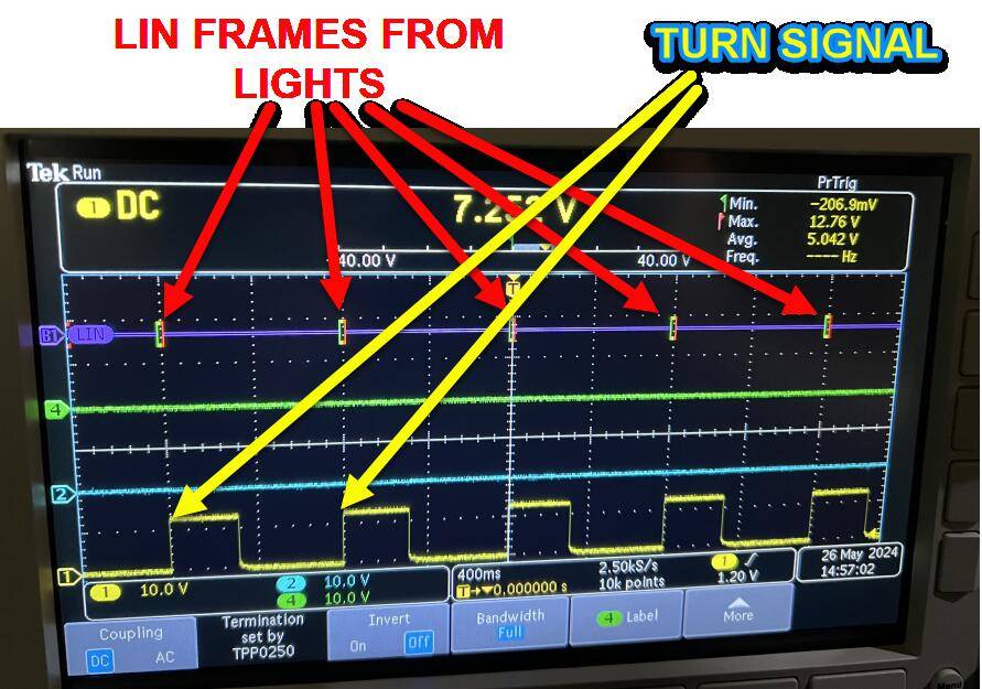

As part of my retrofitting Euro tail lights project, I ended up doing a bunch of reverse engineering.
One thing that I found was that the tail lights (at least the Euro ones I got) have a live LIN bus active, meaning there is something in the lights that is speaking digital communications to the car.
Porsche Taycan Animated tail lights - project opportunity 1718742057897-j1
Unfortunately, those pins are not connected - see PIN #3 for all tail light connectors (4 of them).
Porsche Taycan Animated tail lights - project opportunity 1718742158887-or
Looking at the available settings for the rear BCM (BCM2) which controls the tail lights, there is a setting to enable animated tail lights, as well as test for them (under Drive Links in PIWIS). This leads me to believe that is the four LIN pins were connected to the correct LIN bus pin of the BCM2 (sorry, I don't know which pin), you could code/enable animated tail lights for a Taycan, which would probably look like this.
While personally I have no desire for animated tail lights like the above, I know there are people who like them. So CALLING ALL TINKERERS LOOKING FOR A PROJECT. Take what I found out so far and try to enable the animated tail lights. Things to do:
  1. Find out which pin on BCM2 is the correct LIN bus to connect the lights to
  2. Wire the four LIN bus connections to the above
  3. Code the BCM2 to enable animated tail lights (if you get this far, reach out, I can go back to see where those settings were)

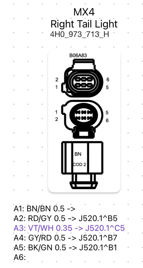

OK, so if anyone is looking to do this, here is what I have found. It will likely be a few weeks before I am able to work on mine or take any photos.
There are a few permutations of the wiring on 4F0_972_575_D, but I believe pin 7 is either empty or may already be connected to the BCM with the violet/white wire.
All wires are violet with a white stripe, 0.35mm.
Right Tail Light:
Connector part 4H0_973_713_H pin 3 should connect to connector 1J0_972_977 pin 5 on the BCM2.
Left Tail Light:
Connector part 4H0_973_713_H pin 3 should connect to connector 4F0_972_575_D pin 7.
4F0_972_575:
This is the other side of the plug of 4F0_972_575_D. Pin 7 should go to connector 1J0_972_977 pin 5 on the BCM2.
Tailgate Right Side, 8pin connector 982_973_714_A:
Pin 3 should connect to connector 4F0_972_483_A pin 15.
Tailgate Right Side, 5pin connector 4H0_973_713_H:
4F0_972_575_A:
This is the other side of 4F0_972_483_A. Pin 15 should go to connector 4F0_972_575_D pin 7.

if you want to test out if the LIN has any action on the light, i would start with the right tail light, you should be able to connect A3 directly to C5 on the BCM and run a light test on PIWIS to see if the light animates. its a direct connection so you won't be wasting much effort if it works.

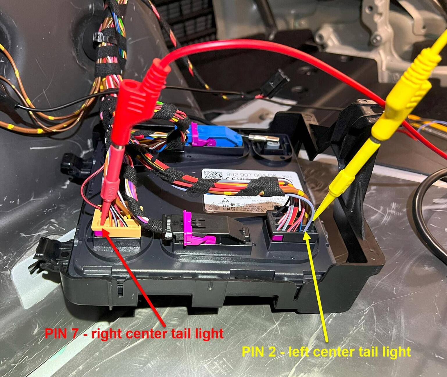

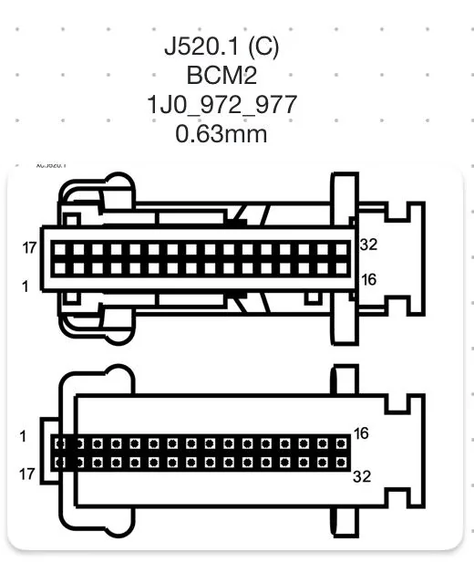

Thanks for this. I'm trying picture in my head and make sense of your original wire mapping post. For reference, here's whiteX picture of the BCM2 from his euro tails write up. Would you be able to clarify which 17pin and which 32pin BCM2 connectors by color?
Porsche Taycan Animated tail lights - project opportunity 1721770829986-bq
Right Tail Light:
Answered above. tail light pin 3--->pin 5 on the 32pin connector on the BCM2. Black or blue 32pin connector?
Left Tail Light:
Left tail light 6pin connector-->Pin 3 to pin 7 on the 17pin connector BCM2. I'm going to assume it's the black 17pin connector since that controls the left center tailgate light.
4F0_972_575:
There needs to be a wire connecting one of the 17pin BCM2 connectors to the 32pin BCM2 connector? In my case, both of the 17pin connectors already had a grey wire (brown connector pin 7/black connector pin 2)
right center tailgate--->pin 3 goes to yellow 17pin BCM2 connector pin 15.
Tailgate Left Side, 6pin connector 4H0_973_713_H:
left center tailgate-->pin 3 goes to black yellow 17pin BCM2 connector pin 15.
4F0_972_575_A:
I need some clarification on this, please. Seems like we need a wire connecting the two 17pin connectors together?
