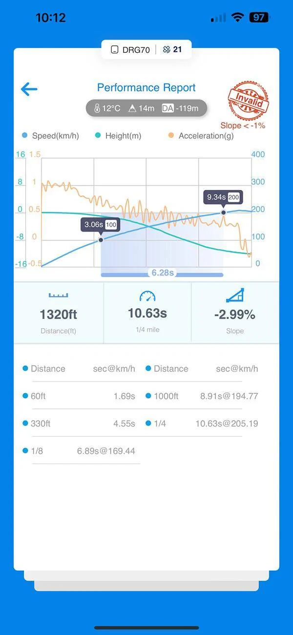

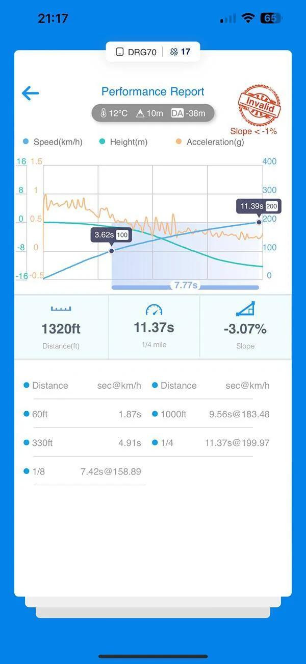

So i have some dragy stats. Bear in mind the closest, straightest, widest, safest bit of road has a 3% slope so dragy shows as invalid but the before and after were done at the same place in the same conditions. My tyres are almost at the wear marks, maybe 1k or 2k more left in them. Goodyear Eagle F1 Asymmetric 3s. On 21s. The road surface isn't the cleanest and the road temperatures wouldn't have been the best and the dog ate my homework, Putin invaded Ukraine, i stubbed my toe on the leg of the bed etc etc.
SOC greater than 90%
0-100kmh from 3.62 to 3.06 (with better tyres and a warmer, cleaner surface i think it would be closer to 2.8, it was struggling for grip, unlike before)
0-200kmh from 11.39 to 9.34
1/4 mile from 11.37 to 10.63 (it should be a small bit better but I lifted off a fraction early due to traffic ahead as you can see in the dip at the end of the curve)
Before
Porsche Taycan Redshift ECU Upgrade on my 2024 Taycan GTS -- Dragy Performance Results Before-Quater-Mil
After
Porsche Taycan Redshift ECU Upgrade on my 2024 Taycan GTS -- Dragy Performance Results After-Quater-Mil
So in summary if you haven't gotten this upgrade, GET IT NOW!

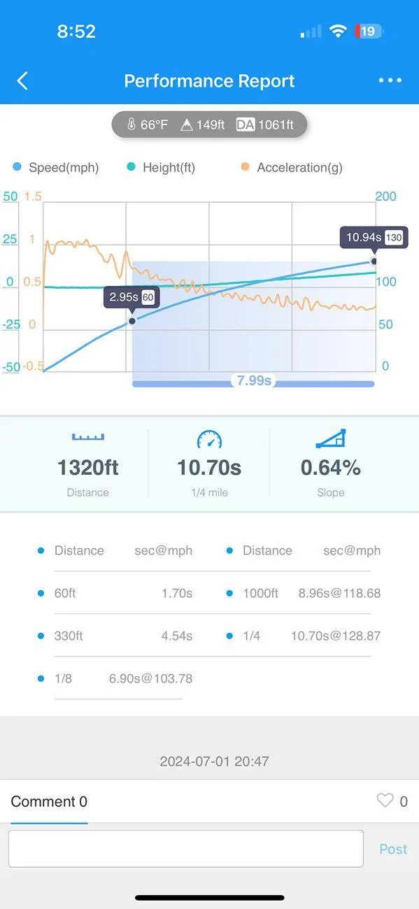

Thanks for sharing. Very similar (as would be expected) to my GTS with Reshift tune.
Porsche Taycan Redshift ECU Upgrade on my 2024 Taycan GTS -- Dragy Performance Results IMG_3924
