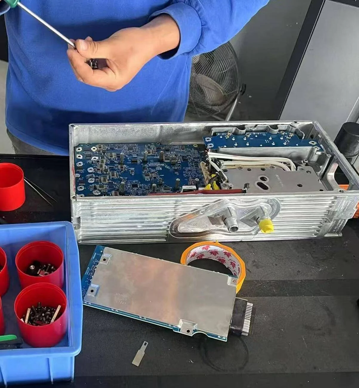

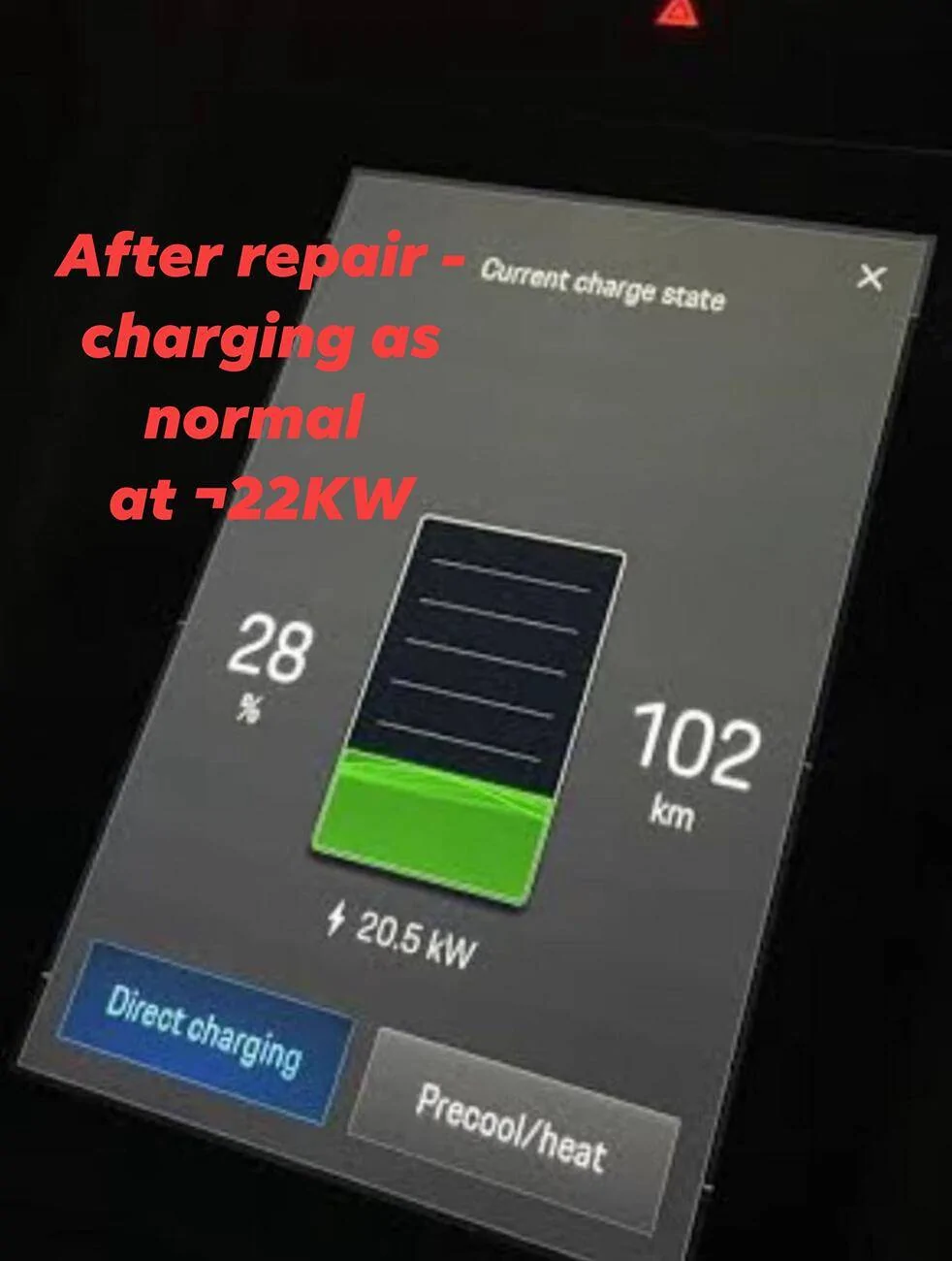

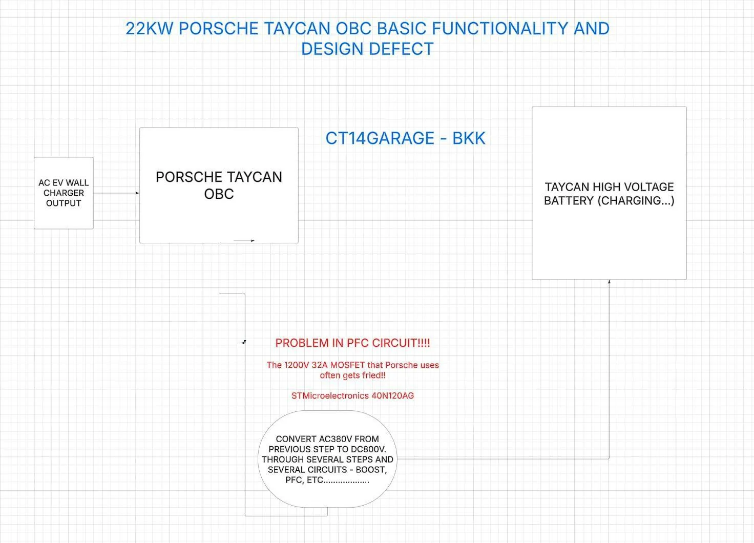

We've already replaced the faulty MOSFETs in two cars with the upgraded NSF040120D7A0, and so far, the charging works as expected. Fingers crossed, this fix holds up over the coming months, unlike the original part that would have fried by then.
@ct14garage , how are the OBC's with replaced MOSFETs holding up?
90
8,458
7,456

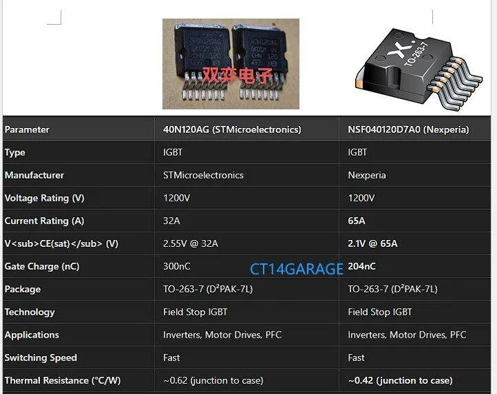

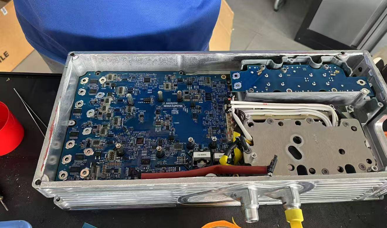

To solve this, I’m suggesting using a different part when repairing it- the Nexperia NSF040120D7A0, a 1200V, 65A MOSFET that’s rated for 33A more than the original. It's a direct replacement.

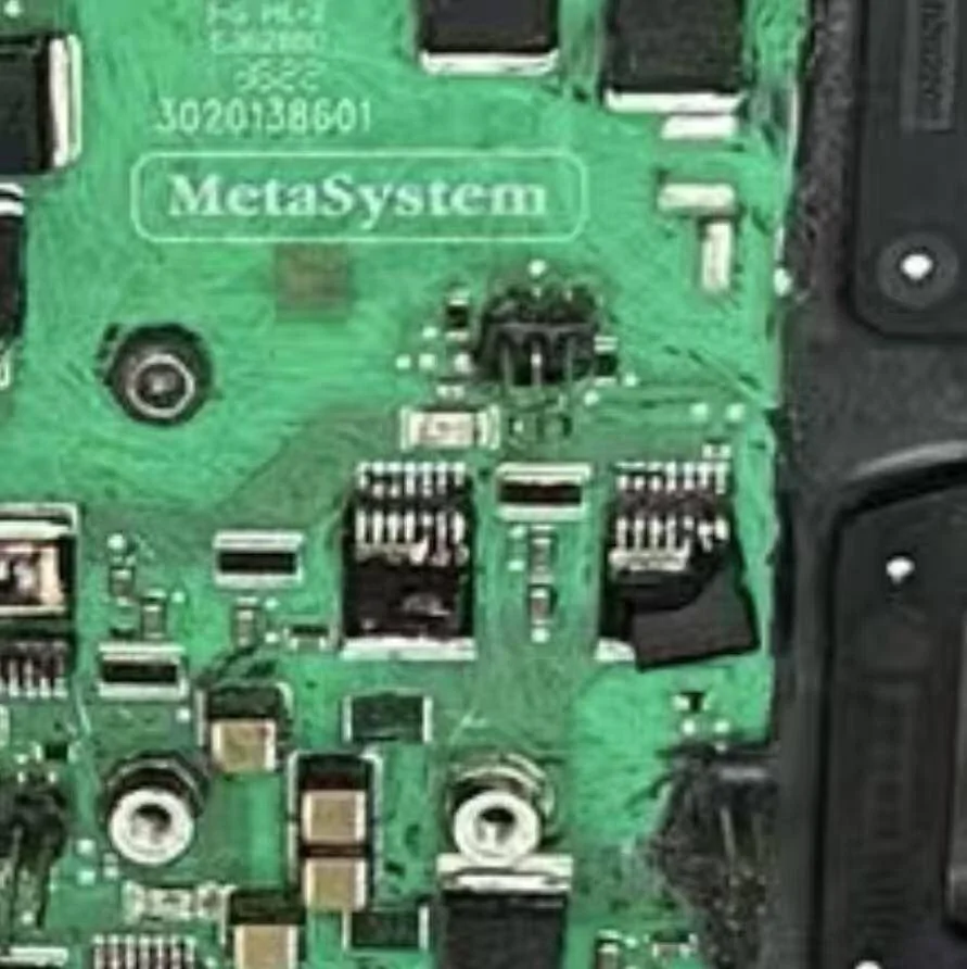

@ct14garage , do you replace all ST 40N120AG MOSFETS when repairing, or only the ones which have failed, or perhaps a subset of them that you have found tend to fail (maybe not all of them carry the full current)? Form your pictures, it looks like there may be 20 of them on the PCB.
