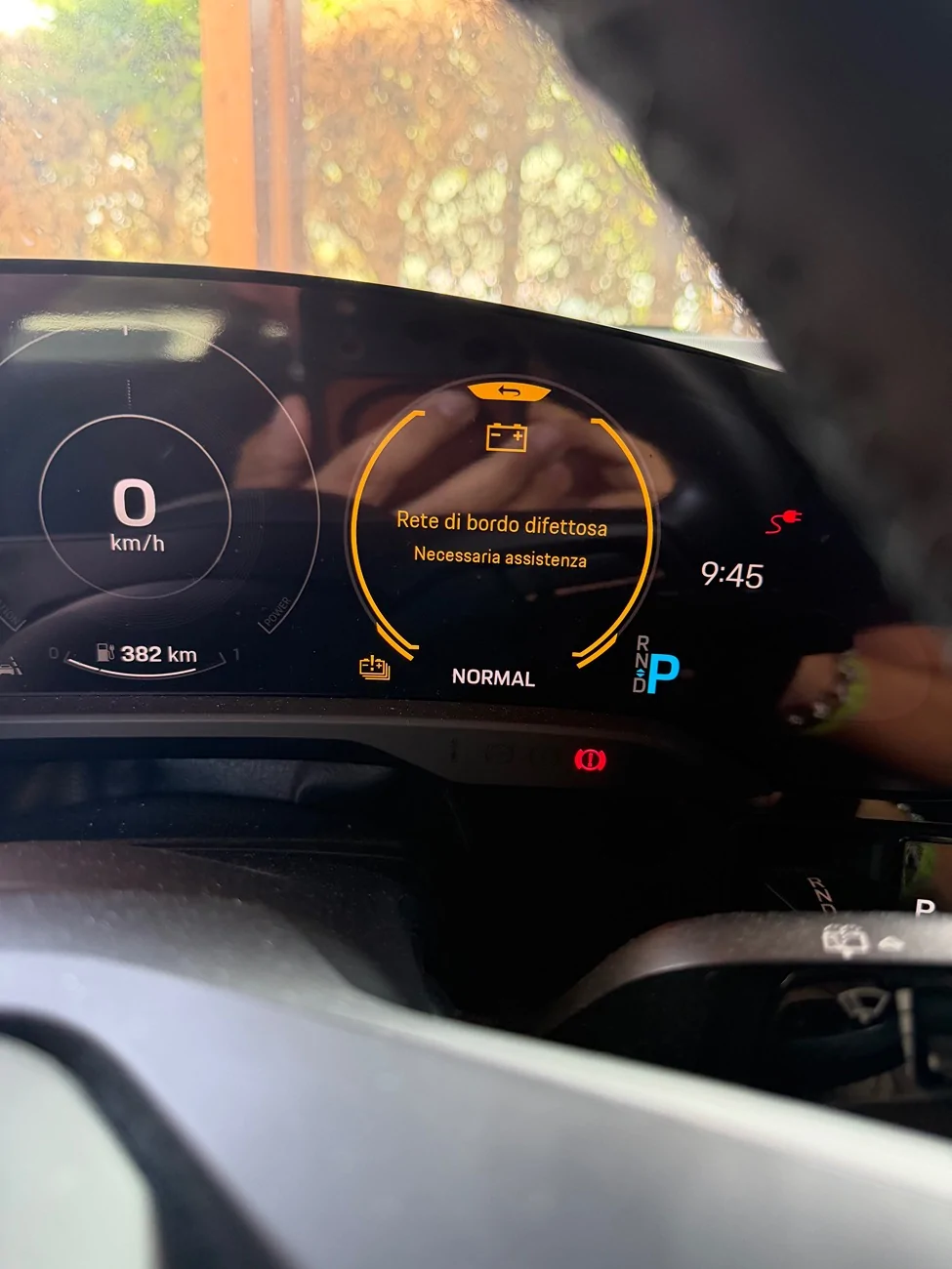

To date, no news from support, no replacement car from the dealership, they offered a 7-day rental car (a T Rock). Second breakdown in 18 months, I don't want to accept a downgrade to the 11kW module, I'm requesting termination of the contract, either with a buyback or with a trade-in for another car. If I don't get a response, I'll contact a lawyer. I live in Italy.

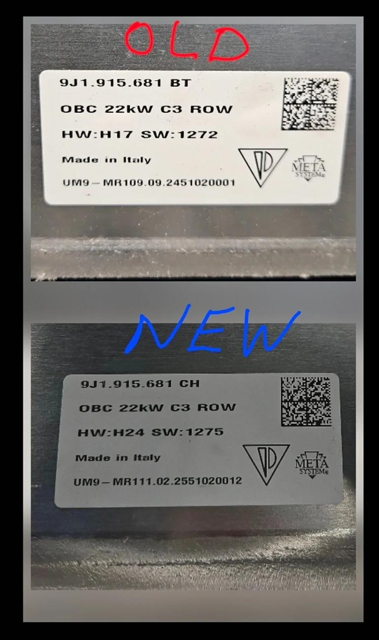

Does anyone know if the newer series is more reliable than older series? I got hold of the serienumbers old vs new and noticed hardware update / software update.
Did they perhaps update the MOSFETS as well in the newer / latest CH version? Perhaps @ct14garage has seen a couple of broken "CH" versions?
Very curious to hear any feedback on the reliability of later versions.....
