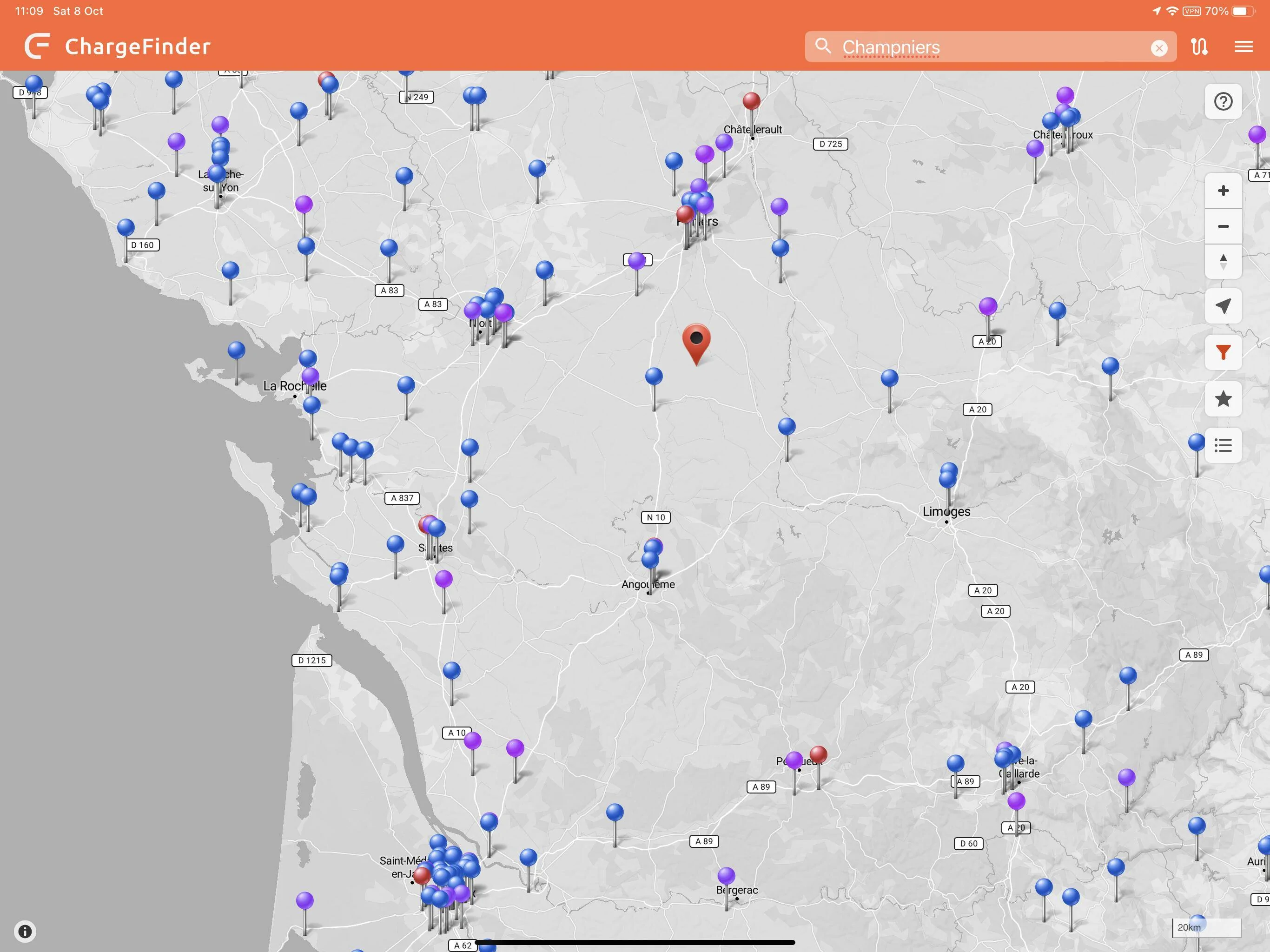

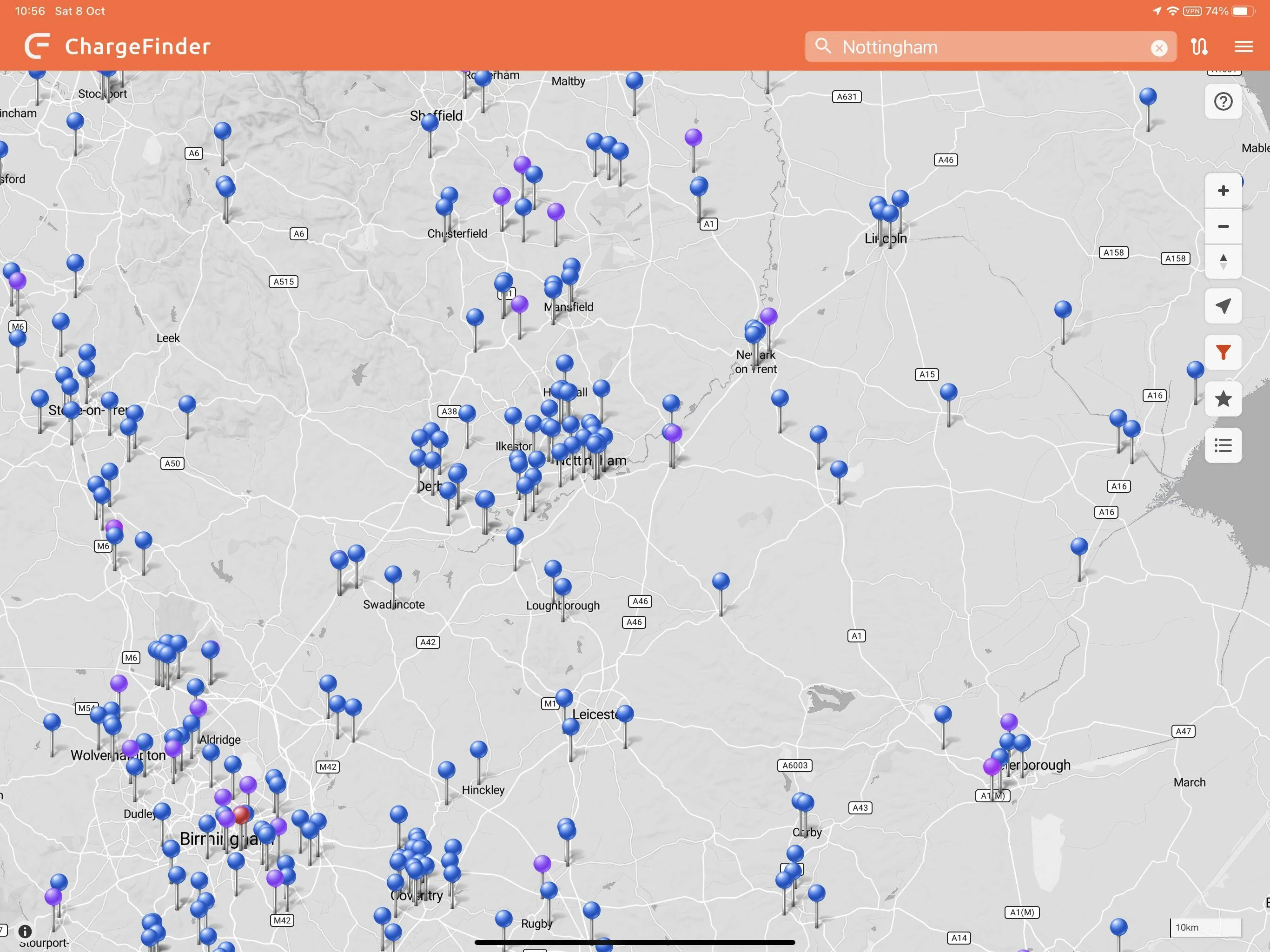

So checking on Chargemap our local town has only 3 22kw chargers no DC. Rural areas in Charente an Charente Maritime as mainly 22KW but a few DC 50KW about in the bigger cities. So local to me I might use the 22KW for an emergency. In Nottingham and Belper near my relatives rubbish hardly any charge stations at all.

There seem to be a lot of DC chargers around Nottingham as far as I can see.

I think a lot of people have recommended ZapMap for the UK. I have used ChargeFinder with very good results.

Yes there is more on ZapMap. Will try Charge Finder

Again looking at the area around La Rochelle, it seems a decent coverage of >50 kW stations..
I would love yo have so much around me.
