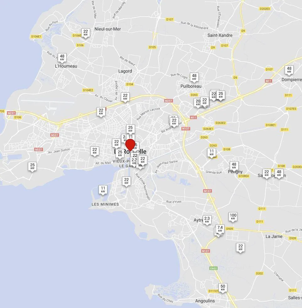

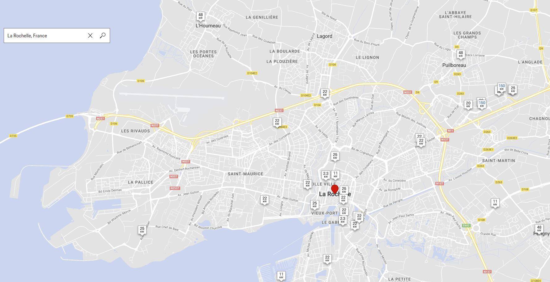

So checking on Chargemap our local town has only 3 22kw chargers no DC. Rural areas in Charente an Charente Maritime as mainly 22KW but a few DC 50KW about in the bigger cities. So local to me I might use the 22KW for an emergency. In Nottingham and Belper near my relatives rubbish hardly any charge stations at all.

It costs significantly more to retrofit.
I bet. But 1680 euros for something I will hardly use is a waste. It seems that even in the UK when I visit I could find 50kw chargers. Here in France we have lots of 100kw plus DC chargers and quite a few Ionity 350KW chargers around plus the others being rolled out such as Total Energies
