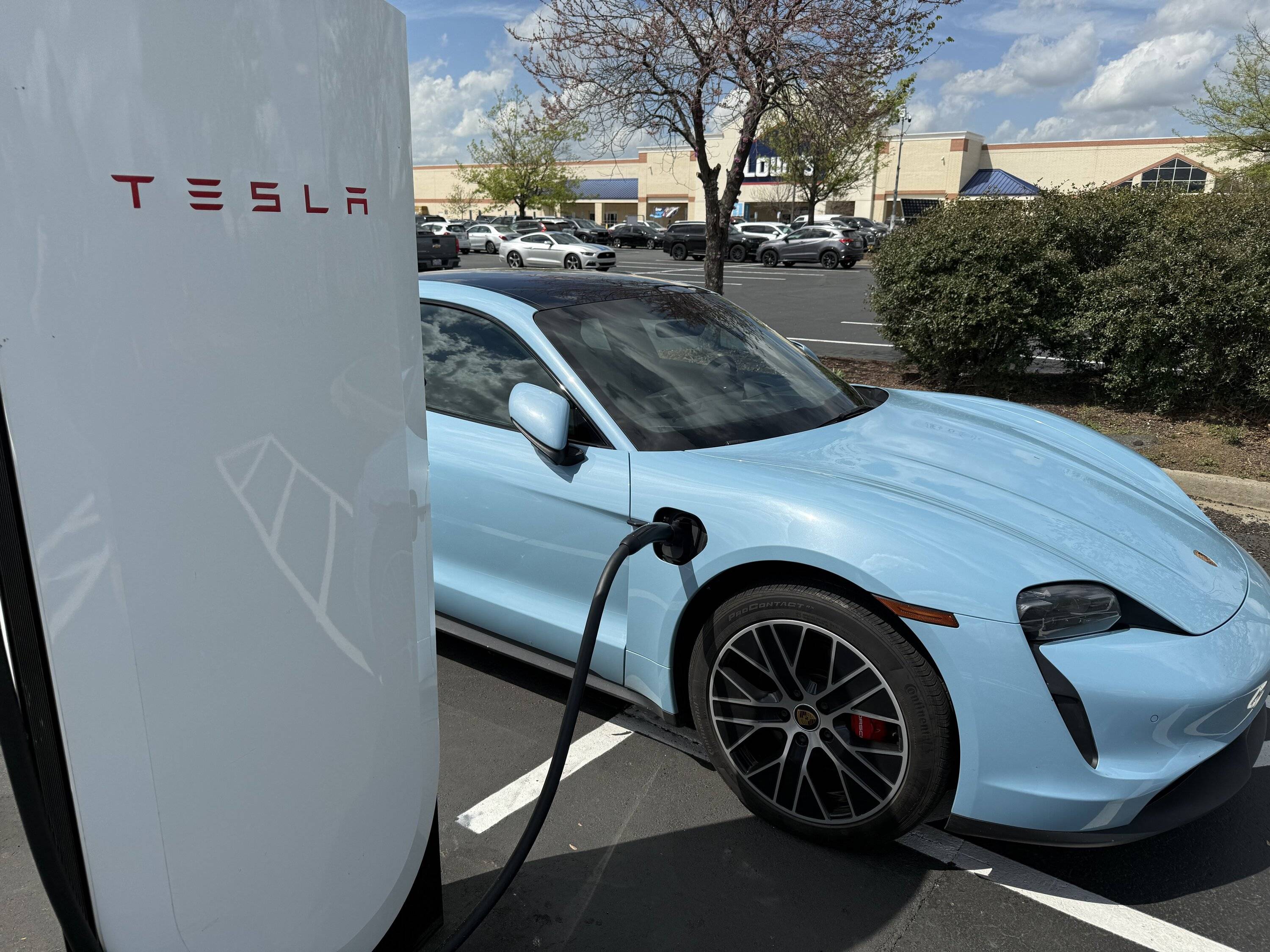

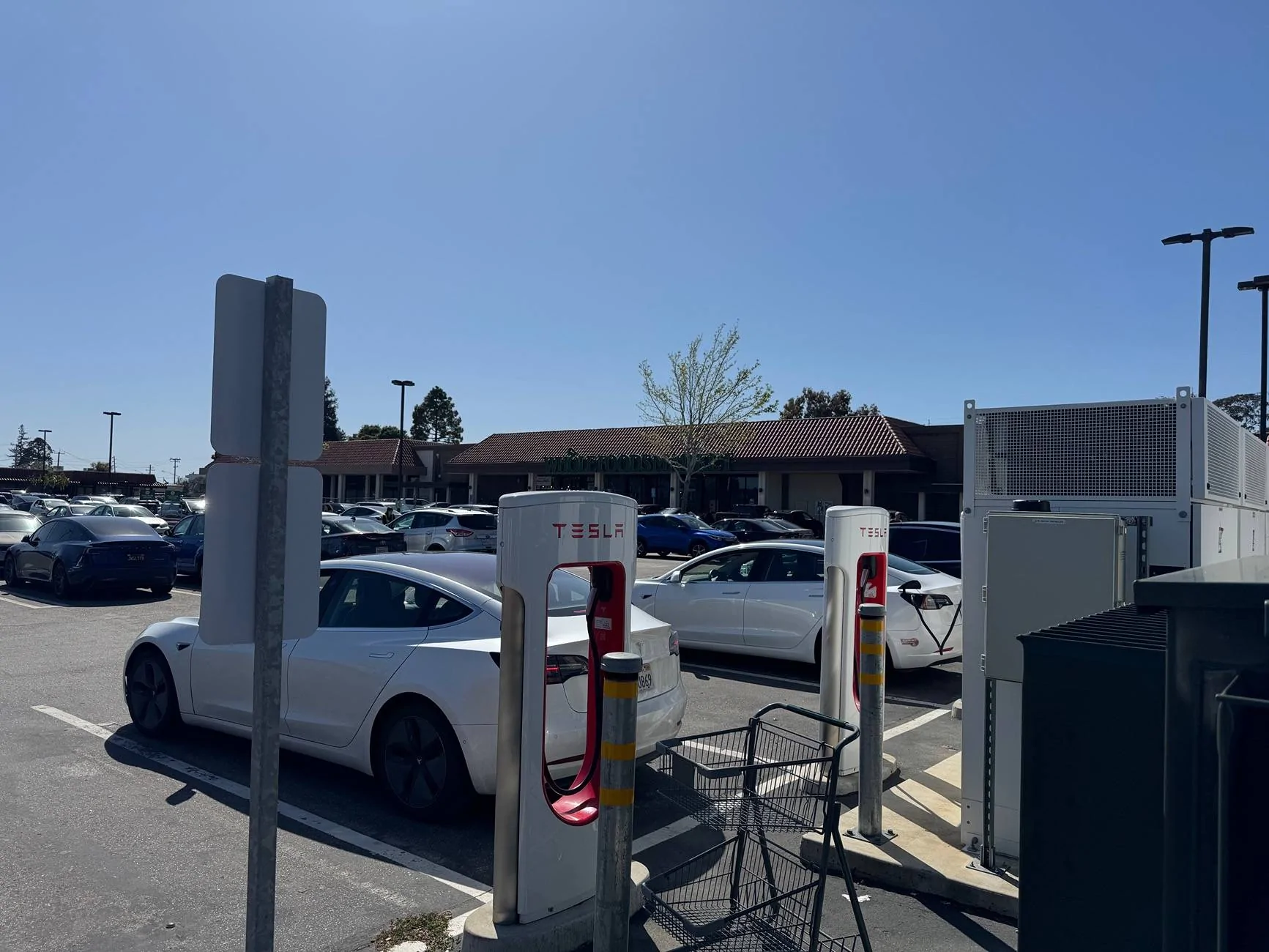

Just picked up a new to me 2022 Taycan 4S. Road tripped from Chicago to Atlanta and stopped at a Tesla Supercharger. Was able to charge using my NACS adapter with no issues. Happy we can use these chargers!

how did you activate the charging session?

Activated from the Tesla app. I first setup the car in the app.

Was that a V4 Magic Dock location (I know you used the NACS adapter...)?. The v4 locales are the only ones that show in the Tesla app for the Porsche Taycan.

said he used his own NCAS/CCS1 adapter…so I'm guessing no magicdock…
I clarified that question..sorry. Interestingly, for my KIA EV6, EVERY Tesla locale shows in the app but, at the moment, they do not work (except for the Magic Dock)..So I don't know how seriously to take a "show" or "no show" in the Tesla app..oh well

That appears to be a V4 cabinet….there aren’t many of those around, especially in the US.
Where is this one located?

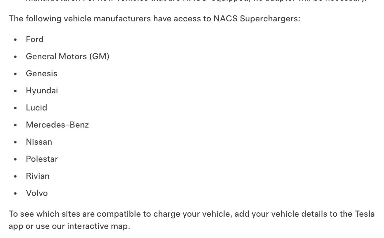

as of right now the Tesla support websites shows the following list of vehicle's allowed to charger at North American superchargers:
https://www.tesla.com/support/charging/supercharging-other-evs#vehicles - VW/Audi/Porsche are not listed…
Porsche Taycan Tesla Supercharger success with NACS adapter! Screenshot 2025-04-05 at 2.54.40 PM
the "interactive" map link is:
https://www.tesla.com/findus?bounds...1864004,36.17943789170034,-123.15919021239004
_IF_ this is working for you - I would suggest it's a glitch/anomaly vs. an actual evolution of the network allowing VW/Audi/Porsche vehicles…
https://www.tesla.com/findus?bounds=37.65717289795217,-120.54444411864004,36.17943789170034,-123.15919021239004
I'm going to head out and see if I can replicate this result locally at my superchargers - I'll report back.

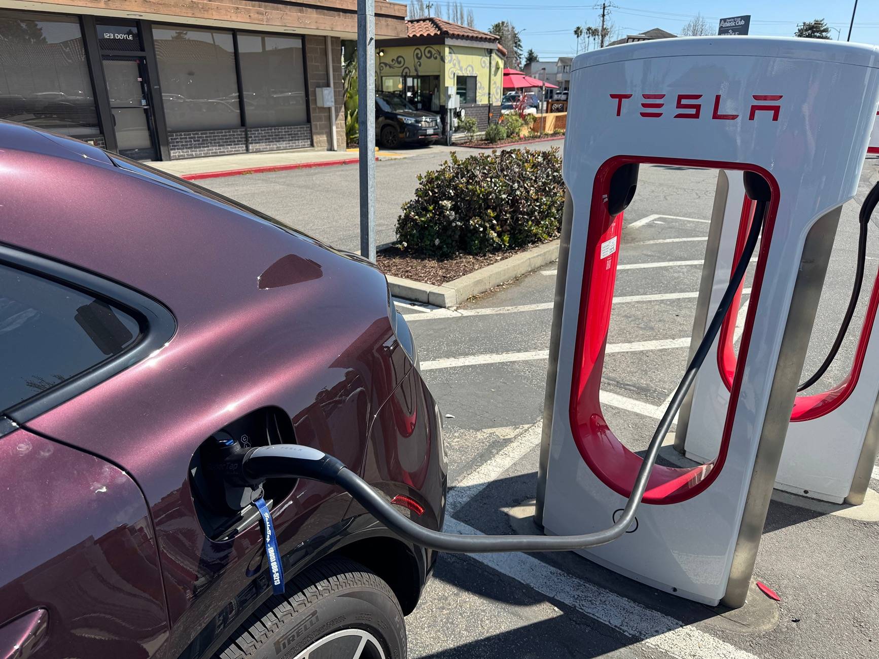

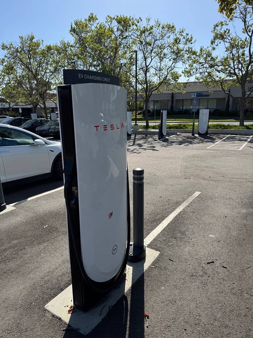

That picture clearly shows a V4 post/pedestal which by definition has an integrated Magic Dock adapter.
If that adapter is activated (which it is not at some small percentage of V4 stations) then a CCS1 driver can use a separate adapter instead of the integrated adapter (which of course is a totally pointless substitution).

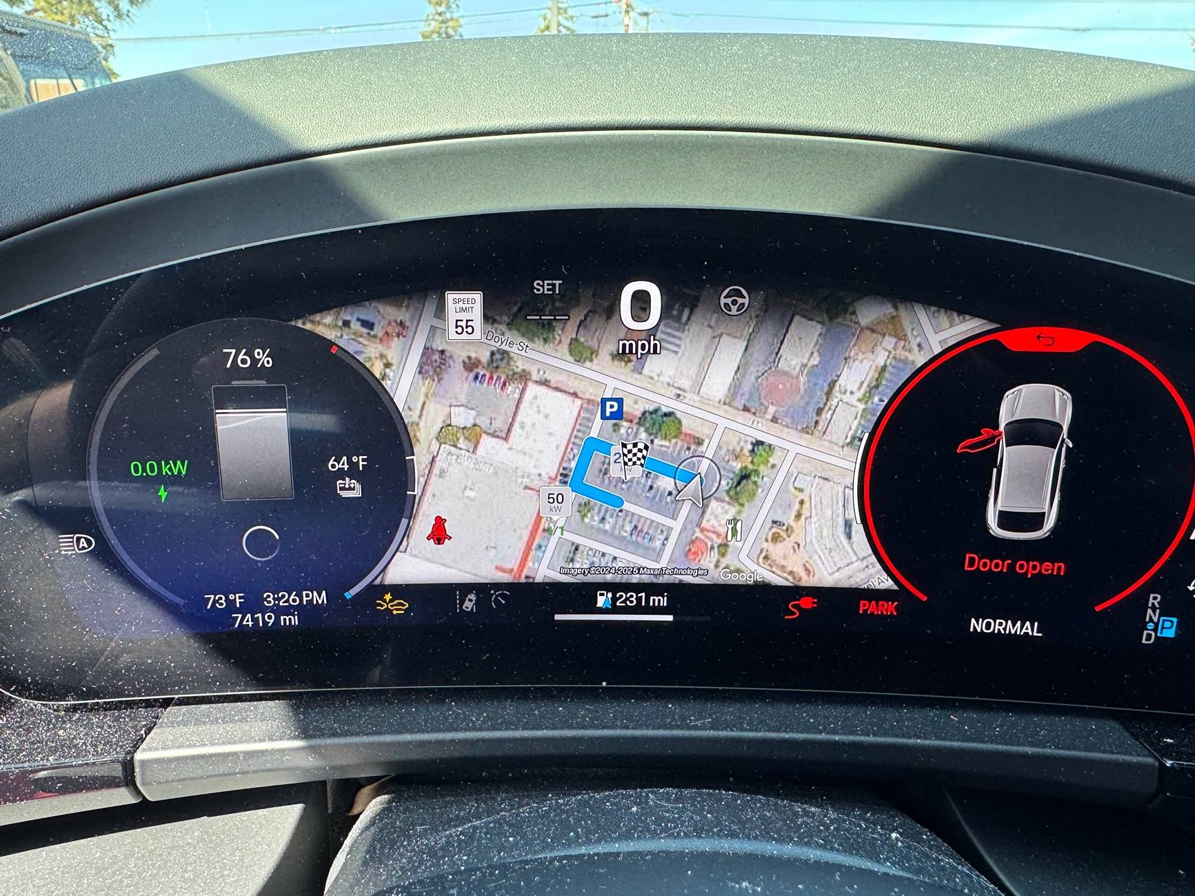

I can not reproduce this result with my 2024 Macan EV Turbo @ 911 Soquel Avenue, Santa Cruz, CA 95062
NO JOY - Supercharger can not be activated for me at this site with a NACS/CCS1 adapter…using the Tesla App to activate stall 1B at 15:30h on this date.
Porsche Taycan Tesla Supercharger success with NACS adapter! IMG_5561
Porsche Taycan Tesla Supercharger success with NACS adapter! IMG_5560
Porsche Taycan Tesla Supercharger success with NACS adapter! IMG_5563

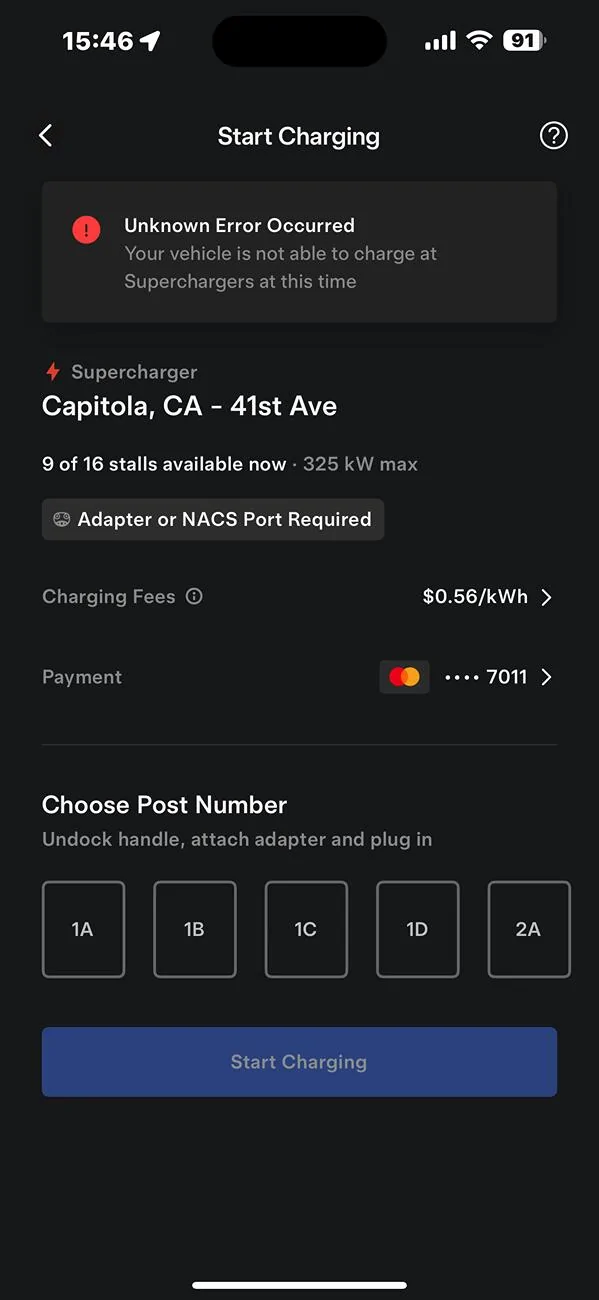

again no joy - I can not reproduce this result at 2001 41st Avenue, Capitola, CA 95010
but I got a new an interesting error in the Tesla app…
Your vehicle can not charge at this time
Porsche Taycan Tesla Supercharger success with NACS adapter! IMG_5564
Porsche Taycan Tesla Supercharger success with NACS adapter! IMG_5565
