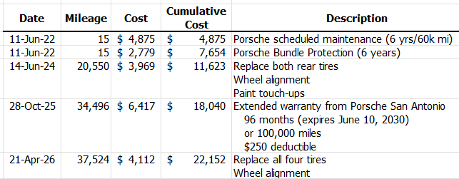

Speaking about 4 years, today (June 11, 2026) is the four-year anniversary of taking delivery on my 2022 RWD. It's been the best four years and 39,000 miles of driving I've ever experienced.
My repair/service expenses (in US dollars) are shown below. Items like registration, insurance, Porsche Connect, Porsche trinkets, and DC charging (I have solar panels and charge at home nearly all the time during peak sunlight hours) are excluded.
Porsche Taycan My 2022 Taycan 4S - 4 years later 1781195857734-pj
For those of you digging in the details, the 2024 alignment at Porsche Chandler was $1,800 while the 2026 alignment at Porsche Arrowhead was $700. Go figure... Also, one of the rear tires replaced in 2026 had a nail and was covered under warranty.

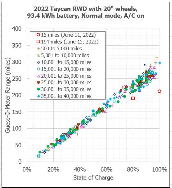

Here's my latest guess-o-meter chart. My dealer (Porsche Arrowhead) charged the car to 100% a couple of months ago, and the guess-o-meter showed 297 miles in NORMAL mode with the A/C running with 37,524 miles. I've got over 300 datapoints here, and the chart is starting to get crowded.
