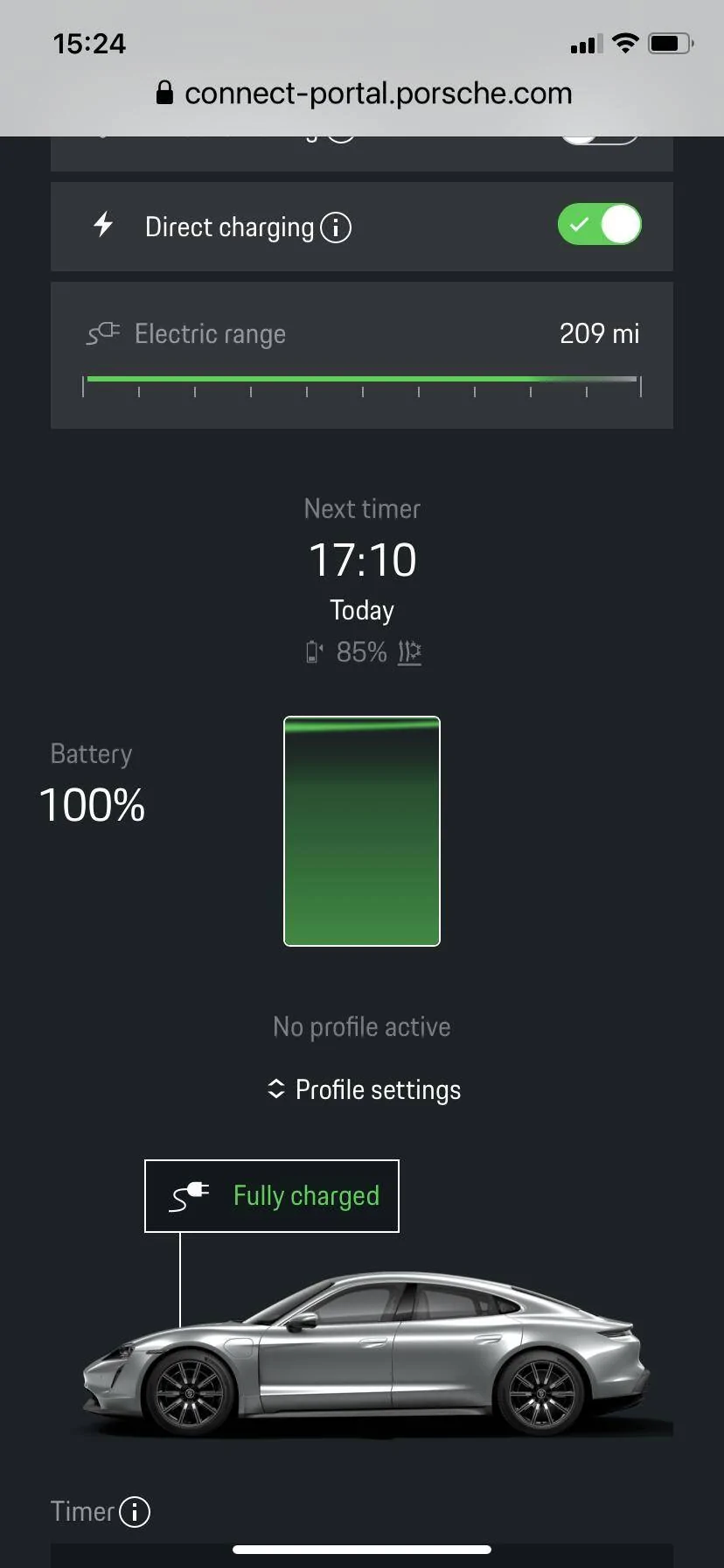

UK 2021 Taycan 4S, regular 79.2 kWh battery. 1000 miles on the car now and 8 degrees C outside.
Did first 100% charge and range was 209 miles.
wow, I too am in the U.K. with the standard Taycan 4S battery and can never get above 160 miles shown on a 100% charge. Beginning to get a little frustrated with the poor battery performance I’m seeing.

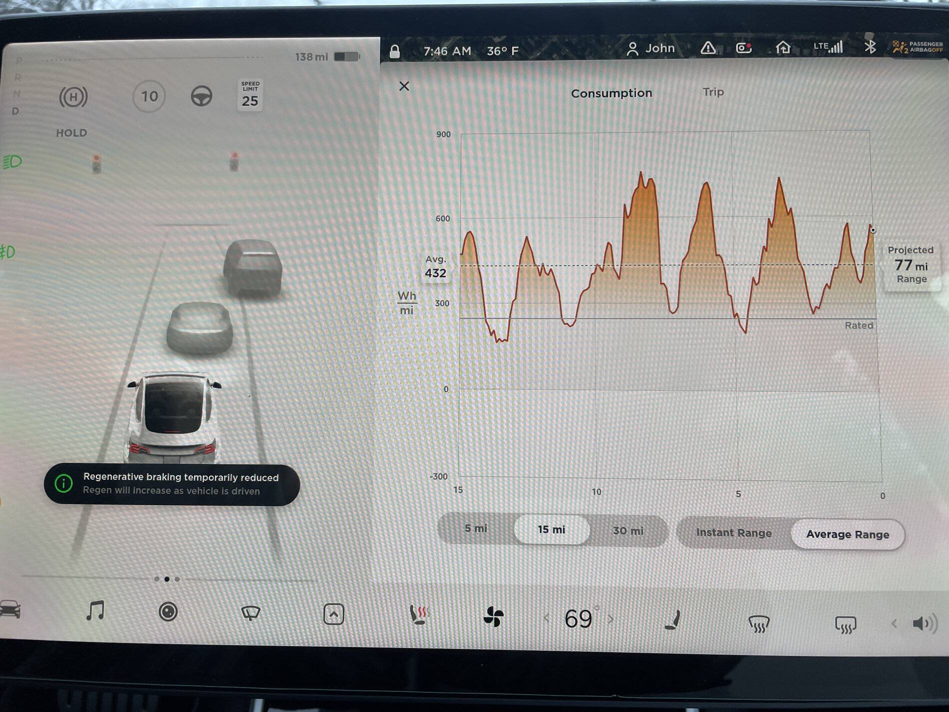

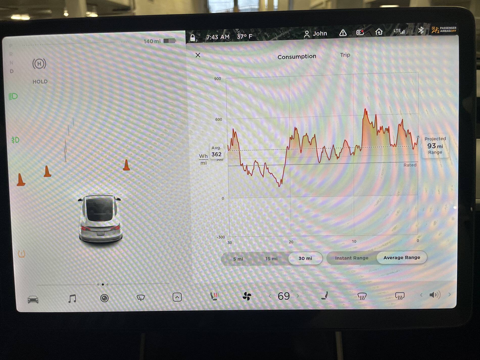

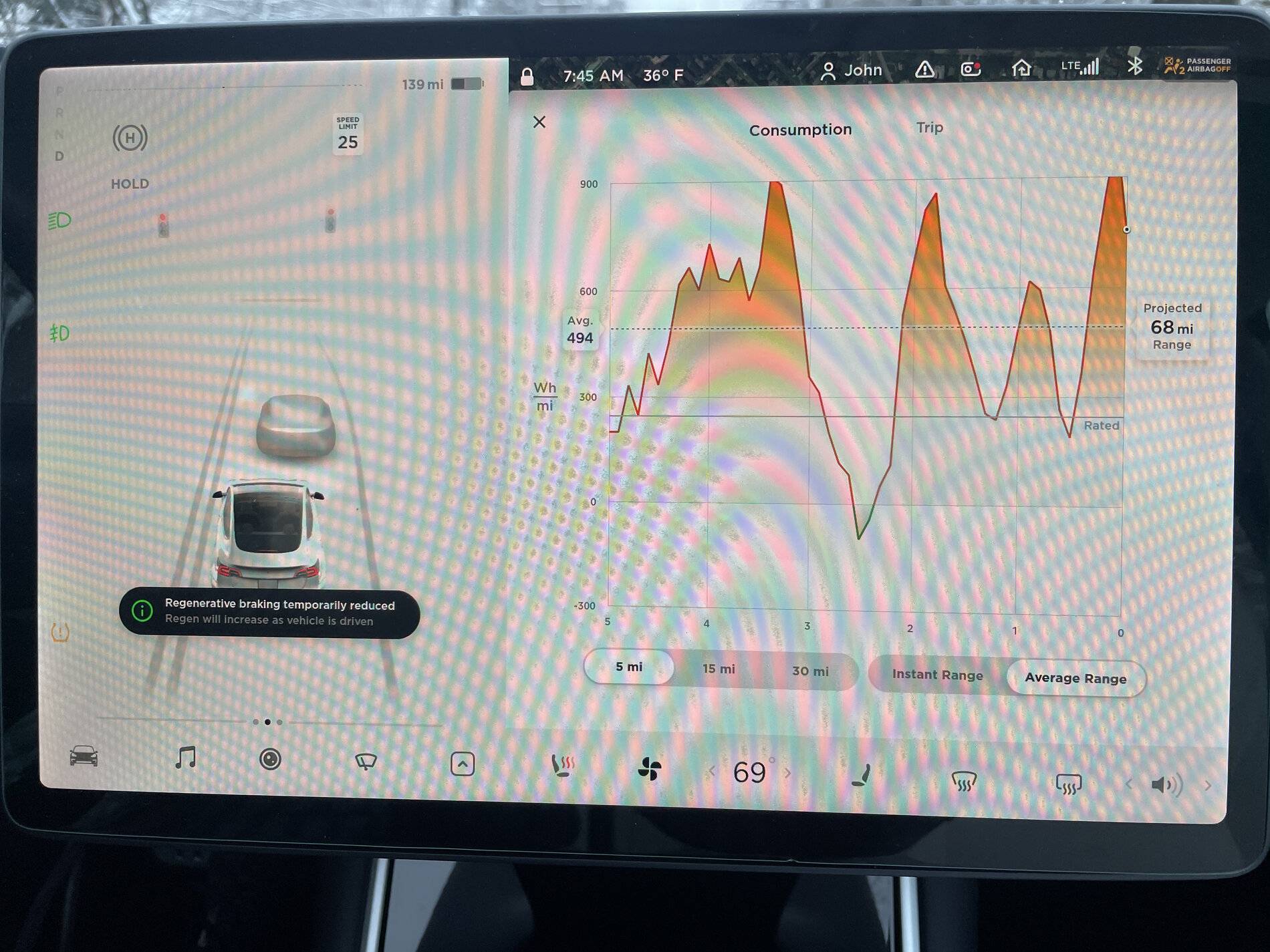

I wanted to share some data for my Tesla Model 3 Performance that may put some of the data from this threat about cold weather Taycan range in perspective.
Due to the pandemic, I have mostly been been doing short in-town/local trips. The weather in DC recently has been consistently in the low 30's F/upper 20's F, and we have had 3-4 inches of snow from the recent storm that is currently hitting the NE. The car is parked in an unheated garage, which normally is 10-15 degrees warmer than outdoors. Today the outdoor temperature when I took these photos was about 32 F, the temp on the screen in the car of 37/36 F reflects the fact the car had been sitting in an underground garage at the supermarket for about 30 minutes before I took these pictures. The M3 does not provide any way to know the battery temp, but I assume it is near or at the garage temp when I start each trip.
Below are some screen shots I took today showing the 5, 15, and 30 mile average consumption and estimated range based on the actual consumption, versus the "rated range" that the car shows in the upper right corner of the driving information on the left side of the center screen. The interior temp was set to 69 degrees F and the driver seat heater is on. The car has 19" aftermarket T-Sportline wheels and all season tires.
The first image shows the 30 mile average (several short trips and one trip earlier in the average that included some highway travel at 65-70 mph). Note the rated range is 140 miles, but the average consumption is 362 Wh/mile and the projected range is only 93 miles.

The second image shows the 15 mile average consumption of 432 Wh/mi and a projected range of only 77 miles (note, all these images were taken in succession, they are simply showing differing amounts of "last" miles traveled). The 15 mile segment eliminates the highway trip noted above so this is all short city stop and go driving (several different trips). So, in the cold, the car is achieving about half of its rated range.

The final image shows the last 5 miles average consumption of 494 Wh/mi with a rated range of only 68 miles. These 5 miles include two short in-city trips (including the one today to the supermarket). Under these conditions, the car is achieving well below 50% of its rated range.
Of course, it I were to take the car on a longer trip at highway speeds, the average consumption would be lower and the projected range higher.
These data show that even Tesla achieves much worse range in cold weather.
I have a 4S on order. In the real world under different conditions, I expect my range in the 4S with 20" wheels and all-season tires to be comparable to what I have experience in my M3P. While the MS is rated at up to 400+ miles, numerous highway comparisons (e.g., Car and Driver and Tesla Bjorn) have shown the actual real-world range for the two cars are very similar (accounting for the larger battery in the Tesla, Tesla Bjorn's data showed about a 5% greater efficiency for the MS Raven over the 4S (on 19" wheels).
