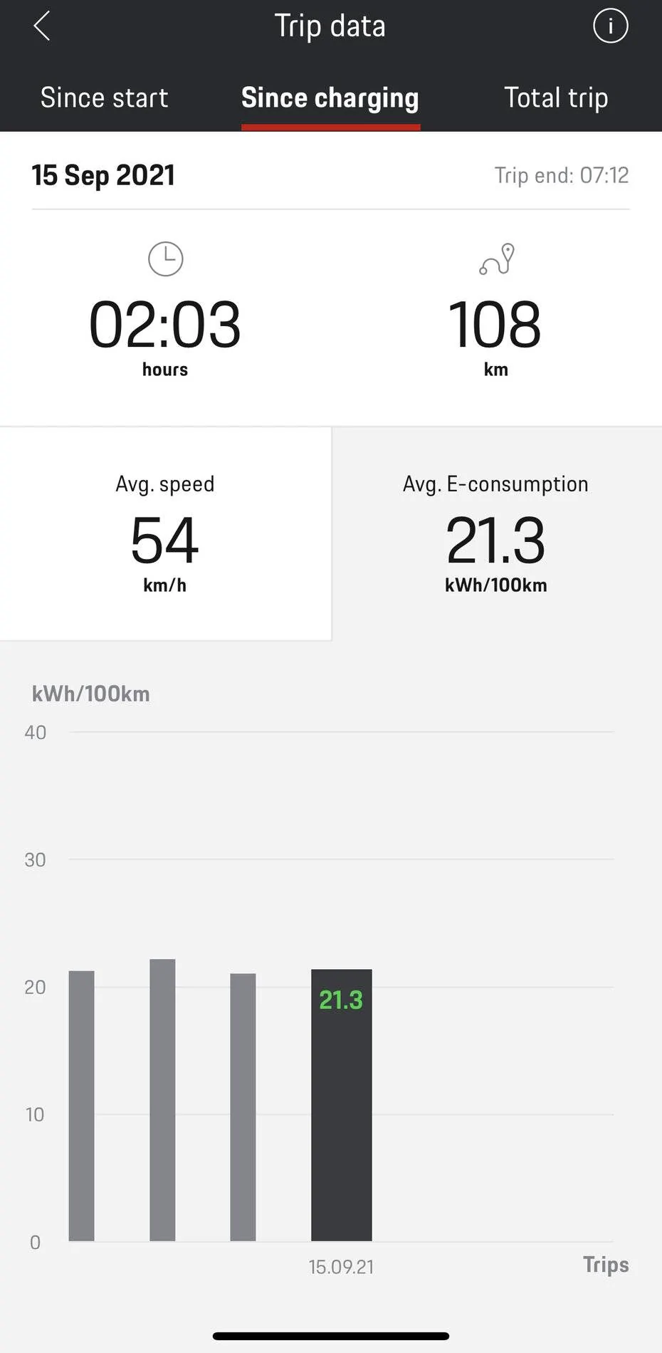

I live in Toronto and I have found that I rarely get more than 170 miles on a full charge. I have the Performance battery plus version. I usually keep the car on regenerative and rarely use the seat heaters. Any suggestions on the disparity of range compared to other postings? . I have seen many postings of 200 miles plus. Can the cold weather have anything to do with this?

1500 miles on my 4S now, 79.2 kWh battery and showing 217 mile range at 100% battery. It did drop to 214 after about half a mile.
That looks pretty good but is predicted range not actual range. Surely the best estimator of real range is the trip data showing the kWh/100km and extrapolating for the 83.7kWh useable battery capacity
Porsche Taycan 4S Range is never more than 170 miles on a full charge. 606567BF-9022-4297-82DD-B4709C5EA4EA
