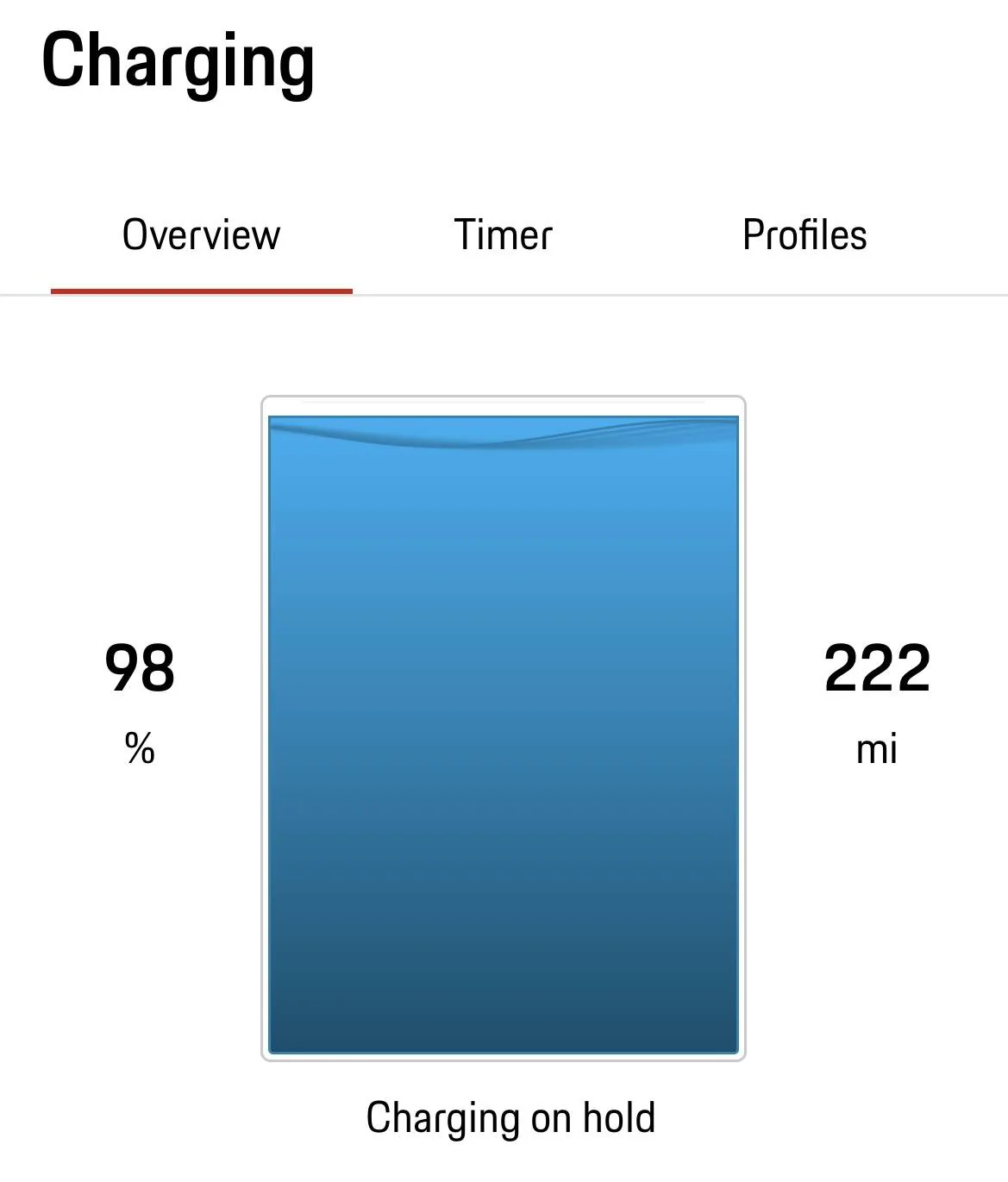

Is 100% full charge of 188 miles the best I can expect on my Taycan now or can I somehow improve this?
In the MyPorsche app, go to Vehicle > Details > scroll down to All trip data > select Total trip.
What does it show as your Avg consumption?
hifi239
Will
Mar 15, 2023
196
161
Boston
RWD, small battery, 19” Aeros, cold weather is starting In Boston. No I don’t usually charge this high.
