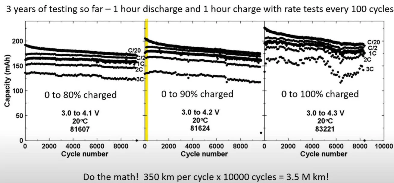

Here is a link to a presentation of the new battery he has been involved with.
Thank you!
25:00 Exactly supporting my argument! I get almost 400km range every cycle. My driving profile is about 10000 km per year. I expect to own the car for about 6 years. Therefore, I need about 150 charging cycles, which is just the highlighted area. Will I be able to even notice degradation?
Porsche Taycan OK to full charge to 100% regularly? 1604997815725
I picked the 90% charged because realistically, I will charge from 5% to 95% in relation to the gross capacity of the battery, not the available net capacity.
