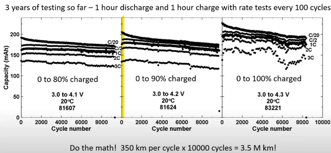

Correct, but that's Porsche's interpration and offcourse they tested it, but if you look at the test review that stated that a 80% charge when using the full capacity battery shows almost no degredation with 10.000 cycles.
If the degredation is minimal why unneccasary extend the lifespan of a battery/vehicle that would never make those miles.

The main discussion here is the range you get out of your Porsche. It already was a big topic when the Taycan was introduced and the first results came out.
If you add everythin up it looks like you could get a lot more miles out of your battery, but Porsche doesn't provide this. I'm just trying to understand why. Maybe they first need to have the pratical data of reallife usage of the car, or it's a safety measure for the battery.
Please remeber that the graphs shown here are from Jeff Dahn, and reflect the new Tesla Batteries, not the present generation batteries in Taycan.
