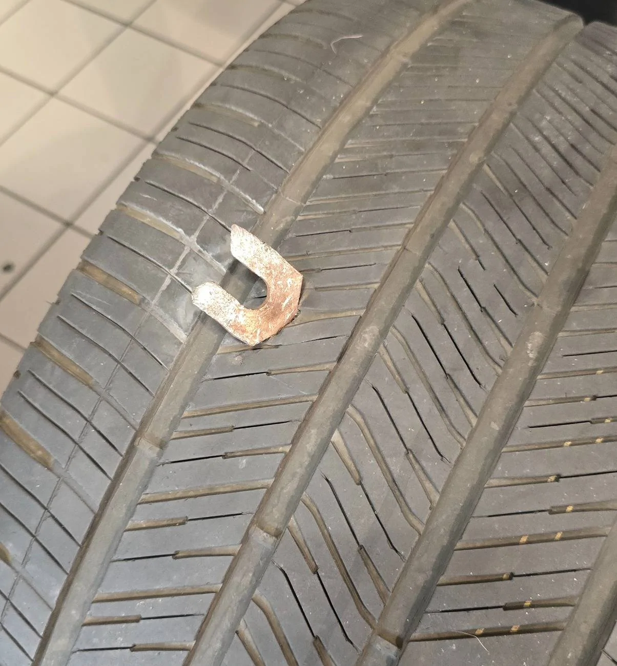

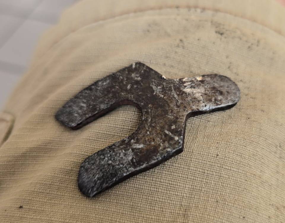

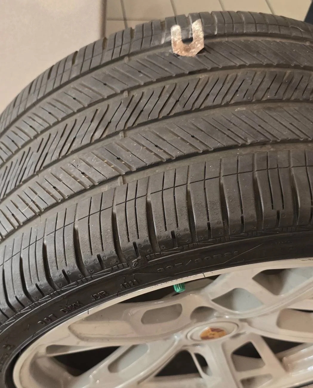

The first one was 1 week after delivery. Sidewall of the front passenger. Unfixable. Ended up getting two Continental ProContact RX since they were a little cheaper than the GoodYear and getting one tire when the other had 5k miles on it didn't seem wise. I can't tell the difference when driving or cornering hard.
Now, I got a flat in the driver's rear 6 months later. They said they wouldn't advise repairing.. what do you think?
Anyone go up to 325x30x21 in the ProContact RX. They have no GY in stock. 305s are in stock but wondering if anyone went to to 325 without issue.
Would you replace two or try and patch this? With all the flats I'm getting, might be worth getting two new ones with a road hazard warranty but would rather not drop a grand today.
Discount Tire said due to the weight of these EVs they are more prone to getting flats. Anyone else get more than 1 every couple years?

I got two flats during the first year of ownership. I bought a used Cayenne collapsible spare and didn't have a flat until last month where I got two screws in the same tire, not repairable.

A hole there I would patch, or even plug. Not sure about such knife like cut like in the picture. I picked up a screw on 2nd day after delivery of my brand new Taycan, on the way home from the dealer. I plugged it, then drove home over 3,000 miles, used it for the reminder of winter that year, then 2 more winters since, no problems. These are winter tires, unlikely to do a track day with those, so don't foresee any issues. If I had the itch to take it to the track in the winter, would put on the all seasons for that weekend.

I agree with the shop a puncture like that is not repairable, a nail or bolt sure but that looks to be a 1/2 inch slice and I wouldn't trust even an internal patch on that. I also had 2 tire punctures within my first 2 years of ownership (1 nail & 1 bolt) and had both of those plugged with no problems.
