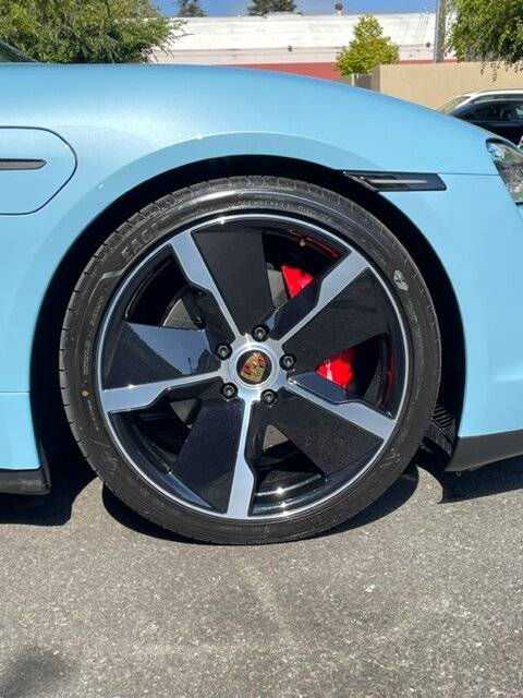

Also a factor may be that you were in Sport Plus which lowers suspension and stiffens it. This makes for less bump compliance with reduced wheel travel and stiffer suspension. The blow transmitted to the tire is much more violent. Had you been driving at normal height with suspension in Sport (normal is too soft in my opinion) you maybe would not have sustained a blowout. Also, from my racing days, a softer suspension and normal height always helps in very wet conditions and makes the car more controllable or predictable. As for range mode, it also lowers the car although the suspension is on the normal stiffness without the possibility to change it.

It's been raining in CA and while on the freeway, I hit a pot hole and my front passenger tire got a flat and had to be replaced. A month later the same situation happen to my front driver side wheel and tire had to be replaced. Has this happen to anyone else? Is it the fact that my wheels are too big and the car is super heavy so when you hit a pothole it blows your tire up? I'm hoping this isn't going to be a common issue.
My car info:
  • My car has the 21" Taycan Exclusive Design Wheels (The ones that look like big fan blades) Pic attached of my wheel pristine (not flat)
  • All season 21" tires
Incidents:
1) Flat tire #1 - Driving on a freeway in Sport Plus mode going 55mph, hit a pothole and instant side wall blowout on front driver passenger wheel.
2) Flat tire #2 - Driving on a freeway in range mode going 80mph, hit a pothole and instant side wall blowout of the front passenger wheel.
Anyone else have this happen? or ideas or advise?
Suspect (given the drive mode Sport Plus) that the lowered suspension and stiffened shock absorbers will not have provided sufficient headroom to absorb large bumps at speed. Situation will be amplified on 21" wheels and little rubber to play with.
These are my guesses only. Also I wouldn't drive in Sport Plus on a motor / freeway and save it for country roads.

Here are my learns. The 21" I have now did not do well with a big pothole going at high speeds in Sport Plus Mode. I think the larger wheel, with less tire, the weight of the car, and sport plus mode tight suspensions made the side wall of the rim cut the tires sidewall when it impacted the potholes sharp and deep edge. I don't think 22" wide tires will save you, infact probably increase the chance of it happening, My learn, don't drive in sport plus mode on the freeway at high speeds LOL.
