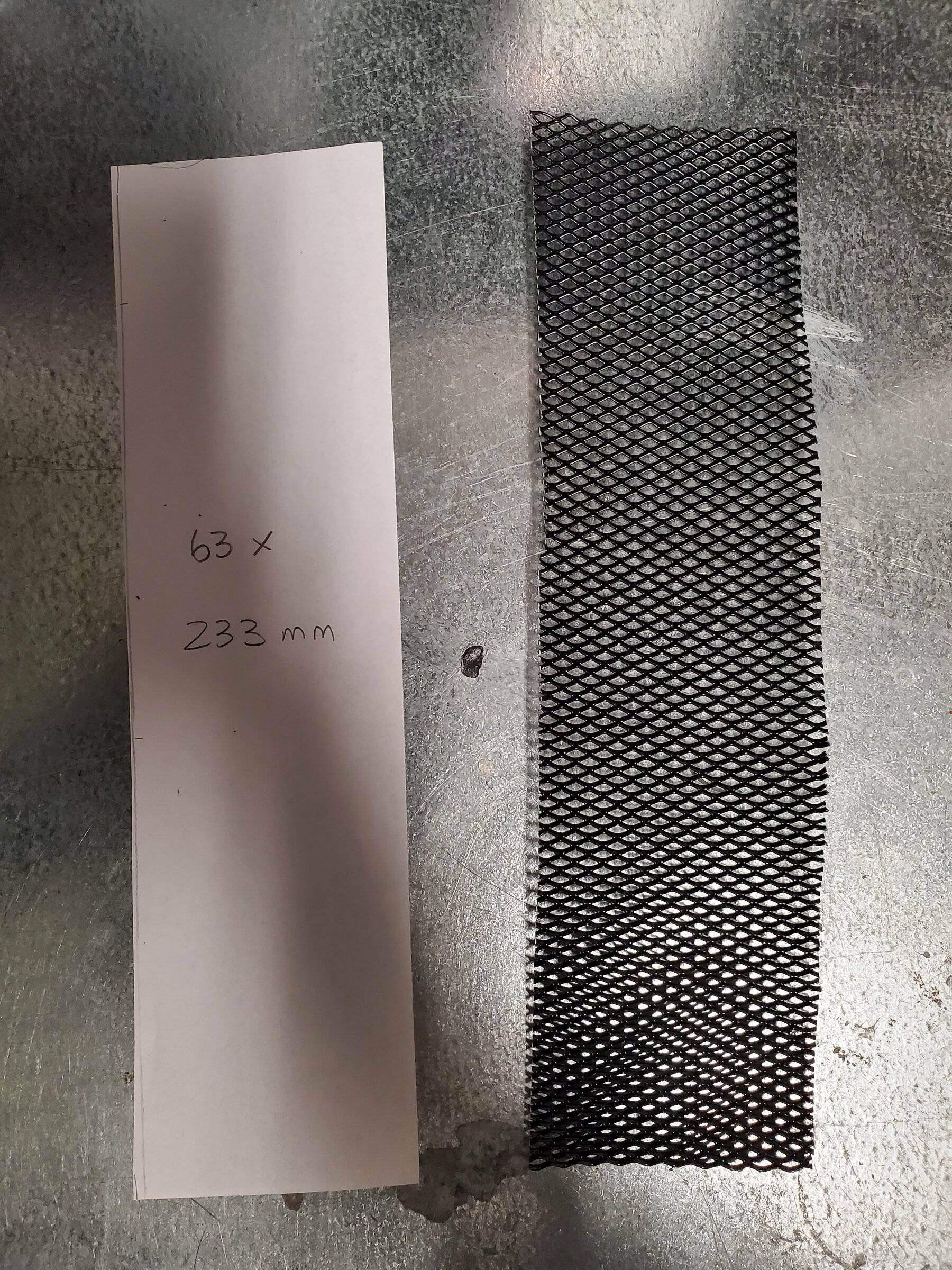

I think when discussed previously the loss in range would only probably be a couple of %.
I went with the mesh option - following instructions posted on here.
Really pleased with it. Very tidy job.
If you cut them the right size (pic) and buy the right mesh, there is a recess that they just slot in to with a little bit of bending and encouragement.
I used a pencil with a rubber on the end to tease them in.
