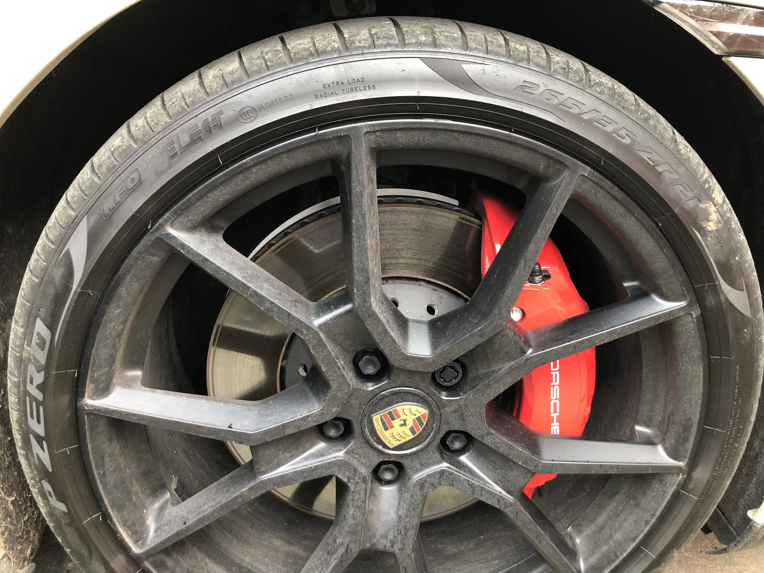

Ross
Ross
Oct 27, 2021
655
862
Lancashire
Taycan GTS - Audi Etron

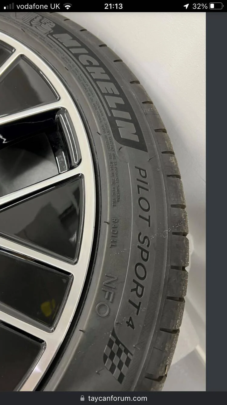

Michelin PS4S are not N-rated. I will absolutely fit them (again) soon when the P-Zeros on my GTS burn up.
These are the recommended fit summer tyre on every UK Taycan I have seen with 20’ wheels.
Michelin Pilot Sport 4. NFO.
Porsche Taycan Anyone tried 265/30 21" front tires ? 7D667891-A3C1-4EE4-A3ED-B1DE0625376B
Think Derek is talking about Pilot Sport 4S, vs Pilot Sport 4. The 4S is a more aggressive "full" summer tire, while the 4 is more of a mild summer tire / 3 season tire. I have the OEM PS4 on my Taycan and has noticeably more grip in the cold-ish (40 degrees F) than PS4S I've had in the past on other cars, but also less grip in warm conditions.
Regarding the Porsche NF0 spec, it's not so much of a safety thing as much as potential advantages (often minor) that come from the tire manufacturer working with Porsche. Hard to tell unless tested side by side, but it's possible for example the NF0 PS4 has lower rolling resistance and better range than a standard PS4. But there's no reason a non-NF0 tire isn't safe as long as it has the right load and speed ratings.

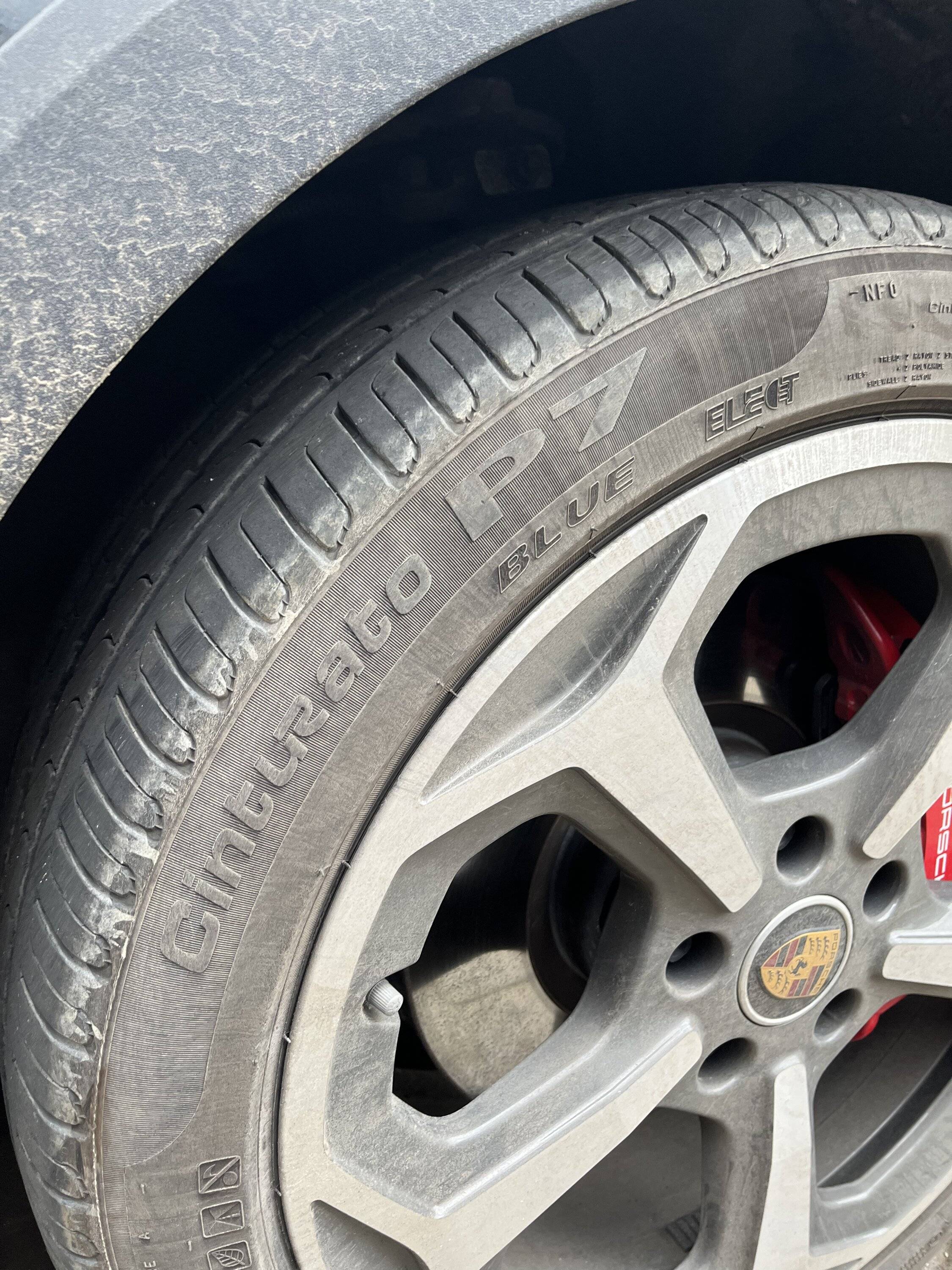

BigBob
Nov 27, 2021
1,959
1,533
Not what I got on my 20 incher.
Porsche Taycan Anyone tried 265/30 21" front tires ? DCA657B7-2072-4FB4-AC63-0988EA70B85F
I'm following @DerekS here and I ordered Michelin Pilot Sport 4S tires for my new 21" Signature Wheels. I'm hoping they come in soon.
I had spec'd 20" all-season tires for my CT and I got the H-speed rated Pirelli P7 All Season tires. Not a fan of this tire and will definitely get something else when the time comes.
