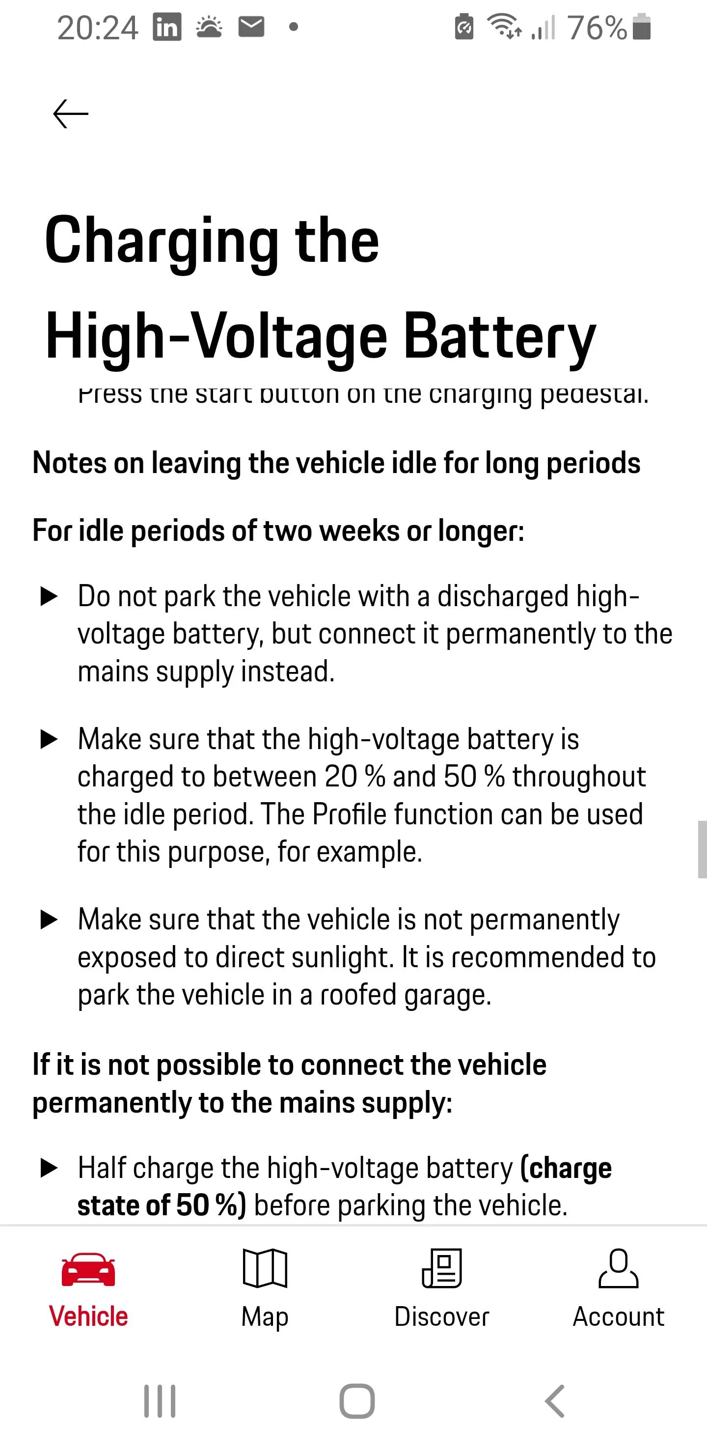

owner's manual says leave it plugged in - doesn't say it will trickle charge - I agree with leaving it plugged in.
it will charge on/off to maintain profile settings, but power will not flow continuously - when profile drops out of "range" car will charge according to profile at full power - given Taycan's limited vampire draw I would expect it to almost never charger after initial charge from 1st plug in
when I left town for 3+ weeks I left my Taycan plugged in to PMCC - when I got home I looked at the charging logs - it charged ONCE during that 3 week period, and battery percentage was exactly where I left it from initial plug in - 85%…
