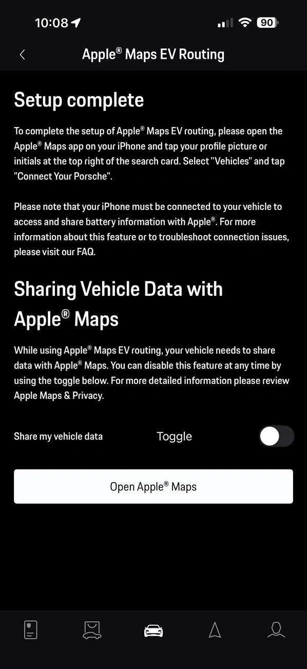

Porsche Taycan Apple Map EV Routing not getting enabled IMG_9300
I don't have the toggle enabled but still works just fine for me.

In this video at 0.37 timestamp there is an option displayed "Share my vehicle data" and it is toggled to enabled. I am (and few others on this thread) not able to toggle that option to enabled and that's the exact issue I am reporting in this thread.
I can't toggle it on in the My Porsche App either, however the option to share data is set to on in the Apple Maps app.
Same here, strange but it works. If only we could pre-heat the battery manually like other cars do in the VW group stable.
