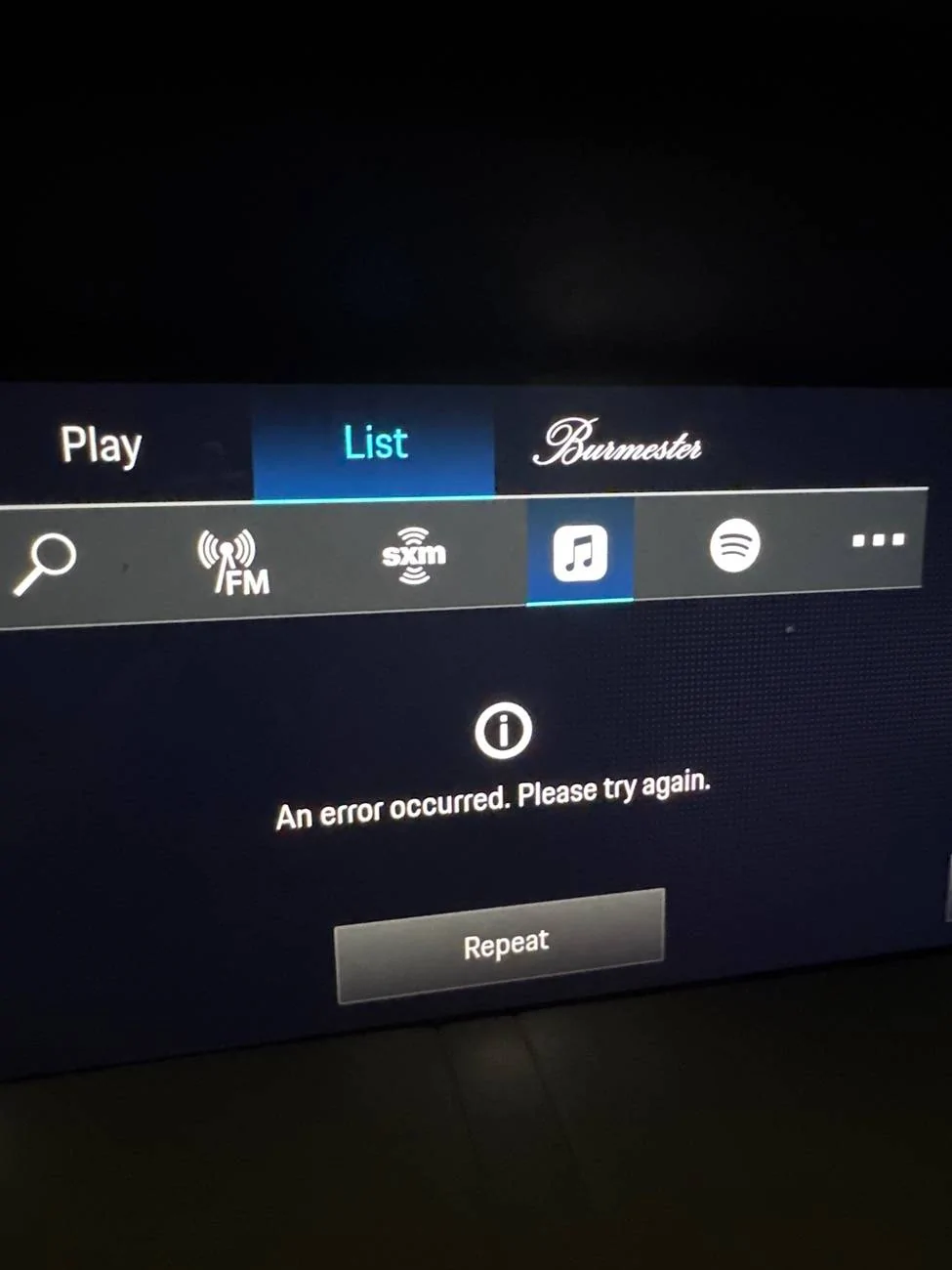

Apple Music + PCM worked fine for months and stopped working for me one day.
The error occurs when trying to fetch the list of songs.
“Error. Please try again”. And hitting the “repeat” button logs me off and puts me into a registration step.
After registration , it errors out again when trying to query for songs.
things I’ve tried
- reset PCM to factor setting
- logged out and logged into my account
- unlinked within Apple Music setting on my phone
- went and deactivated and activated Apple Music contract within the car under connected services
Any help appreciated
In the UK…
Having the SAME exact issue. Tried everything, resetting, unlinking account, reboot PCM, removing Porsche account from iPhone…. Nothing seems to work.
iPhone says Linking successful but PCM keeps looping with the same error.
Going on for over 10 days now…

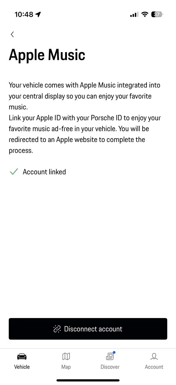

Had the same issue. I hope the steps I used to fix this issue on my end is helpful to you.
  1. Go to My Porsche phone app.
  2. Tap Vehicle Details.
  3. Overview Functions Owner's Manual now shown on top. Select Functions.
  4. Scroll down past "Charging", "Pre-Climate", "Alarms", "Apple Maps EV Routing", "My Porsche in Apple CarPlay", and select "PCM Services".
  5. In PCM Services, select Apple Music and follow the rest of instructions to link account. The image below is a screenshot showing that now my Apple Music account is linked, as is Apple Podcasts.

I had tried these exact steps as well.... and nothing worked.
The issue was at the Porsche back-end servers, and since that has now been sorted (for now !!!), Apple Music/PCM now works...
Regardless, thanks for the input... It may be helpful in some other circumstances.
