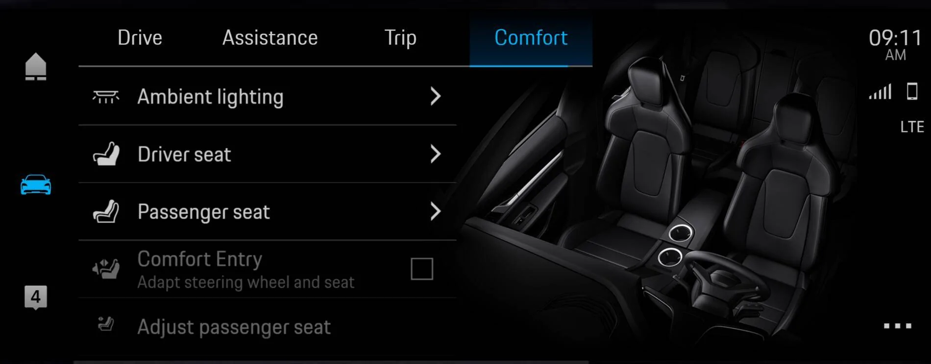

My question is about Comfort Entry - it does not move the steering wheel, and should according to the manual. Is there a TSB or software update I can point my dealer to for correcting this?
(Or, hell, if you can fix it I will bring it to Grapevine)

Have you checked all comfort settings in the PCM - in particular Comfort Entry? Wheel should raise, seat retract on power off and door open, and on door close seat should move, along with mirrors, steering column (assuming you have 14 or 18-way seats).
Yep all of that is on but the wheel does not move forward on exit. I have to do it manually.
The seat does move back though.

Random thought - try the other key - if the same then sounds like there's a fault.
Yeah someone in another thread said they worked with their dealer who worked directly with German engineers on a software fix.

Might be obvious, but is your current wheel setting already at it's highest for comfort entry/exit? I noticed this on my Range Rover, since it was already set close to what the exit setting would be, it barely moved when I enter/exit the car. I'm assuming they all work on the same thinking that all it does it really change to a preset setting that moves seats all the way back, and steering wheel all the way up. if it's already at it's most up position, there's not more movement.

I think he mentioned that he had to move it manually therefore suggesting it wasn't?
