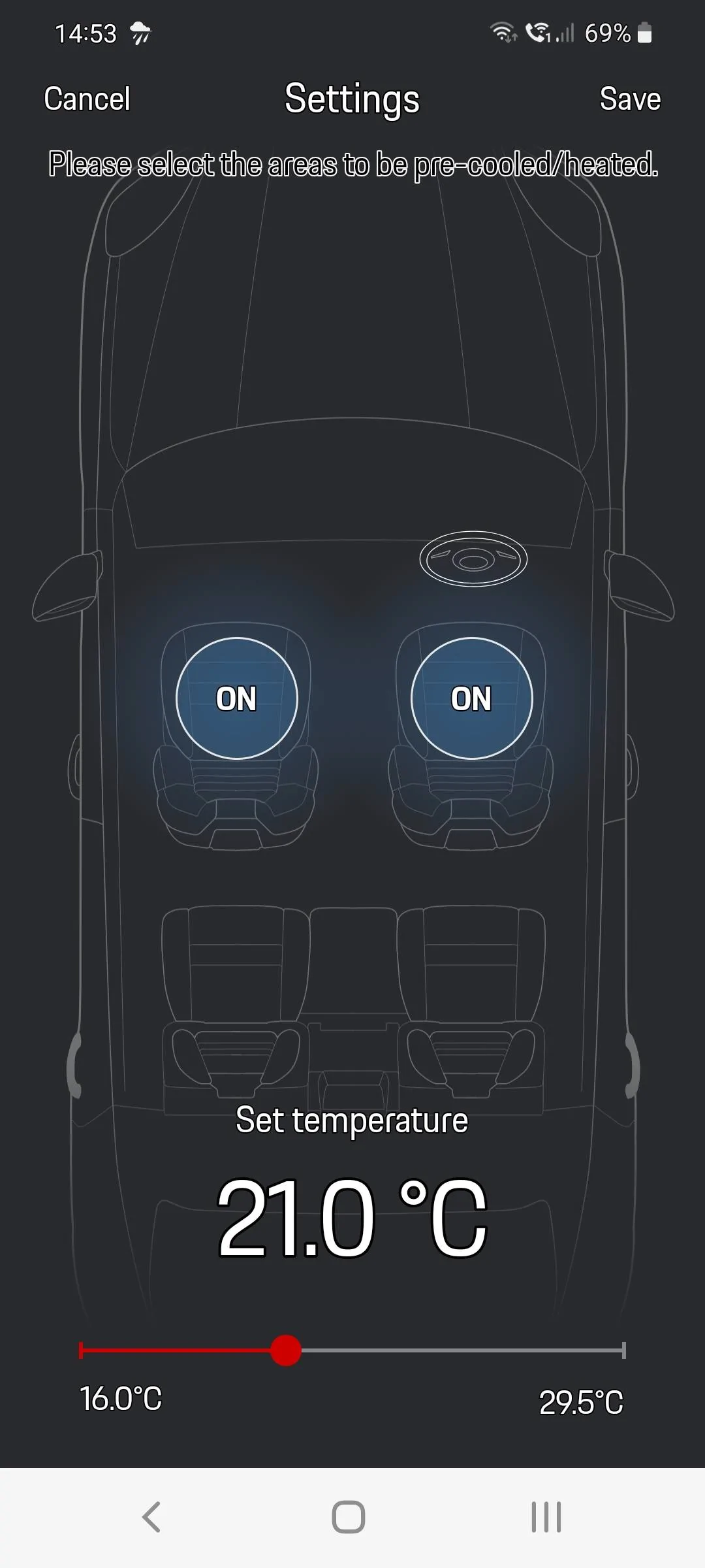

I would imagine the precool / Preheat is either turned on in a Timer, or turned on for when you unlock the car.
And from there you can select if / which seats you want on as part of the process.
Try turning the precool / Preheat off on both.
I am still using the old PorschevConnect app.....
Porsche Taycan Auto seat heating when turning the car on Screenshot_20220209-145354_Connect
Porsche Taycan Auto seat heating when turning the car on Screenshot_20220209-145405_Connect

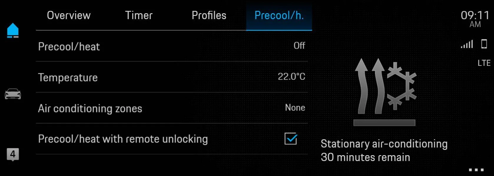

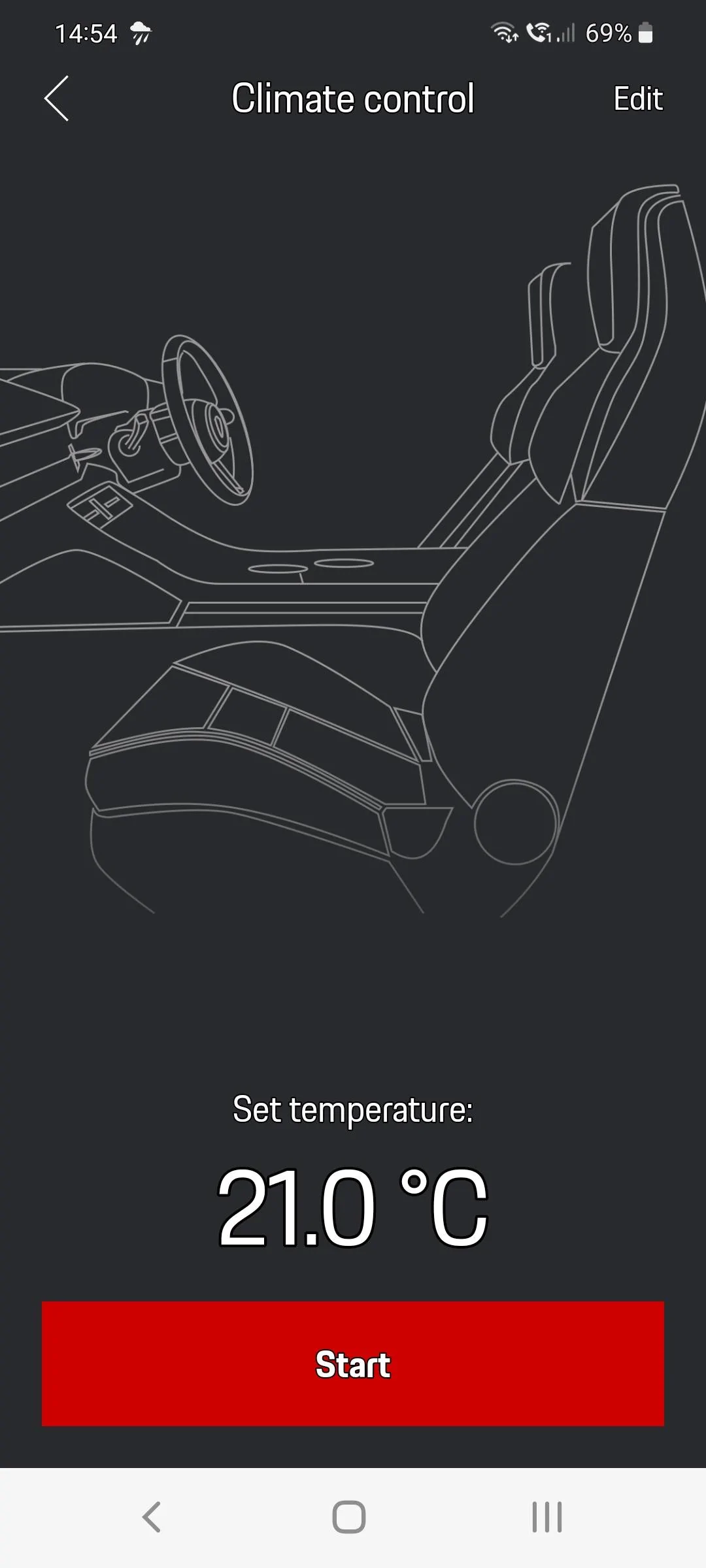

The new Android app Preheat section doesnt have temperature or seats in it. Just a slider for Aircon on/off. And I cant find an equivalent setting on the car either. And thts my problem :)
11,017
6,805
PCM - it is buried in there.
11,017
6,805
I know I'm likely stupid but I cant find the setting.
When I turn the car on, the passenger seat heating turns on. I dont think it happens every time. And I can't work out the pattern. But I cant find where to tell it stop.
Where is the setting hidden?
Thanks in advance
See bottom option:

Do you have preheat on remote door unlocking enabled - sounds like you do which explains this behaviour which varies with ambient temps etc?

I might have answered my own question this morning.
I tihink the passenger seat heats when you select the 'Passenger side air conditioning zone'. Not that this makes any sense, but I have told the car only to use Driver side air conditioning zone and the passenger seat heating didn't turn on this morning.
If thats the case, its just bad labelling in PCM.
