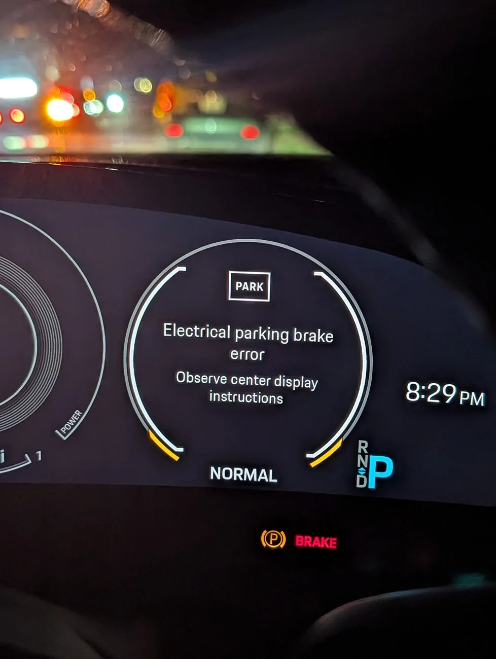

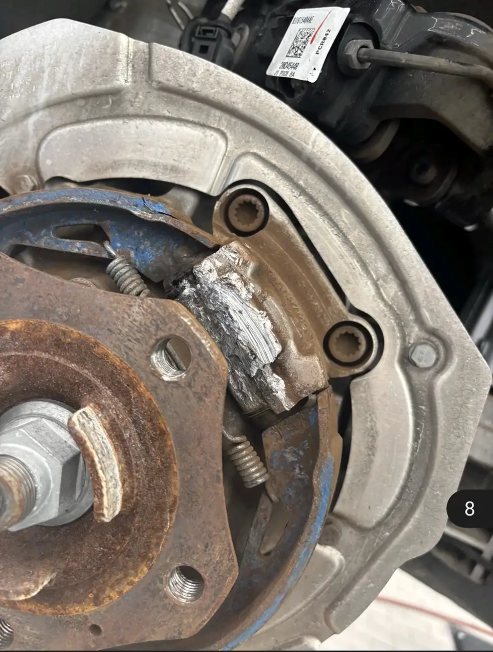

I've had a lot of drama around getting two wheels replaced along with the rear parking brake, and I'd love to get some opinions. A few months ago, I hit a series of potholes at about 40 mph in my 2021 4S, which amazingly ended up bending both passenger side wheels and destroyed the rear parking brake.
My local Porsche dealership quoted me about $5k for the wheel replacements and $6k for the parking brake. After going back and forth with my insurance, who claimed the parking brake damage was unrelated and was a "manufacturer defect", I had to concede to paying for that out of pocket.

I can’t make out what happened to the parking brake assembly, it does look like a catastrophic failure, not sure how that is related to the pothole incident, but I suppose it is possible it was such a hard hit it obliterated the rim and shocked the parking brake shoes loose.
Might be reasonable to check for other damage as well, bent subframe, control arms, etc.

Bent Wheels and damage to Parking Brake all related as it looks damaged from the impact.
Mission E wheels are known to come only in gloss black and need to be matched to the original color.
Bottom line: Insurance should pay for wheel replacement and brake damage. If the tires have been replaced since OEM then usually they come with road hazard replacement coverage, since you did not get the wheel/tire coverage. Pretty sure dealer sold wheel/tire coverage would have covered both. I understand the argument they give that if the tire still holds air it is not approved, but if the tire is on a bent wheel then the tire is total loss.
Parking brake: when did insurance become experts on the parking brake design to call it a defect. They need to prove it that it is a defect through Porsche TSBs or other NTSA reports.
