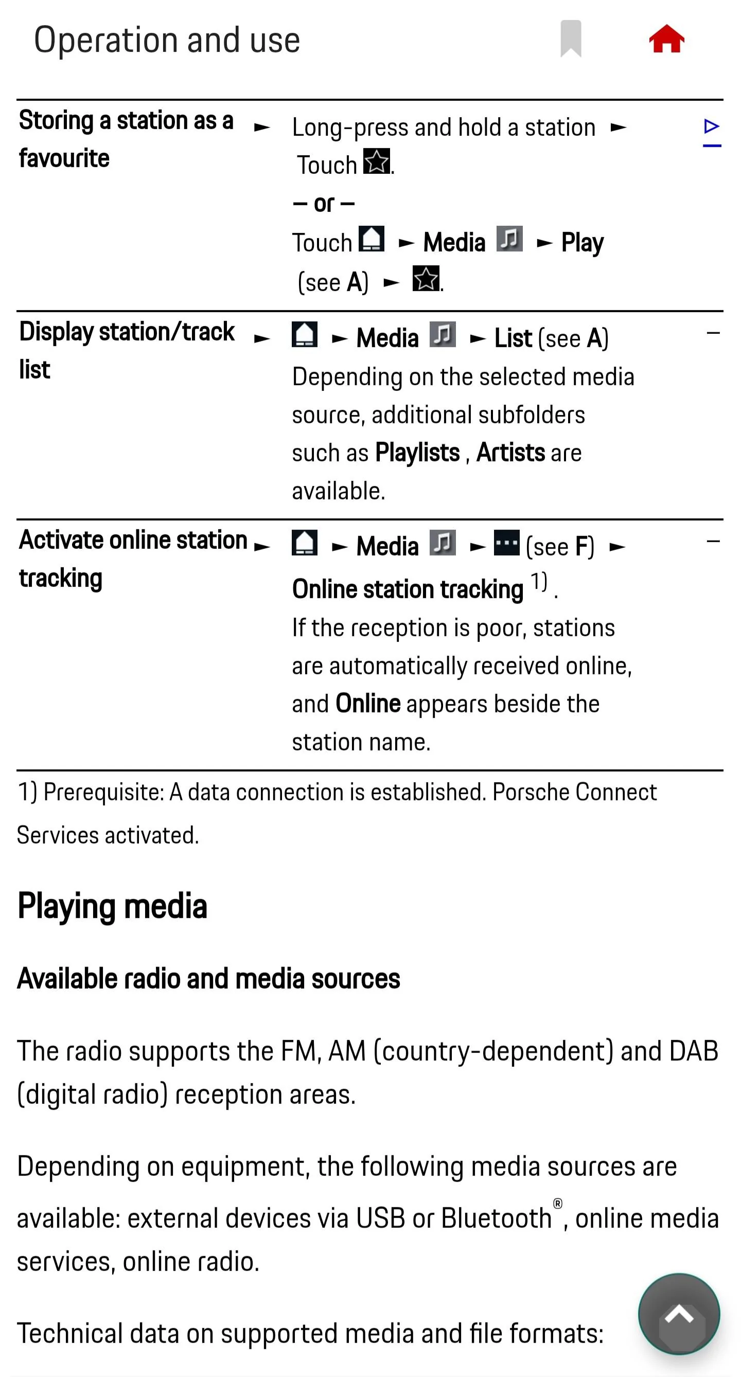

I think it is just coincidence. Kaluza users are noticing the loss of LTE because they rely on it for charging at a discounted rate. Others maybe not so much if they set timers and profiles in the car or have a recurring timer set in the car or by the Porsche App.
Im not so sure on this. I agree I’m studying LTE now but unless I’m mistaken does DAB radio not get lost with no LTE? I have my display set to show dab and immediately noticed the loss as you just get a grey box with a line through it. I’ve never seen this in 2.5 years and I drive my car daily, until I lost LTE for 2 days, just one week after activating charge anytime?? Seems too much of a coincidence to me, and everyone’s who is on charge anytime is all of a sudden having LTE issues and needing to book into dealer?!
Speuk
Simon
May 6, 2022
1,154
619
Im not so sure on this. I agree I’m studying LTE now but unless I’m mistaken does DAB radio not get lost with no LTE? I have my display set to show dab and immediately noticed the loss as you just get a grey box with a line through it. I’ve never seen this in 2.5 years until I lost LTE for 2 days, and one week after activating charge anytime?? Seems too much of a coincidence to me, and everyone’s who is on charge anytime is all of a sudden having LTE issues and needing to book into dealer?!
DAB radio and LTE are completely different....
LTE is broadcast from mobile masts.
A number of frequency bands are used for 4G LTE in the UK. There's the 800MHz band, the 1400MHz / 1.4GHz band, the 1800MHz / 1.8GHz band, the 2100MHz / 2.6GHz band, the 2300MHz / 2.3GHz band, and the 2600MHz / 2.6G
DAB broadcasts on frequency block 12B (225.648 MHz) from the BBC's transmitters.
So I'm not sure the loss of one can be linked to the loss of the other

ok, happy to stand corrected. Just seemed odd the day I lost LTE, I lost dab for first time in 2.5 years of ownership.
Just thinking, but if the DAB frequency was poor would LTE as an internal SIM card source not kick in and bridge the signal gap potentially on a different network? Therefore I could have always had poor DAB frequency unbeknown to me being covered up by LTE connectivity?
Ah, you may have a point. You might have been receiving online radio?
Porsche Taycan Best electricity tariff for EV switching today Screenshot_20230510_222529_Porsche Good to kno
