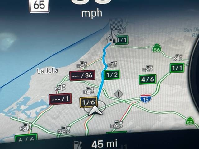

Can someone decode this map for me please?

You suggest red means out of service, but it shows 36 stations at a big mall near us and its in a red box. Surely 36 stations are not out of service. I am assuming ---/36 in red means, basically, "we have no f*cking clue how many may or may not work, you are basically on your own." Would that be the proper interpretation? I am glad I charge virtually always at home!
I did actually mention that red might also indicate occupied (see comments at start and end) as when you look at the most detailed descriptions of individual chargers in the app, ones that are occupied are written as such in red text - might be just a coincidence not sure. Alternately that 36unit station is totally offline - seems like a huge station so a bit suspicious actually as to what the location has w.r.t. chargers! Have you visited that loc?

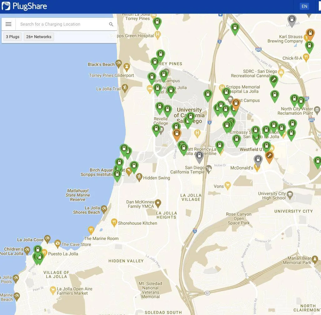

Plugshare only shows primarily 8kW chargers and no location on its own seems tp have more than 8 - usual just 1 to 3 - so not quite understanding the 46 no., unless it is for some reason 'lumping', weird (poss. lumping al the university campus units?)! Need to check for an EA station but not seeing one in this exact loc.
I would suggest looking for other EA stations in your greater area and having another go esp with PnC - your initial bad experience might (I hope!) be coloring your perspective here, so fingers crossed you get a great result at the next station you use.

In that vein, I have this map which I don't get. There are colors, boxes and ratios that make no sense to me. On my Charging App there are no EV stations in these spots. I certainly wouldn't care about gas stations. DC vs HPC? I didn't get the memo about all this. Maybe there are stations there and I need to look harder.

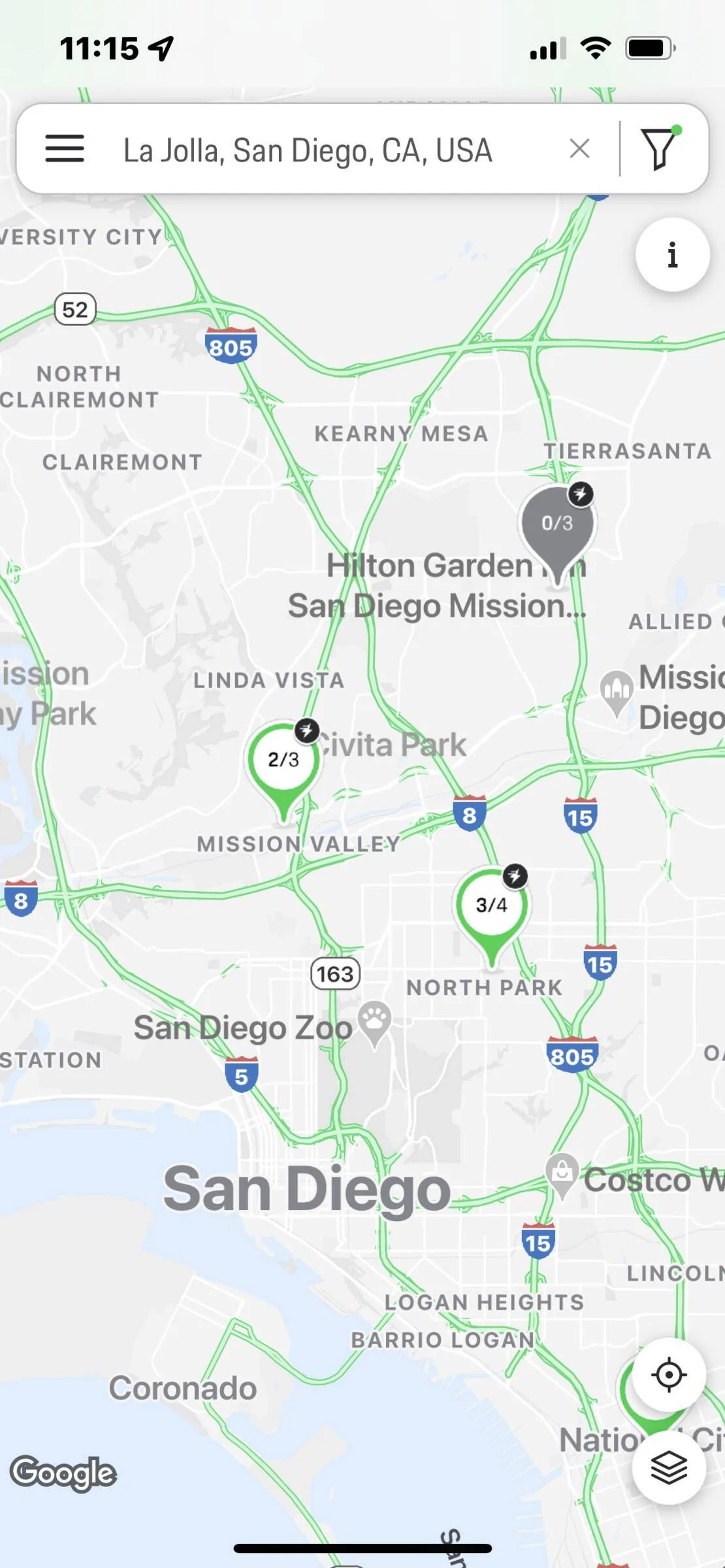

Here is the view of EA chargers near San Diego via the Charging App as an alternate to using the MyPorsche app:
Porsche Taycan Can someone decode this map for me please? 062BEE62-0093-4C28-BB4D-EFF01DE8524D

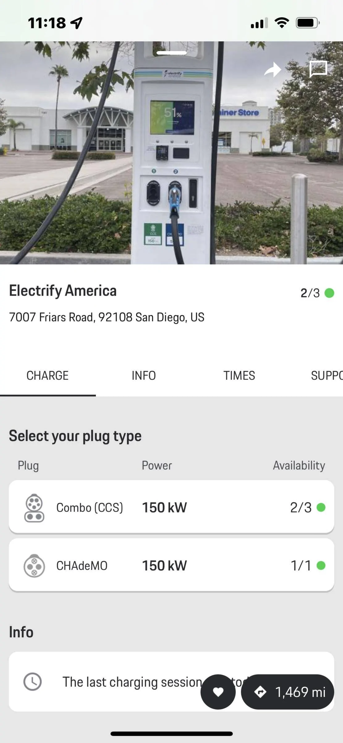

And the details of the Friars Road station right now as an example - can click the CCS label to see individual units and start a charge if not using PnC:
Porsche Taycan Can someone decode this map for me please? 000A6253-C7E6-4D81-ADAD-4D97C62AA730
Yes! Status unmonitored/status not available.
Ironically, the original screenshot you posted has all the answers you need. If you examine the availability vs installed numbers you can see how that relates to the box color. The charger category is indicated in the charger icon and doesn't relate to the box color. Dashes mean the station is not reporting. That's what I see anyway.

jay58g
Jason
Nov 29, 2022
My understanding after flicking between the Porsche app and Zap-Map is the numbers are the number of connections . So the Porsche app would say 6/6 whereas Zap-Map would say 2 devices each device has 3 connections. All being available. So a bit misleading. You might think there are 6 stations/charge points. When there’s actually 2. Shame none of this is in the handbook.
