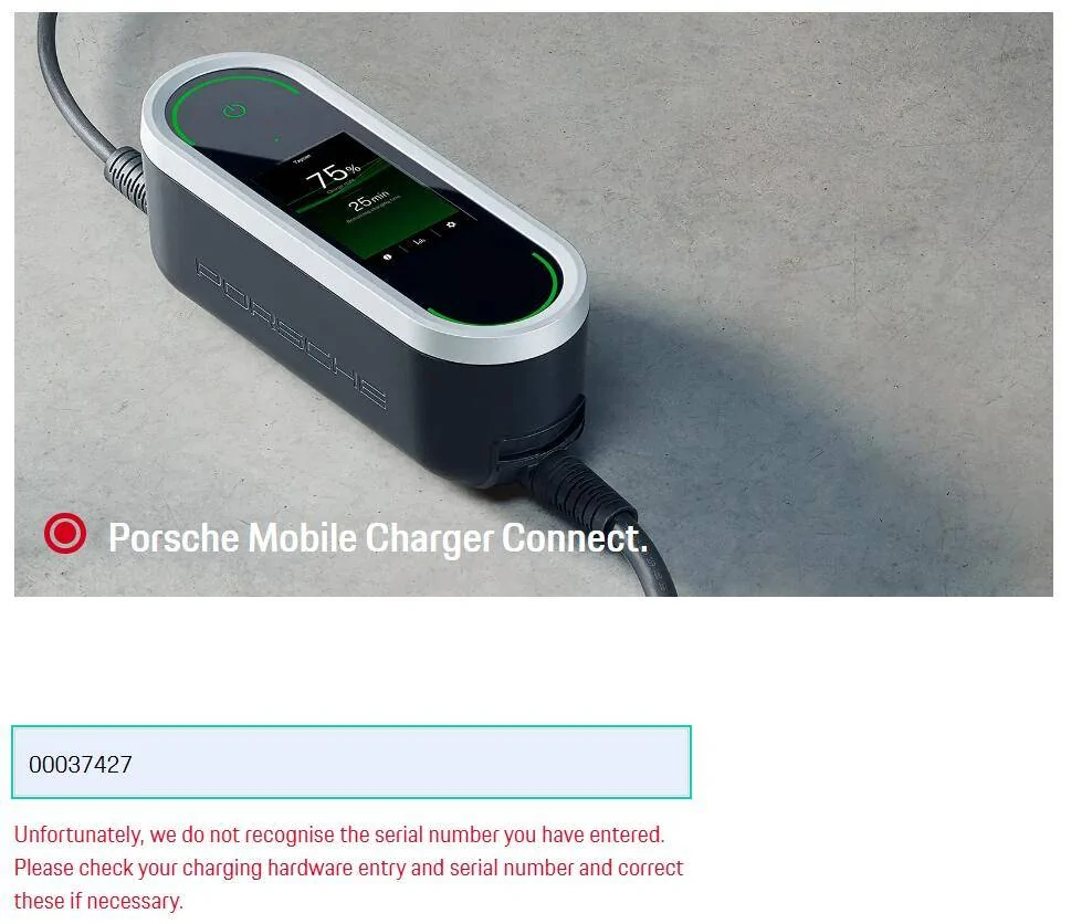

When I try to dowload updates manually. using https://contact.porsche.com/middle-east/_uae_/accessoriesandservice/porscheservice/software-update/
- it cannot find my device serial number. That could be my next problem.

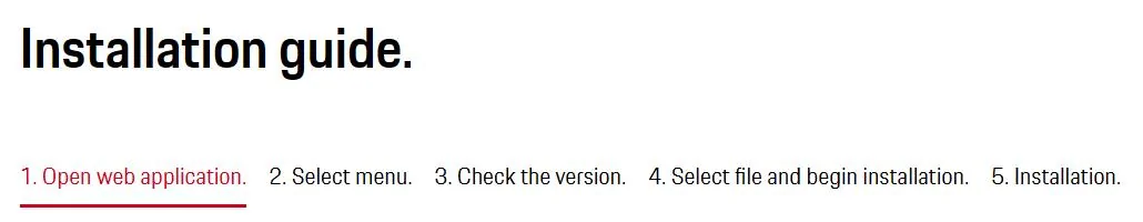

There is a feature on the browser app that allows you to do a manual install. I believe that’s what James did above. Afterwards he had ‘cloud’ connectivity and could see charging history in the Porsche app.

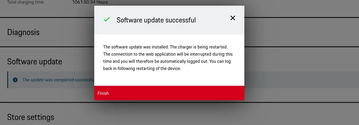

If anyone's interested or comes across this on Google, I had a read through the compiled Javascript errors on my Porsche Charger Connect when trying to update and found the issue. Previous versions of the upgrades must have been in a .bz2 zip compression, the latest one from the Porsche website is a .zip or .tar file.
To resolve, rename your downloaded file from:
update-VR_J1_15.1_2934-009.00062.004-08.09.2021_plasystemd.tar (or .zip)
to
update.bz2
Then It will update :)
Hope I don't regret the upgrade! I'll report back if I spot any differences.

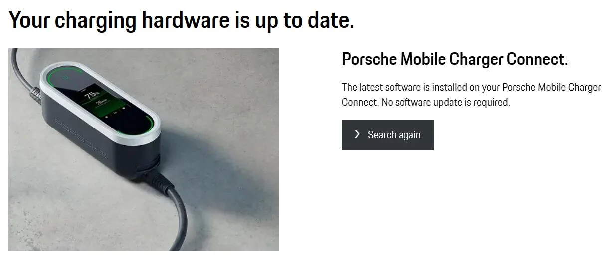

Tried https://contact.porsche.com/international/accessoriesandservice/porscheservice/software-update/ with my serial number which it recognised and confirmed mine is up to date which it is.
Porsche Taycan Can't update Mobile Porsche Charger Connect beyond version 2925 1725203455775-9m
OPs PMCC is a PMCC Model 5 - mine is Model 3. Notice that the URL confirms when I submit my serial number - https://contact.porsche.com/international/accessoriesandservice/porscheservice/software-update/downloads-mobile-charger-connect-3/
Tried with the OPs serial number - failed but then I noticed it had an extra leading zero. Applying that returned a success but no software update needed.
Feels like this tool isn't reliable or is reliable and the updates are serial number dependent.
No changelog that I can see available.

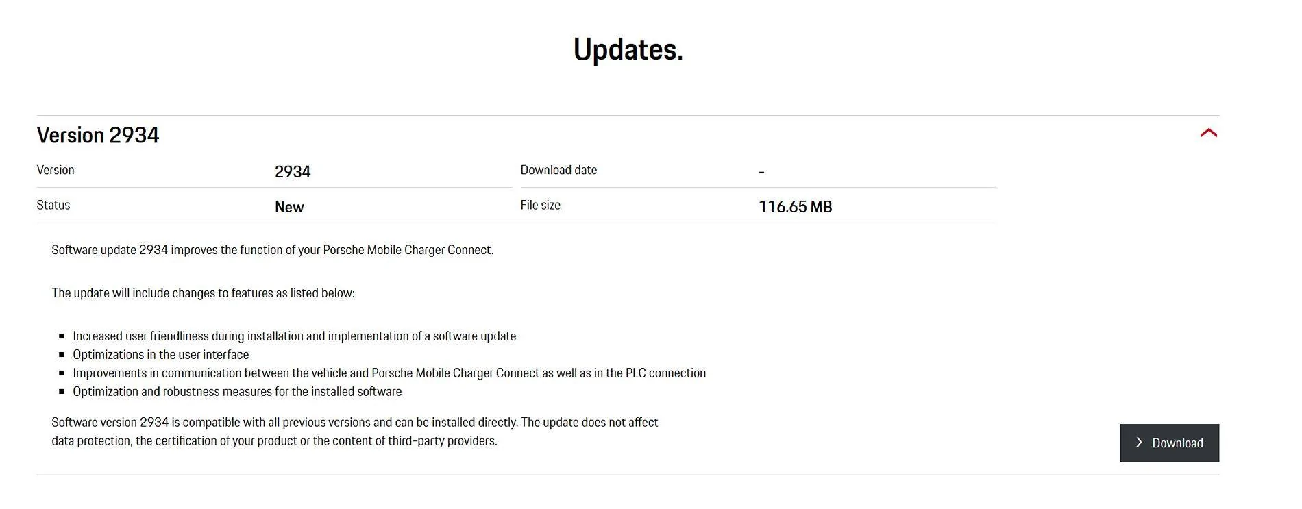

This did find my my device serial number 00037427.
It reported an update v2934 was available but also said it had already been downloaded on 13/10/23. The car was with the dealer on that day, the one that told me they had applied the update. When I tried to download it again today the result was an error ‘download link is invalid or has expired’. Hopes dashed.

8. The URL mentioned above is for UAE region and not UK - suspect this is the issue with not matching your serial number.
- Good spot. I hadn’t noticed that. I just found the download page via Google, the full URL wasn’t shown. I found and tried an international equivalent today. https://contact.porsche.com/international/accessoriesandservice/porscheservice/software-update/
9. Can you clarify the communication error you are seeing?
- The device reports a restricted operation - server authentication error rather than a communication error. It is unclear if the error handling is accurate. The PMCC says ‘no internet access available’. That could be because authentication hasn’t completed successfully, or it could be a comms error prevented the server being reached.
10. Hotspot is only for point to point access and doe not provide a 'bridge' to the internet so not a lot of use other than you can't connect to your wifi router due to range issues etc.
- I found that out the long way. When mentioning hotspot earlier I was referring to using my phone & Ipad personal hotspot to get internet access via 4/5g, but PMCC couldn’t see either.
if anyone can make the v2934 download available to me I’d be vgrateful.
I tried your SN on the website and I got the following error
Porsche Taycan Can't update Mobile Porsche Charger Connect beyond version 2925 1725265909619-7
I then dropped the first leading zero and got:
Porsche Taycan Can't update Mobile Porsche Charger Connect beyond version 2925 1725266077443-l6
I have placed a copy of the software here:
PMCC 2934
Porsche Taycan Can't update Mobile Porsche Charger Connect beyond version 2925 1725266420502-ri
