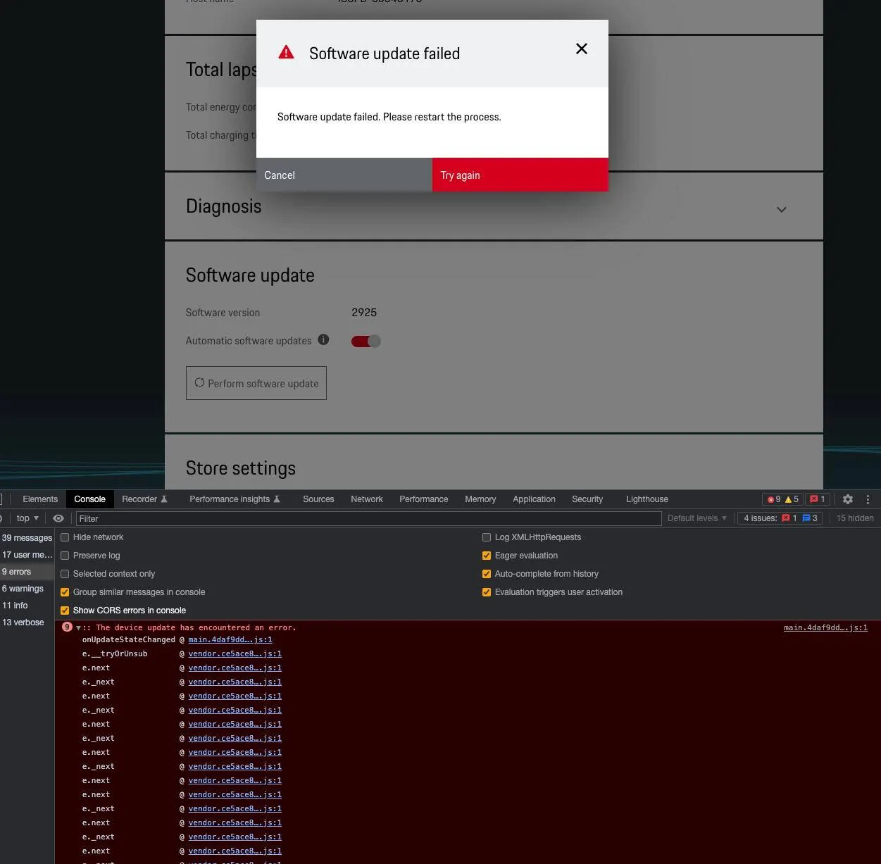

Can't update Mobile Porsche Charger Connect beyond version 2925

Porsche Taycan Can't update Mobile Porsche Charger Connect beyond version 2925 1749848325689-12
Not an option to revert to previous firmware versions. I guess my charger is wasted .. like complete useless. I can't go back to v2934 from v3031, resulting in not able to connect to "Porsche cloud". Porsche DK isn't of much help. They say: bring it in for repair. With no warranty left, this isn't an option i like. Paying hourly labour for a "simple" firmware update. No thanks.
Any one out there managed to connect to the PMCC service at port 22 (internal access methods with SSH)? It respond alright, but the 'home user' or 'customer service' login isn't of any use.

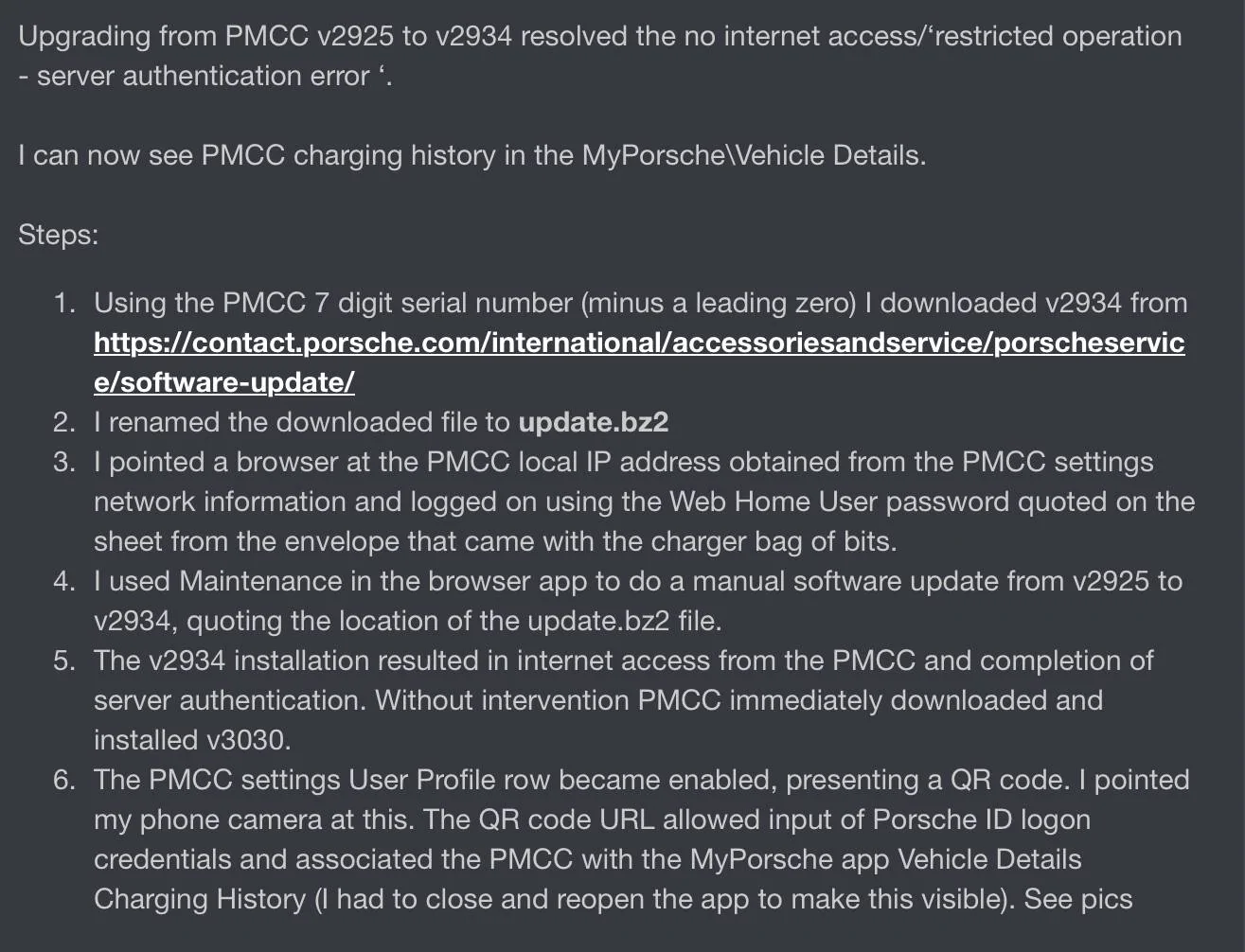

It is certainly possible. Before I was able to get internet connectivity
… I used PMCC successfully for about 15 months with no external connectivity. The only functionality that was missing was writing the PMCC charging history to a MyPorsche User Profile.

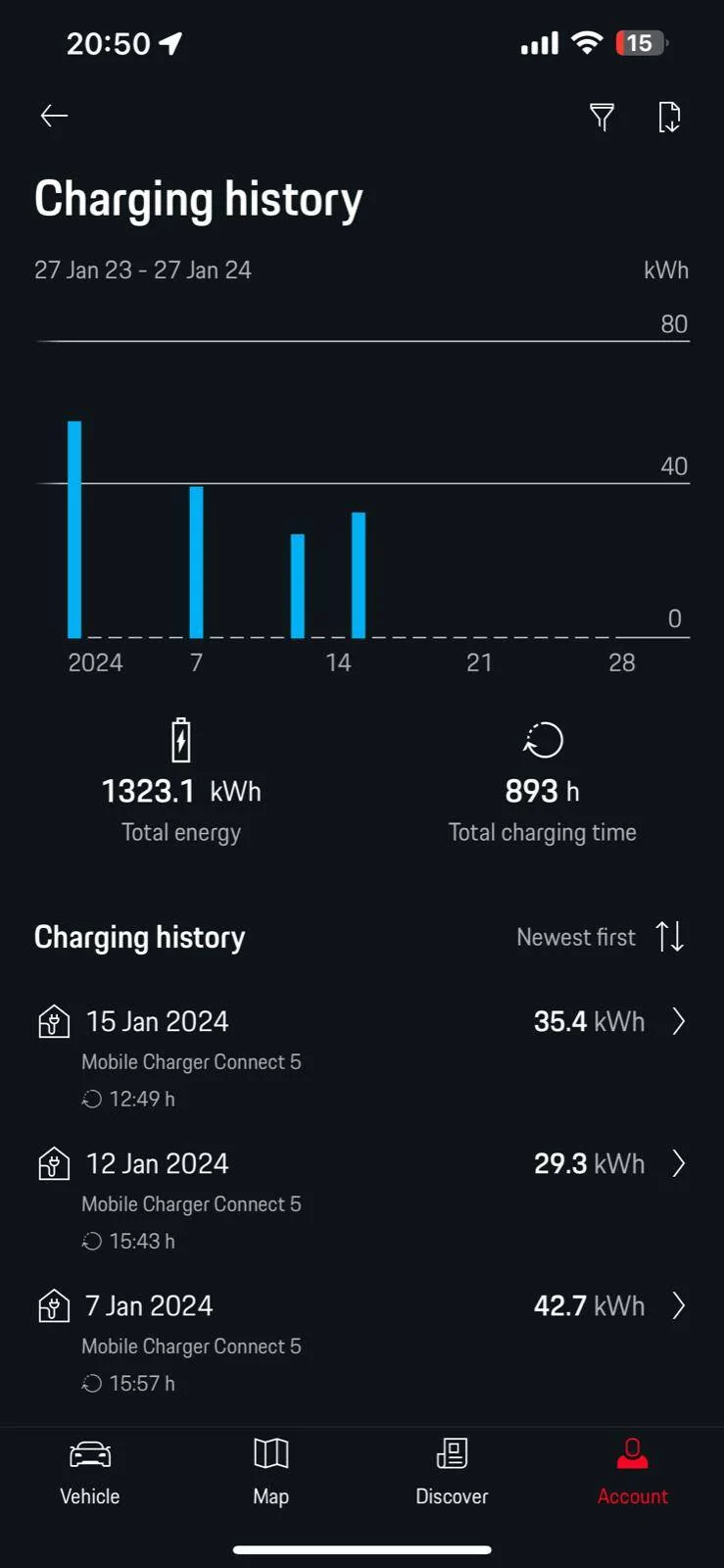

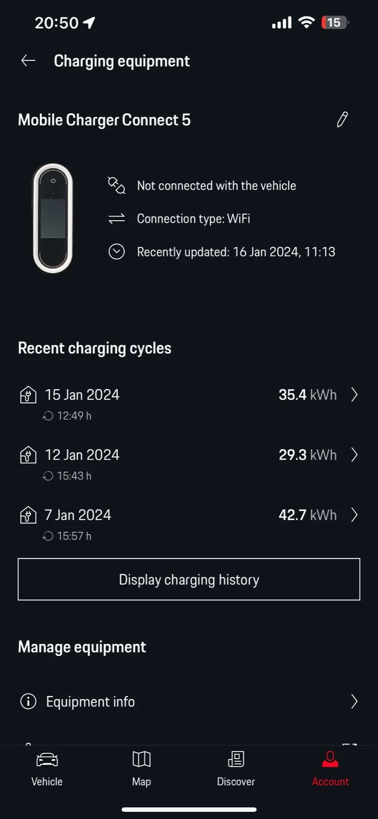

First, other than the satisfaction of not seeing authentication errors and of getting this working, being able to see charging history in the MyPorsche app is not a significantly useful gain.
Based upon size alone you can’t be certain that the updates are not cumulative?
You‘re missing v3030.
Also from my evidence, during updates, Porsche credentials are not significant.
How do your steps compare with my earlier post?
And is PLC turned off on both the device UI and the browser UI? I don’t know if that’s significant but in my case they were contradictory. Not a good sign.
Can you try going back to v2925?
